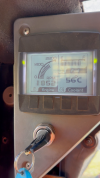

Hey guys!
Bought a pt100g skid steer recently with a forestry mulching head, it's pretty tidy but has a few errors it was throwing up occasionally. Once cycling the power a couple of times they'd usually disappear and i could keep working. (I know I should have jumped on it straight away). I'm getting Fuel sender voltage below lower limit, fan fwd solenoid fault, loss of communications between main controller and output module.
Because they all come up together i'm thinking they all must be wired in together somewhere, or maybe in a circuit and once one stuffs up it kills the rest?
I had the cab up today and noticed that the channels were full of crap and that the wiring from the fuel sender was in all of it and most likely getting pinched, this will be my first step when i get back to the machine. I'd greatly appreciate any and all suggestions on where to look next.
Thanks in advance!
