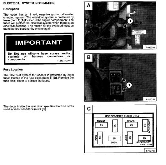

I have a 1999 751 that the headlights stopped working. I pulled apart the plastic case inside the cab to find the light switch terminal on the back side had broken off. Ordered and replaced the light switch and I still do not have lights. The only fuse I can find is in the small fuse box on the right hand side when you open the back door and it is good. I am lost, so any help would be appreciated. DMK
There should be lights and accessory fuses (2). It should be in the cab. Up top near gauges/switches or behind a waterproof cover on the bottom section (below where you step). Fuses should be able to be replaced while sitting in the seat. So sit in the seat and look for fuse holders or a waterproof cover.
On the older machines like the 751 the fuse box is in the engine bay.
