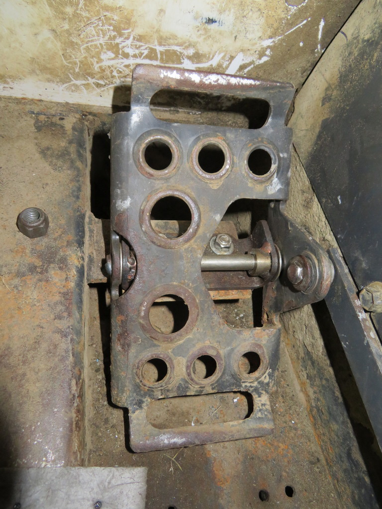

I bought a T250 and my pedals where super worn with slop. I made some SS bushings welded on both sides of the mount and used 1/2" SS rod. I welded them in thinking the heat would create binding and it did so a 17/16" drilled over size on the bushings did the trick. Pedals have no slope and should never rust or ware out for decades.
