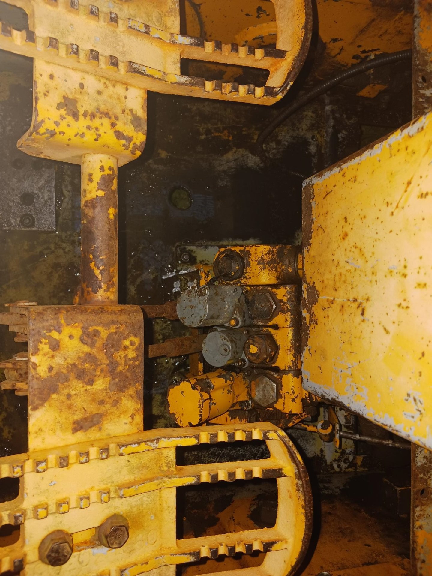

The problems so far that i see is the
fuel injection pump is leaking so ordered a
new one got it today. Second thing is a fluid leak maybe o-ring on the back end of the control valve.
I will post a picture of the valve in hopes the some one can tell me the make of it an tell me where to get a repair kit.
I've got a lot more questions. Thanks for any IMF control valve.jpg.
U bought yourself a work horse, it is old but can still be a very reliable loader
on that spool valve they used different kits for each spool not sure which section u need to rebuild
if u have a gehl or mustang dealer they can fix u up most parts are still available
Thanks for the help. I think it is the forward control valve. The fuel injection pump is leaking. I got a new one.
