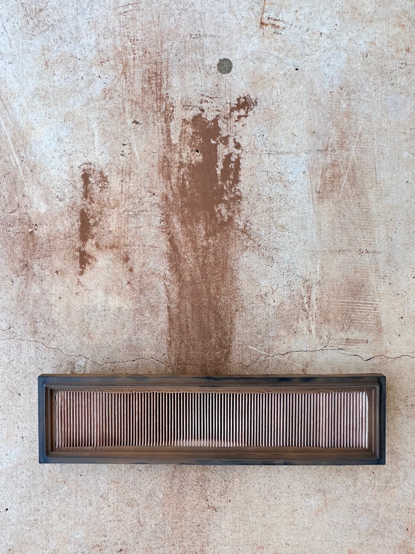

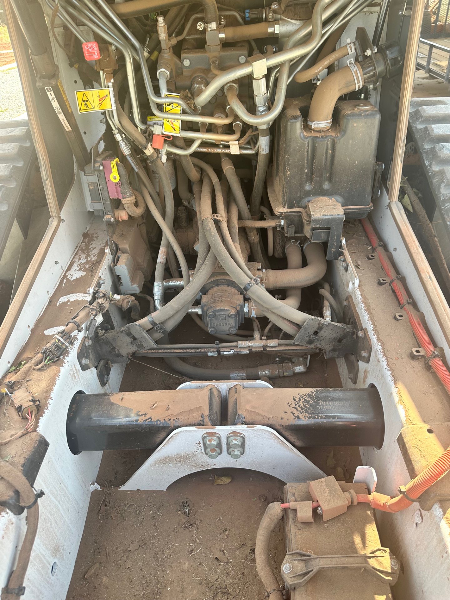

Are any other Bobcat R-series owners having issues with dust and dirt as follows:
1) Under cab, dust and dirt covering most horizontal flat surfaces. Dust and dirt building up to 1-1/2" deep on floor pan; after only a few days of being cleaned and partial day usage.
2) Primary engine air filter requiring cleaning every few hours of use.
3) Exterior cab air filter requiring cleaning at twice a day, sometimes three times.
4) Interior cab air filter requiring cleaning daily or every other day.
5) Air plenum behind interior cab air filter randomly filling up with water. Even though drain flapper is not plugged. Shutting off A/C fan allows water to drain. Water splashing on to filter causing severe air restriction (aka minimal cab cooling).
6) Interior of cab being infiltrated with dust. Needing to be blown out with Leaf-blower.
7) A/C air vents showing dust build-up. Dust accumulating behind digital touch display and overhead panels on either side at front.

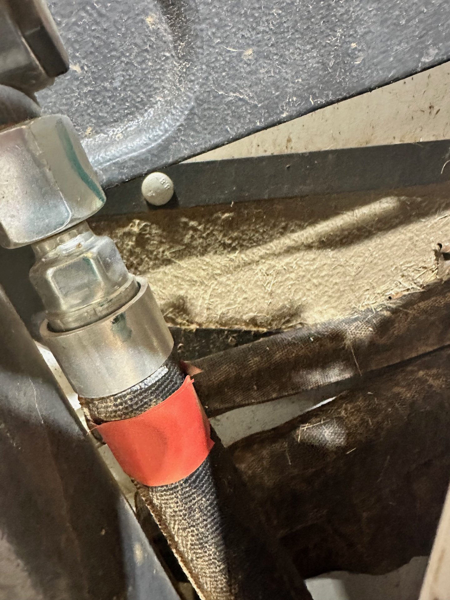

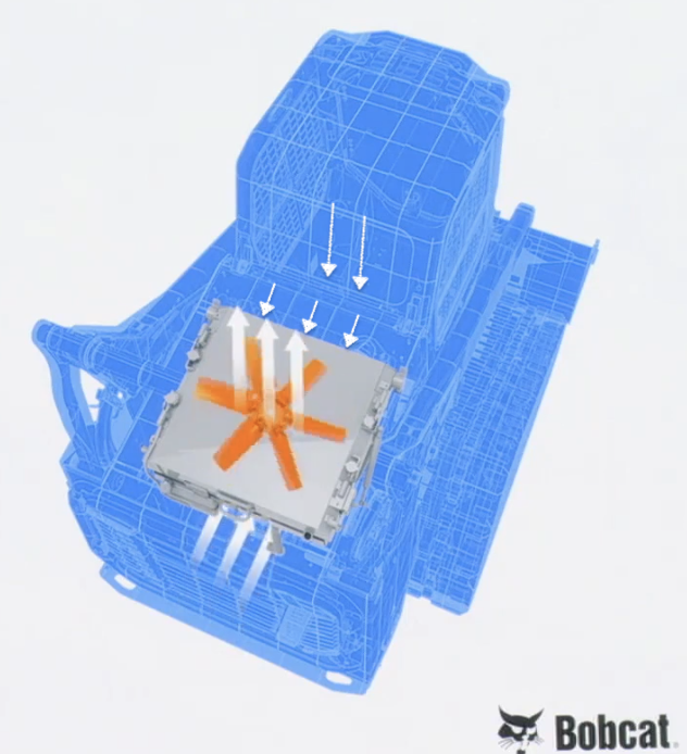

R-series cab is supposed to be independent box (or chamber); unlike old M-series which semi-sealed against chassis (or frame). Which has me puzzled as to how so much dust is getting into cab.
R-series appears to have better sealing where hydraulic hoses for track motors go thru chassis. Leading to puzzle of, how dust and dirt are entering and building up as quickly and abundantly.
