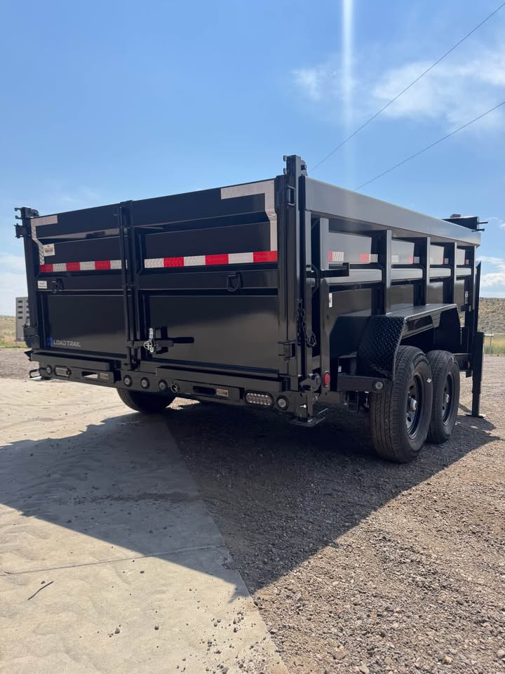

I am in the beginning phase of starting my skid steer business. I plan to offer everything from land clearing, debris removal, field mowing, material delivery, farm/agricultural work etc. I bought the truck last week and I'm getting ready to buy the dump trailer. I would appreciate any options/advice on the style of dump trailer. I am getting a 7x14 gooseneck. What I'm debating is the wall height. I don't know if I really need a high side or not. I am looking at one with 3' walls (pictured) and I think that would be sufficient. Would love to hear your opinions. Thanks.

Thanks for the feedback. I don't need a CDL in Colorado unless total weight is 26000 lbs or more. The skid will fit in this trailer, it has tie downs for the chains, and stake pockets for higher walls if need. I think this trailer will work great for my needs. I'm really just wondering if anyone got a 2' or 3' trailer and regretted not getting the high side.

I'll probably go 3' sides and add wooden walls if needed. The skids I'm looking at will all fit in a 7x14' trailer (S650/S590 etc). This is a post military retirement business, no employees, no other equipment, based from home. Equipment housed in a barn on our property etc. I will only be doing jobs I can do with the skid and the 14' trailer etc. Thanks again for the advice.
