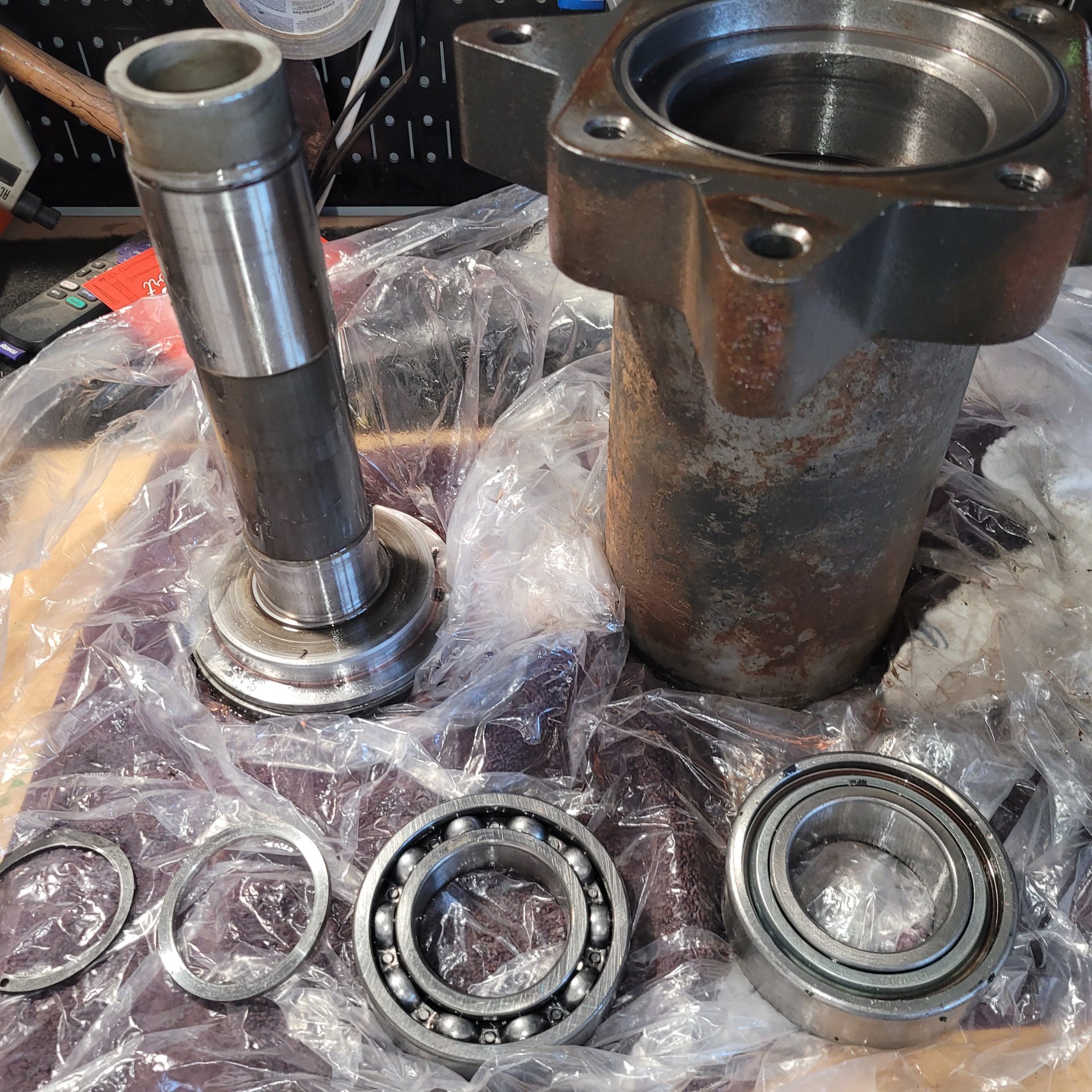

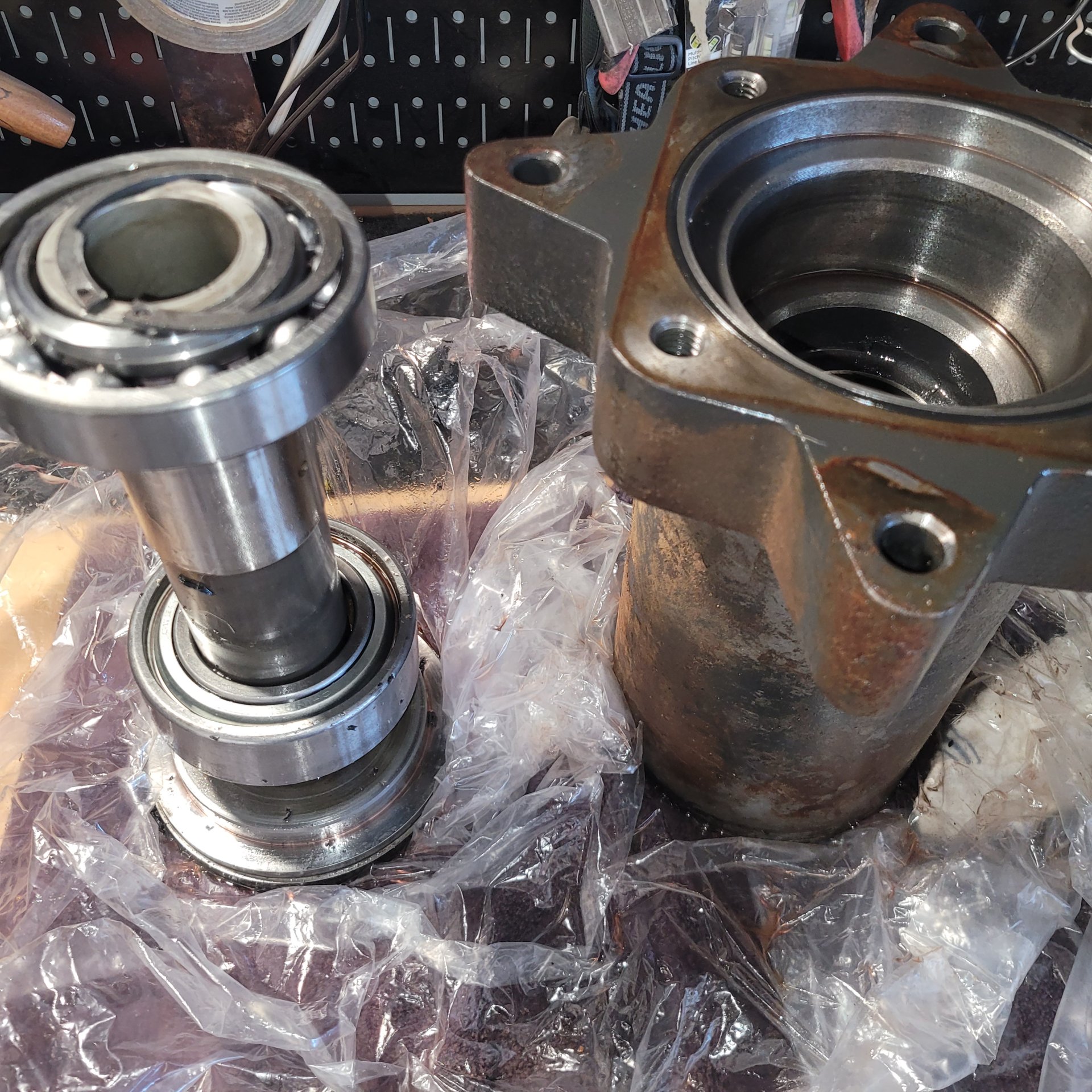

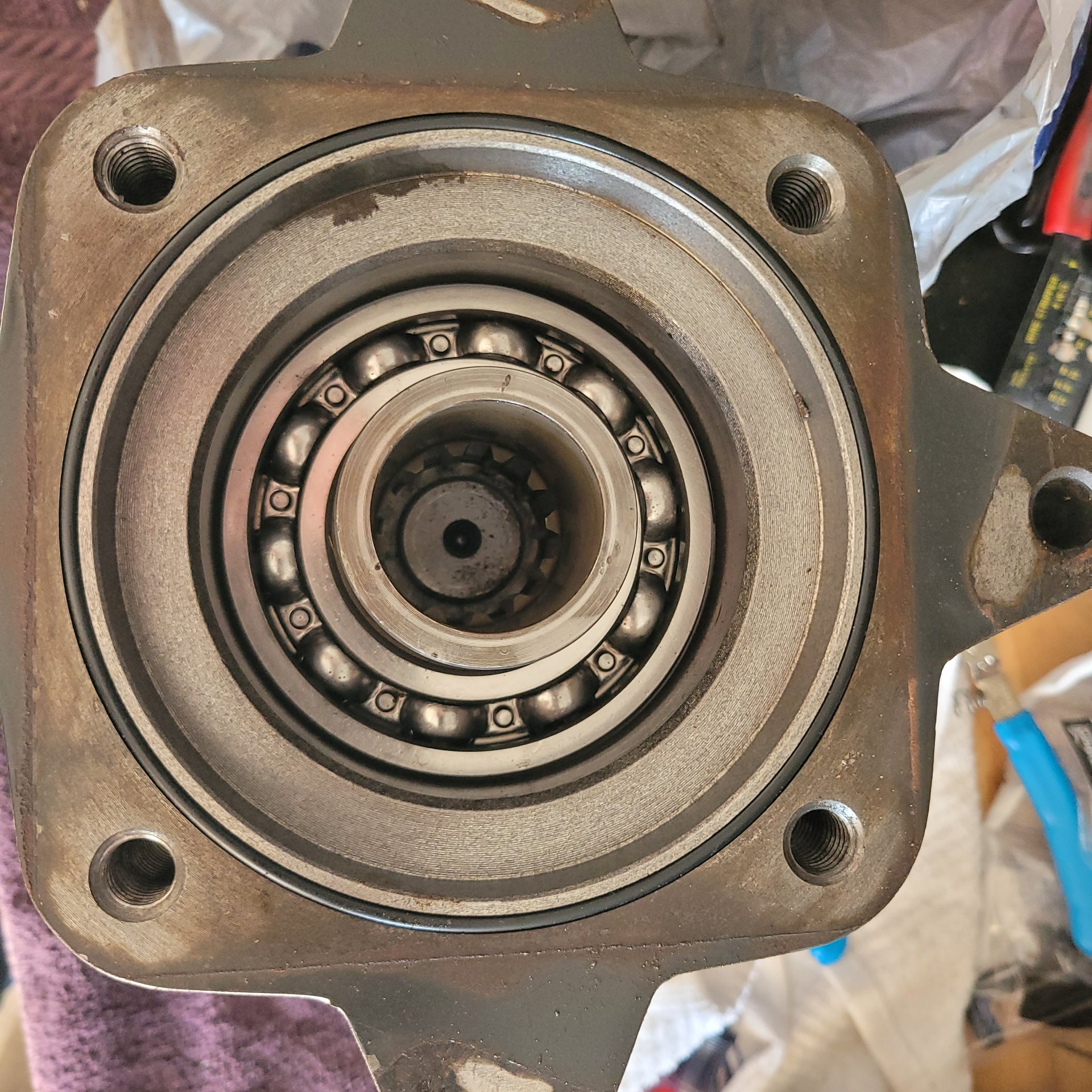

Thank you much for that detail. I managed to get the housing off the trencher and last night disassembled it. Ran into couple challenges with disassembly of the bearing carrier housing. 1st the snap ring #35; Once I got a larger pair of snap ring pliers, I got that off. 2nd challenge was getting the shaft out of the housing. Was not sure if needed a press or not but couple taps with large enough hammer, over round socket on shaft, managed to loosen that free allowing access to all the seals. There were rubber shreds inside the housing which I am assuming were the dust seal as it was not there in one piece.
Similar with your scenario, the bearings appear good so will not replace. Thanks again for your help. Adding some images for reference in case someone else finds them helpful.
