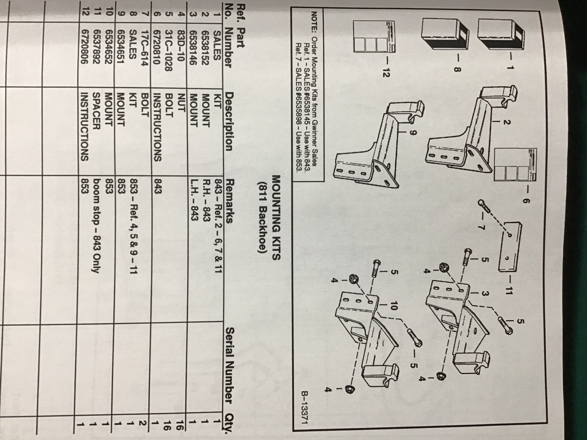

I thought I might have an old advertisement photo, but no luck. I included a photo of the mounting kit parts schematic just because it may help.
I do have the entire 24 page parts catalog for the 811 backhoe. If you want I could take photos of it and post it.
On that note, I have the “bobcat 800 ATTACHMENTS PARTS MANUAL” that covers all of the attachments for the 800 series skid steers from that time (1993).

Thanks for the offer. I may take you up on that if I end up going down that road. If you notice any good diagrams showing it mounted and really where the hooks are located and how they fit between the tires and lift arms - that could be helpful to see. Every bit helps - I appreciate it!

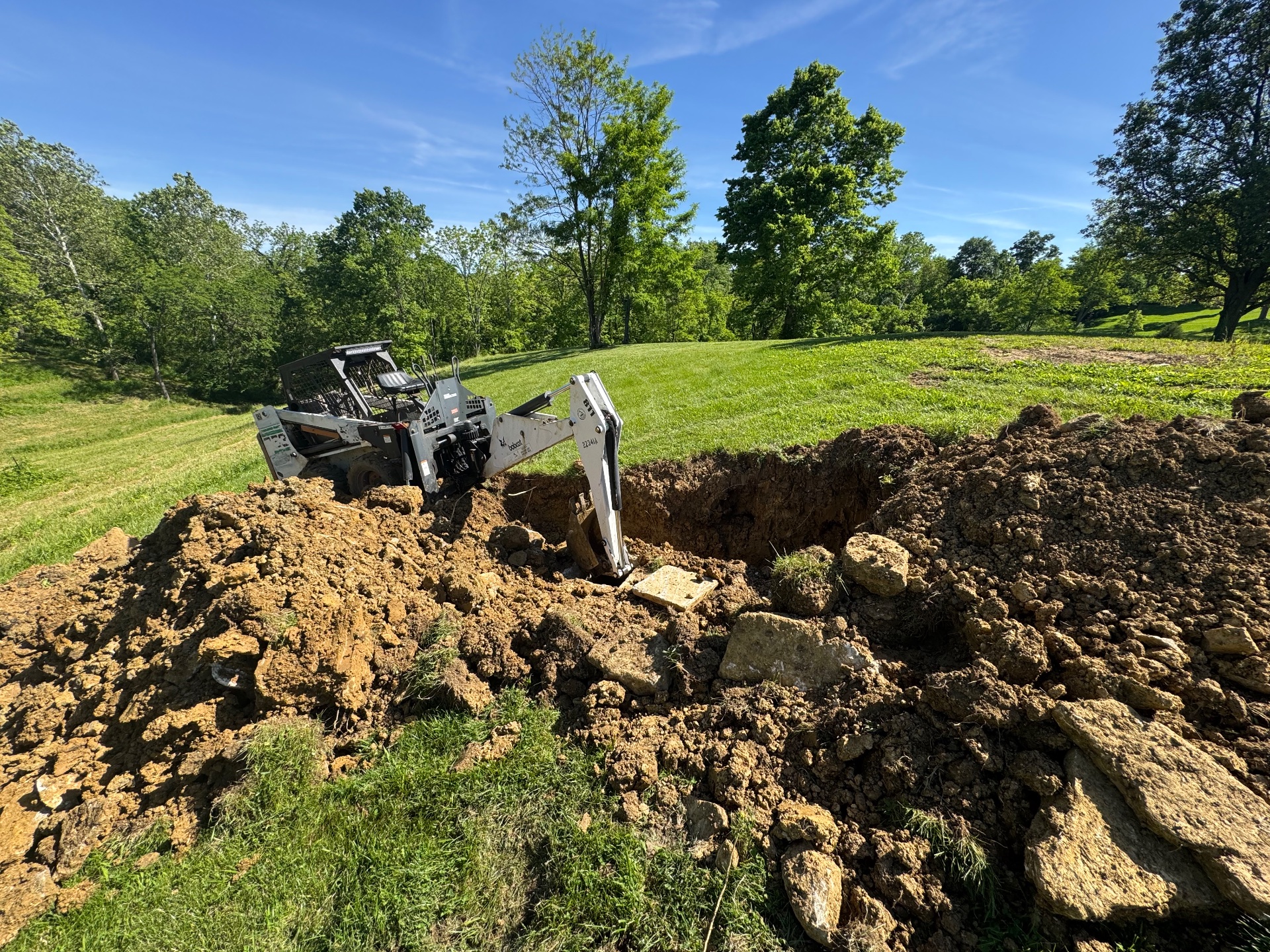

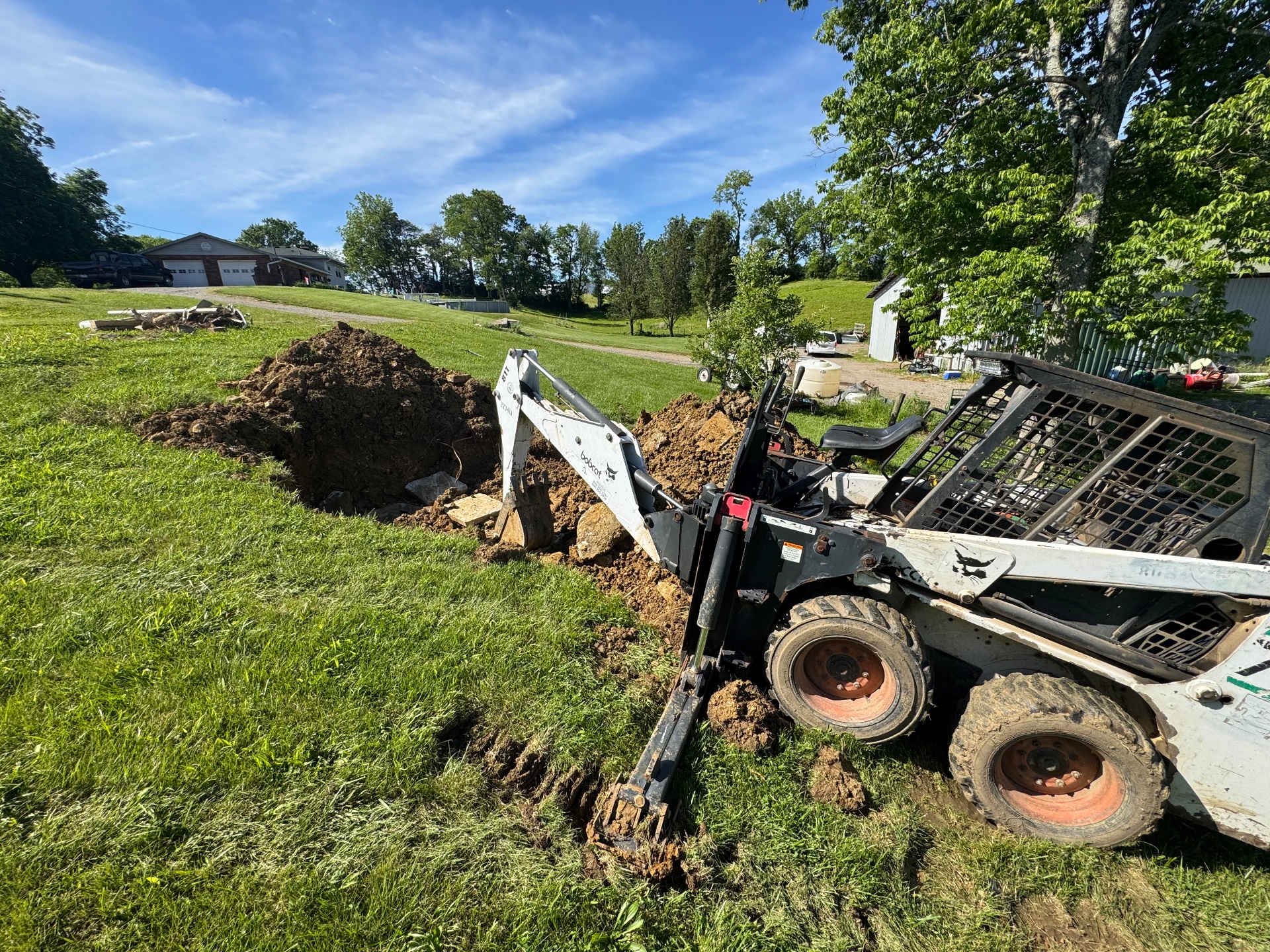

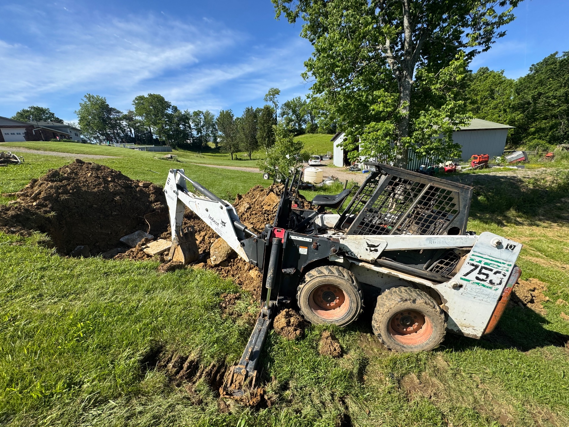

Here are some of an 811 on my 753. Yes it is too big but it digs way better than the 709 I have. Both attach with the hook style mount. I believe it is the same as your 843

Hey thanks - that helps a lot - especially knowing you have a 709 too. So you can actually mount either the 811 and 709 on your same hooks the way you have it? So the spread of the arms of the backhoe (part with the hook pins) must be the same then, and the setback or reach from the tach must be the same too then. That's interesting to hear. I'd love to get a 811 or 911 even, but they are so much more uncommon around me.

That could work out well - if they have part numbers on them you can read I believe the 843 needs these two bracket part numbers:
6538152
6538146
