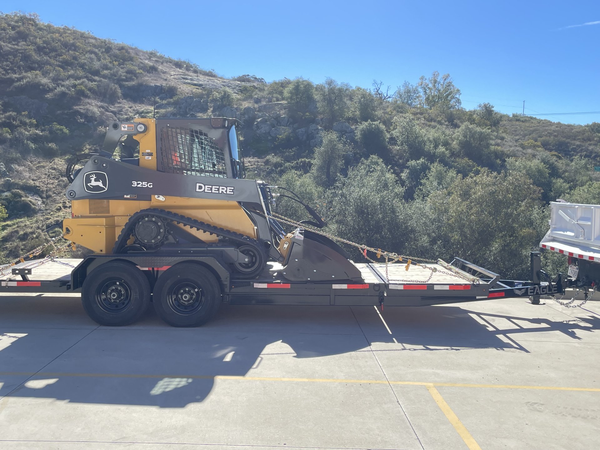

Hello. My first post here after recently purchasing a 325G. I have a whopping 10 hrs in a skid steer so all inputs and recommendations are much appreciated. Do you recommend diesel fuel additive? YANMAR does not advise the use of any fuel additives https://www.yanmar.com/marine/faq/can-i-use-fuel-additives/ Thanks in advance for your feedback. 325G.jpg
