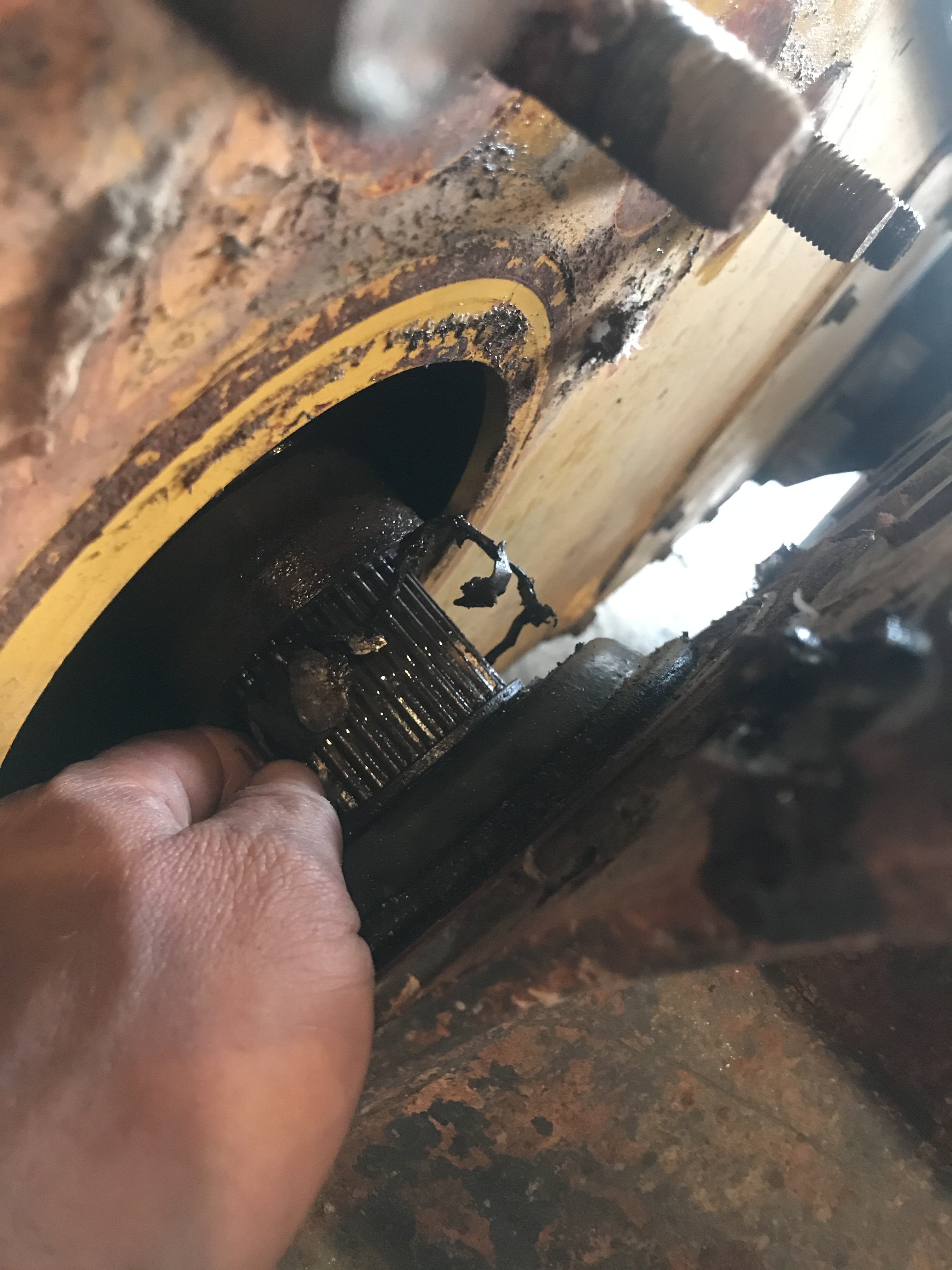

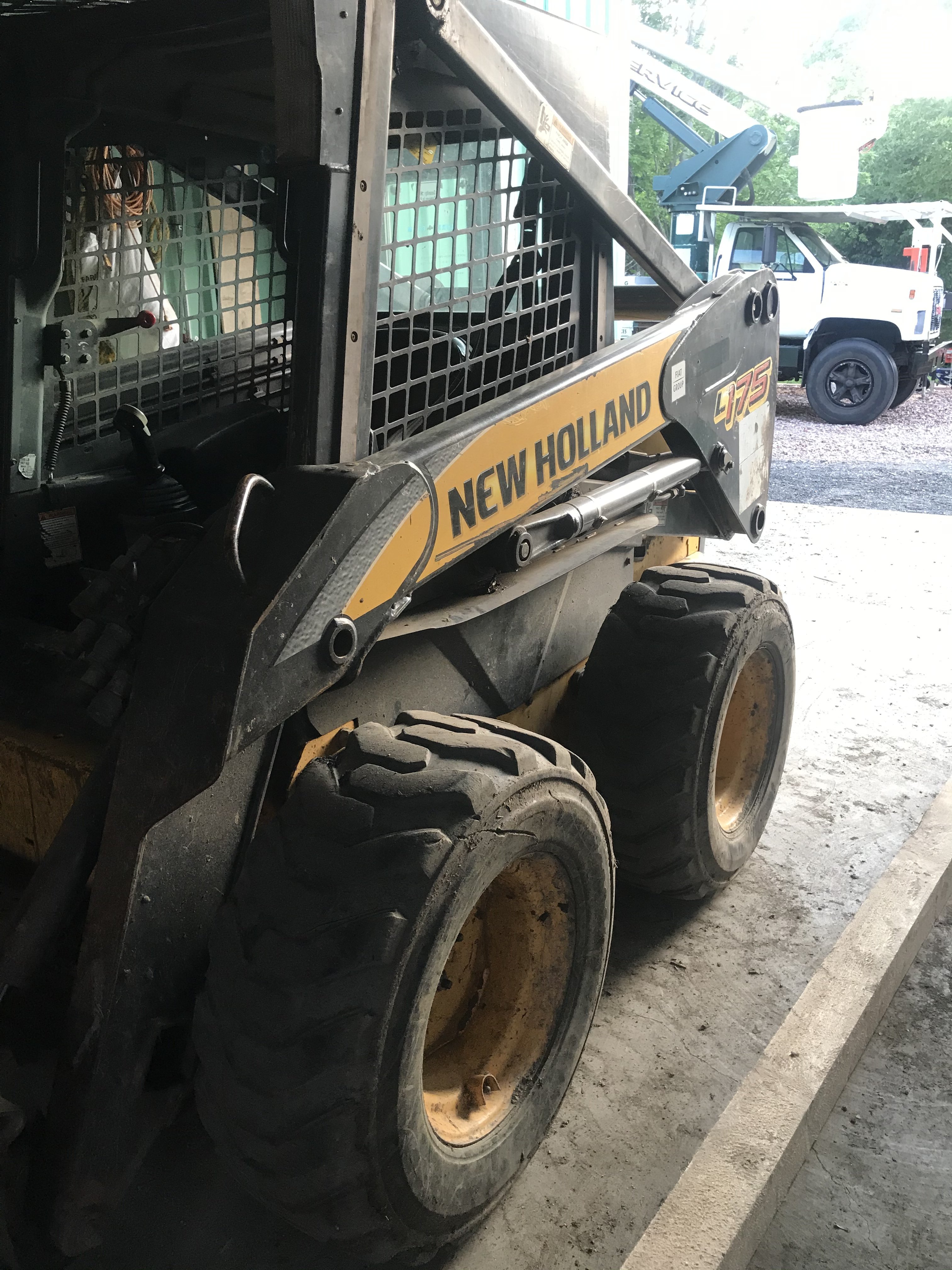

Hello I have a cracking noise coming from my L175 new holland skid steer. Sounds like it’s coming from the front axel. Could be coming from the gear box as well. Only happens when the skid steer is in motion and a minute or so after start up. I heard some noise coming from that area a few weeks ago but its really starting to get worst. I changed the gear oil and pumped grease into the grease fitting on the wheel hub for the first time owning the machine today. Never knew there was a grease fitting in the back of the tire. Seemed to make no difference. Ive owned the machine for 7 years and used it very little. Mostly farm use moving hay bales and cleaning the barn. Any thoughts would be greatly appreciated.
    1.8 MB

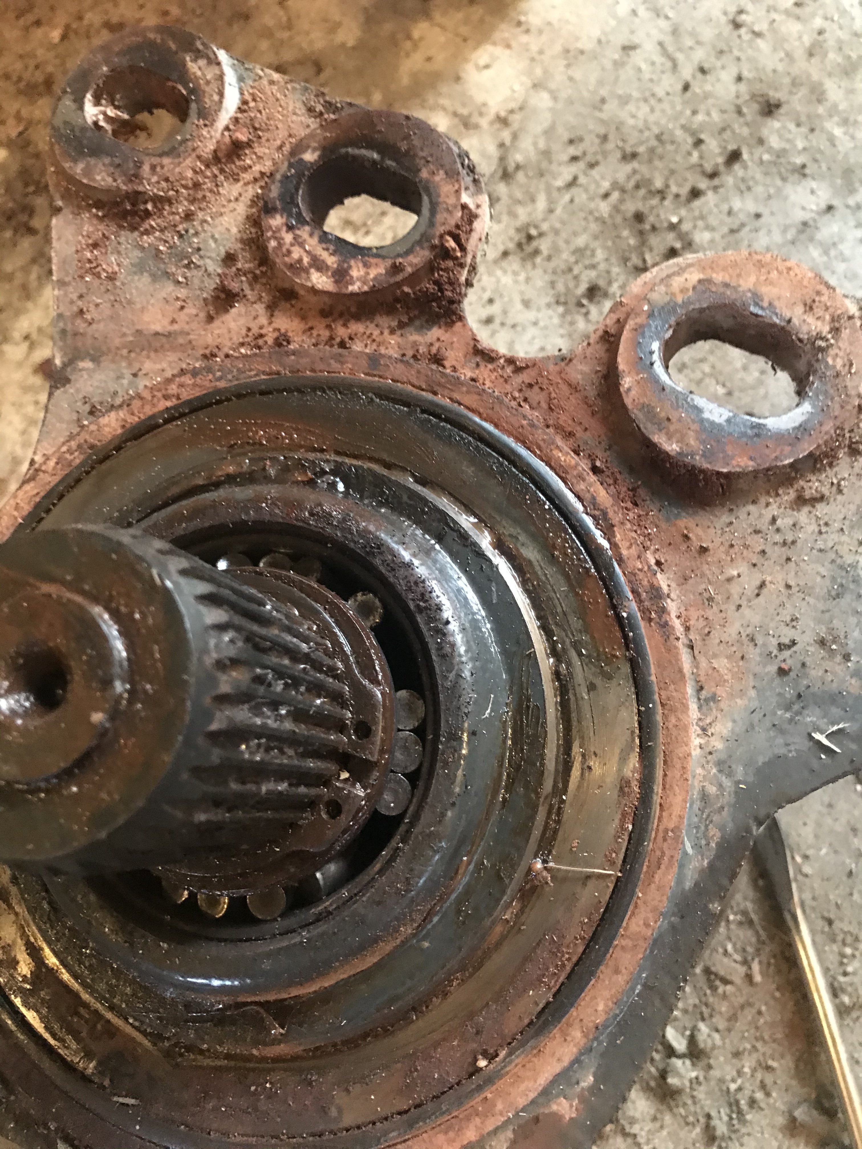

Just took the axel off looks to be a bad bearing.
