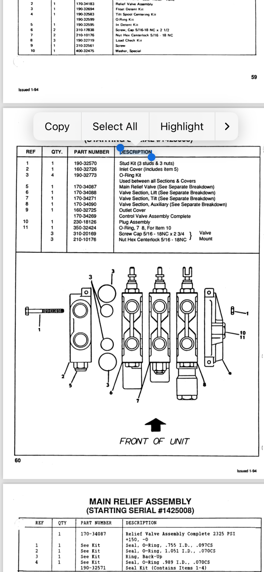

Control valve mustang 940
    663.2 KB
I'm sure u could match them up, but i think the kit is still available & reasonably priced, i would probably go that route
if im taking the time to remove the valve, that way u can be sure it wont leak
