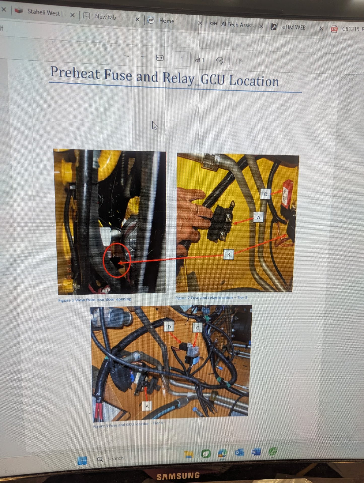

Update - I made the purchase . Now I am troubleshooting, I have made some videos (see link) of my progress and diagnostics. frustrated with factory service manuals that don't match up to my fuse layout,, and the wiring diagrams of the loom are not matching up. I have a 2017 New holland C232 serial# NHM431134 .
I have started with the basics. fresh Battery at full charge and load tested. all fuses and relays checked. Same crank no start, Same codes..(see notes)...codes 1905 ,1906 - for bad 5V reference voltage are suggesting bad source voltage or grounds. I have factory service manuals from 2011 and 2018 as well as a electrical from 2015 (no wiring diagrams). Nothing from the service manuals matches the fuse/relay layouts or wiring diagrams. Major stumbling block is what appears to be a bussman fuse cover and what might be the mount. It has bare lug and and i found a small wire with apparent connector broken off. See linked media files...
If anyone could shed some insight on this , I would dance the happy dance as I am at a loss for any direction at this moment. https://photos.app.goo.gl/CQn84erFYbGhPmW19
Update ; I have been researching and found out (with the help of a dealer NH tech) that the fuse location is for (an optional) Preheat function as a cold weather package.
I am still working on resolving the codes and will be following suggestions about connector locations under the cab with a history of open terminal locations due to wiring harness stress failures.
