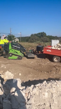

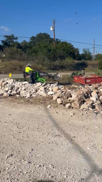

Hey, all. I have the DRT450, with the Honda GX690 no issues with the engine. The tracks that came with it needed to be replaced at 200 ish hours. These minis skids come with real cheep tracks, to keep the tracks on and make the all the rollers and drive last longer go with a K series heavy duty track. I now have 60 hours on the new track with no issues. Heavy use in rocky areas.
