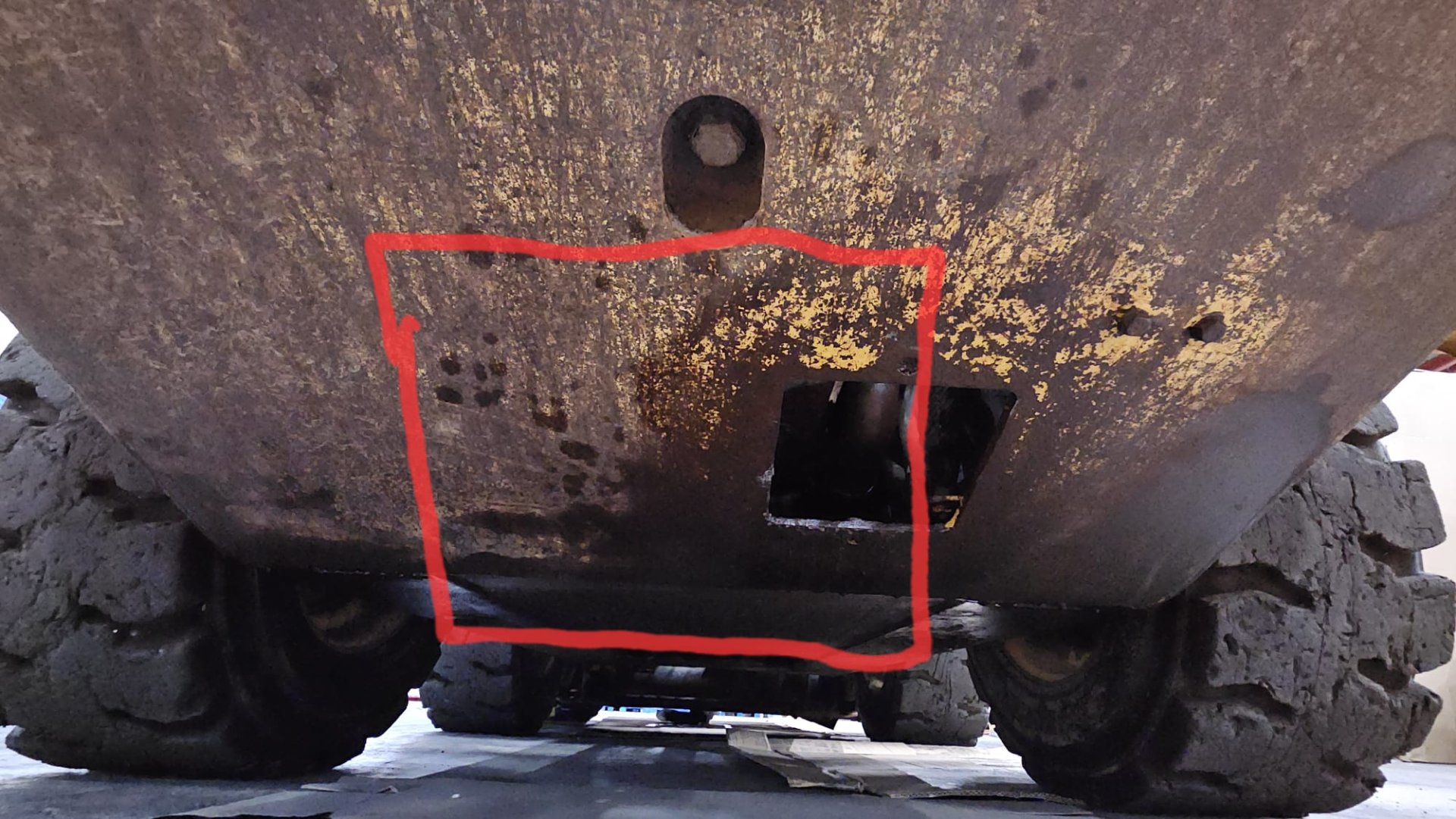

Thinking to cut here and weld back after. Way simpler than removing the engine in my opinion.
Have heard this story a million times, good luck
Cutting and welding might seem like a shortcut, but it can introduce new complications like misalignment or future structural weaknesses. If space is tight, I'd recommend following the proper removal procedure—removing the engine, even if it's time-consuming. It ensures you don't run into more issues down the road
