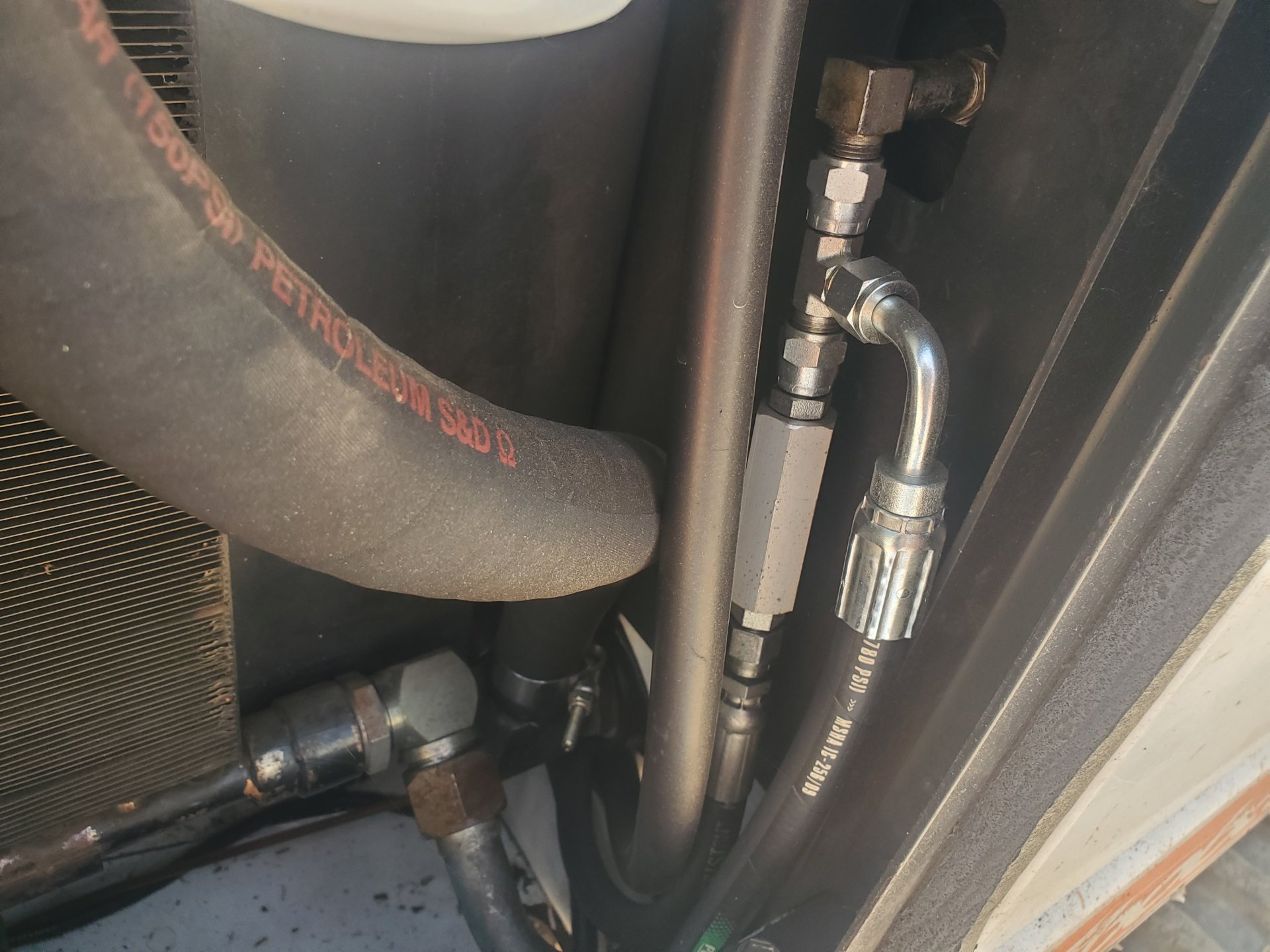

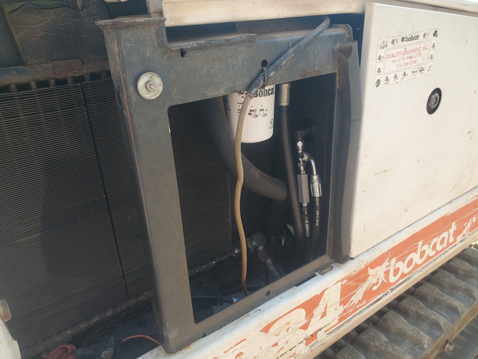

I figured the case drain out. I tapped into the final drives case drain just above the filter that returns to the tank.

case drain filter already exits on unit (keep in mind im old) , have to remove floor board,? been abit, why not just look up parts break down,
