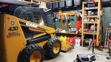

So I'm revamping a skid steer, she's in relatively good shape, only 1000 hours....
The question is, on the left side of the cab, on the pillar opposite to the ignition side, there are quite a few empty switch caps. Removing the pillar cover revealed a ton of hanging connectors. I do have the service manual, but it's extensive, anyone know offhand what all those connectors would potentially run? It's pretty much impossible to just trace the wires without pulling the interior (and I did try).
As well, any ideas on the heat/air and blower not working? I have confirmed that the valve is open on the line in the battery compartment, and all the fuses are intact, the only thing I can think of is there are quite a few relay plugs missing (G8V-RH-1C7T-R-DC12 35A DC12V), so I've got a few on order. Possibly they are for options I don't have.
Just getting to know the new buggy. I had a bobcat but sold it to 'upgrade' to this one, and so far I really prefer it. The interior had a lot of mouse damage, and hornets had really taken over the place, but it cleaned up really nice, and a few days with an ozonator in the cab took care of the smell (well that and a shop vac mouse sucker). Quite happy with it overall. Just hoping someone is familiar with them and might have some ideas.
