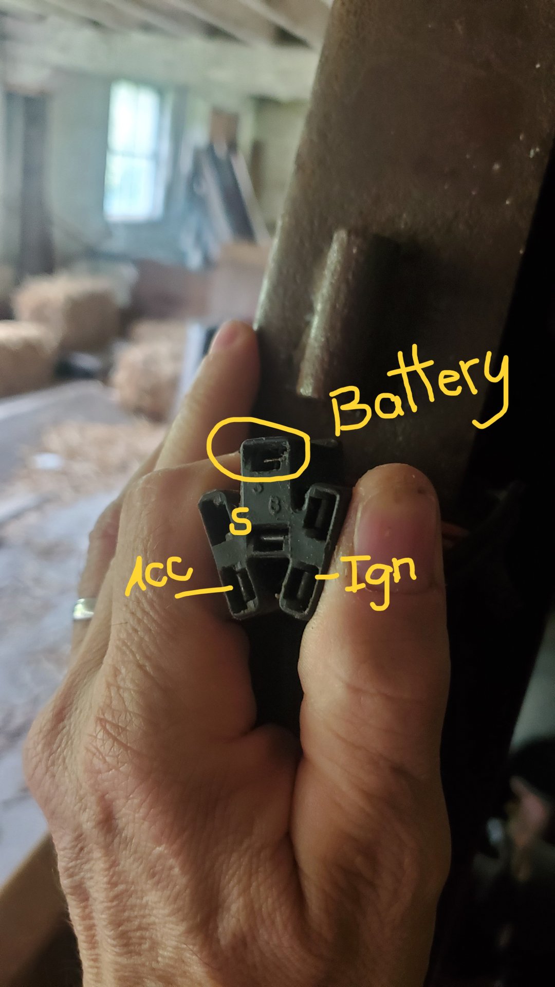

My Case 1845B sat for a couple years while I fixed hydraulics. Now its dead when I try to start it. I hear nothing when I turn the key.
Here is what I've tried.
1. Battery giving out 12v+
2. Selenoid tests good according to online instructions.
3. Switch tests good continuity where it should.
4. Cables from battery to selenoid have been cleaned and are tight.
5. Not sure how/where seat switch should be connected or if it exists. Don't see anything attached to the seat. Tried connecting two wires, see pic. (1)
I put a voltmeter on the ignition switch battery connection and don't get anything there. I should, shouldn't I?
I don't know what any of the wires under the seat are for or where they should be connected.

No noise whatsoever. I'll check, but shouldn't there be voltage at the battery wire for the switch? Nothing on that switch plug has voltage.

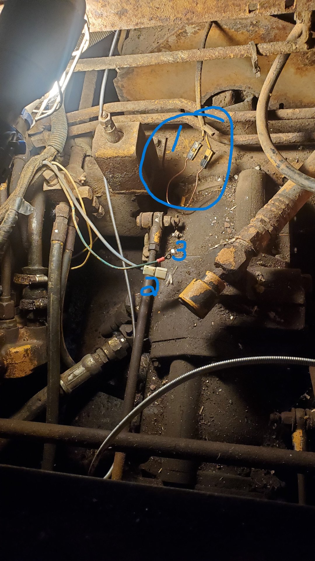

Second picture, item #1 that you have circled look like the harness and connectors that connect to the air filter restriction sensor.
I have never laid eyes on an 1845B, but going off your pictures it looks a lot like an 1835B. The 1835B has a major harness connector kind off the the right of the front of the engine. If your battery is not the problem I would check that connector if it exists. Also, I do believe the 1845B used the same 188D engine that the 1835B used, and I have noted that it is a common problem on the 188D equipped 1835Bs that there is too much voltage drop from the battery - to the instrument panel and key - and back to the starter solenoid to pull the starter solenoid in. Even with a fairly healthy battery it is possible to be below 8V at the solenoid with the key in the crank position and at some point the voltage isn’t high enough to pull the coil in. If that problem exists, there will be no solenoid click when the key is turned to “crank”.
I have never laid eyes on an 1845B, but going off your pictures it looks a lot like an 1835B. The 1835B has a major harness connector kind off the the right of the front of the engine. If your battery is not the problem I would check that connector if it exists. Also, I do believe the 1845B used the same 188D engine that the 1835B used, and I have noted that it is a common problem on the 188D equipped 1835Bs that there is too much voltage drop from the battery - to the instrument panel and key - and back to the starter solenoid to pull the starter solenoid in. Even with a fairly healthy battery it is possible to be below 8V at the solenoid with the key in the crank position and at some point the voltage isn't high enough to pull the coil in. If that problem exists, there will be no solenoid click when the key is turned to "crank".
I'm confused by having no voltage at the ignition switch. Even if the battery is bad, wouldn't I get some voltage there?
