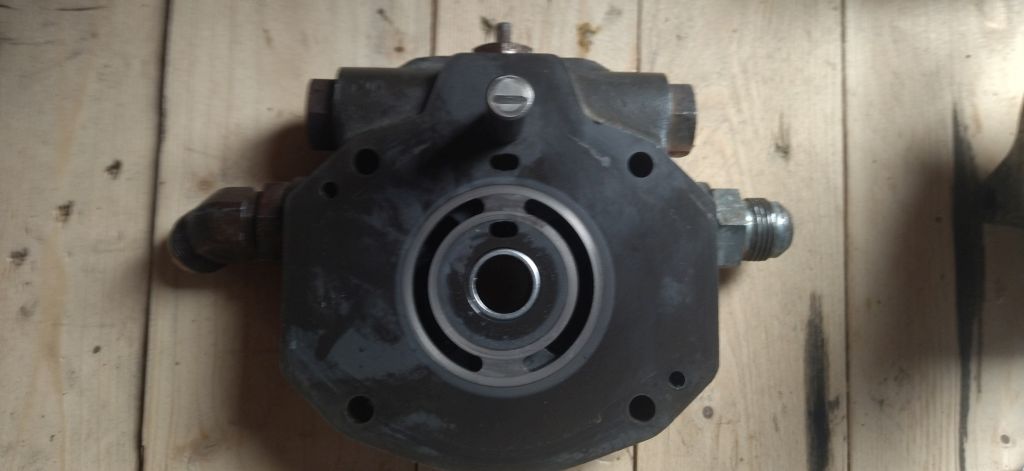

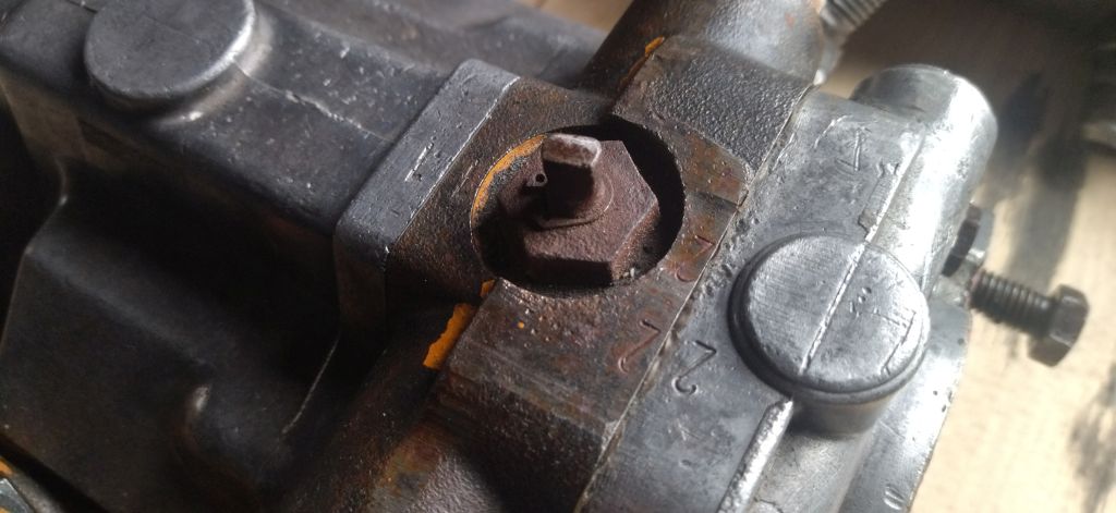

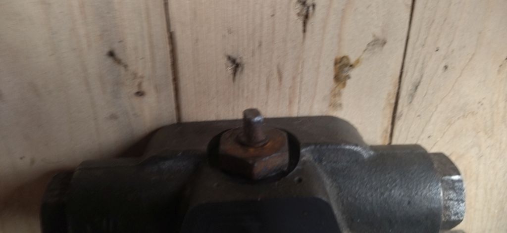

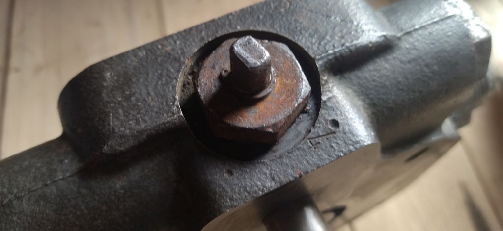

I got the pump welded. I want to put it together again, but have a question about a valve on the pump.
Could you advise me whats it responsible for and what position it should be in? Thanks !
