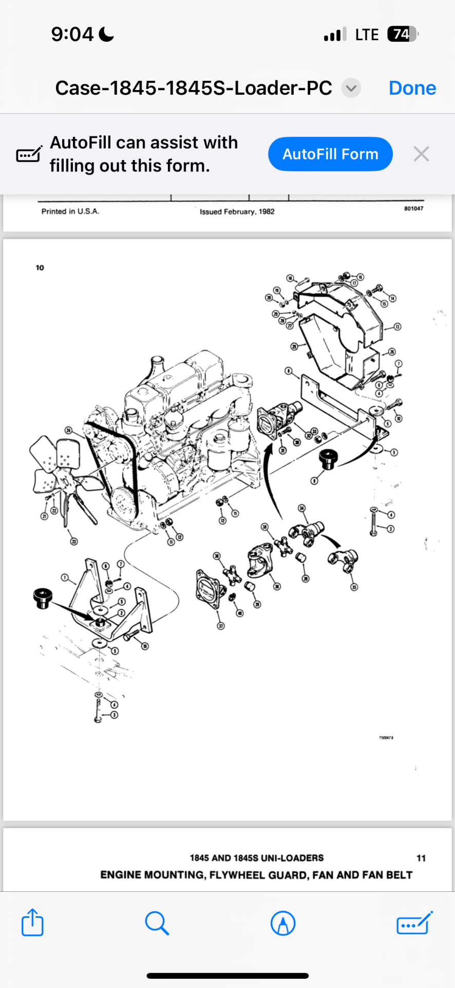

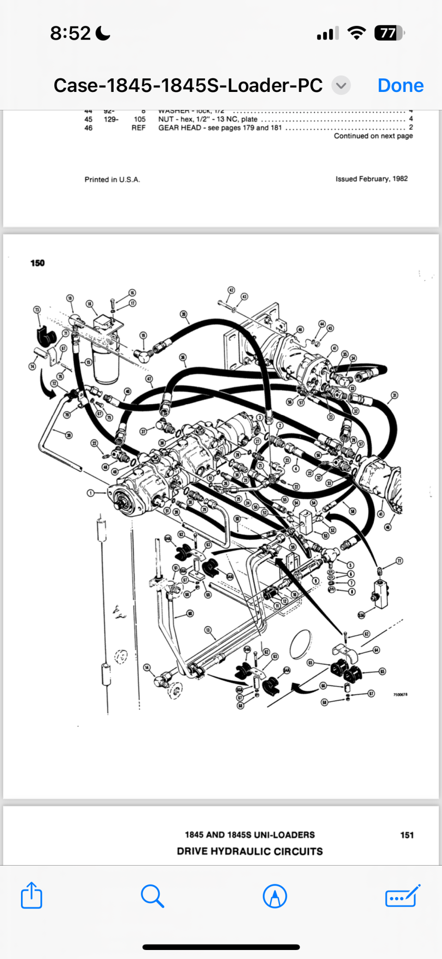

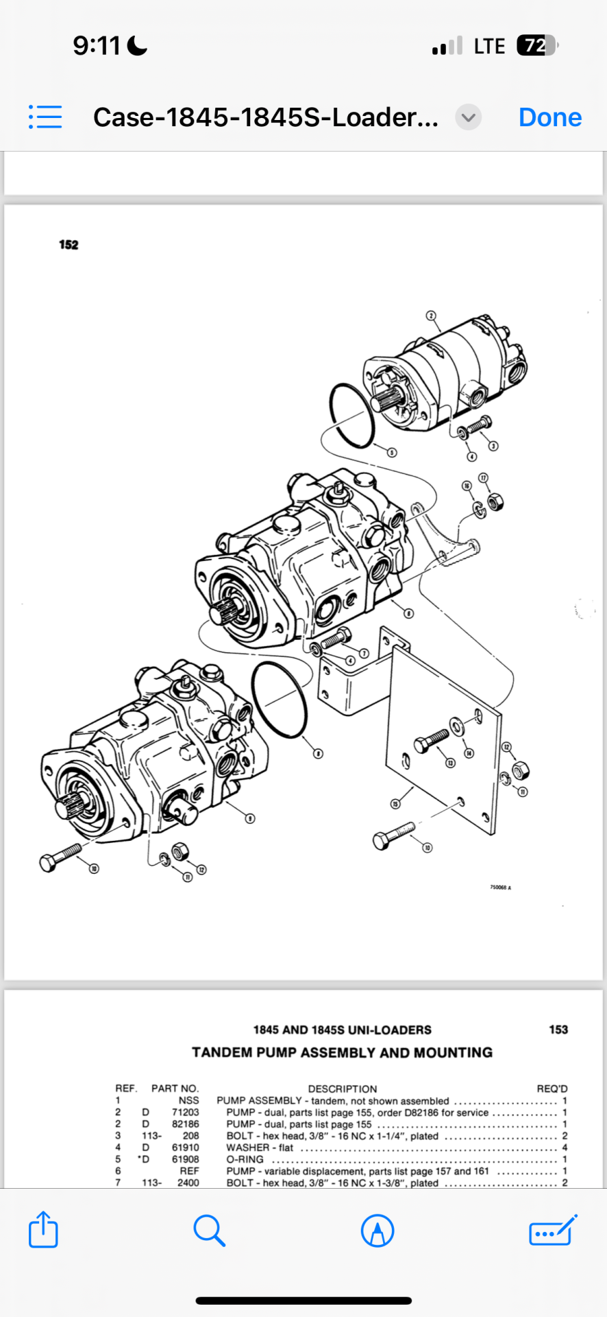

I’ve attached some pictures of the u-joint that runs to the pumps, and the 3 pumps that have been all checked over.

I've attached some pictures of the u-joint that runs to the pumps, and the 3 pumps that have been all checked over.

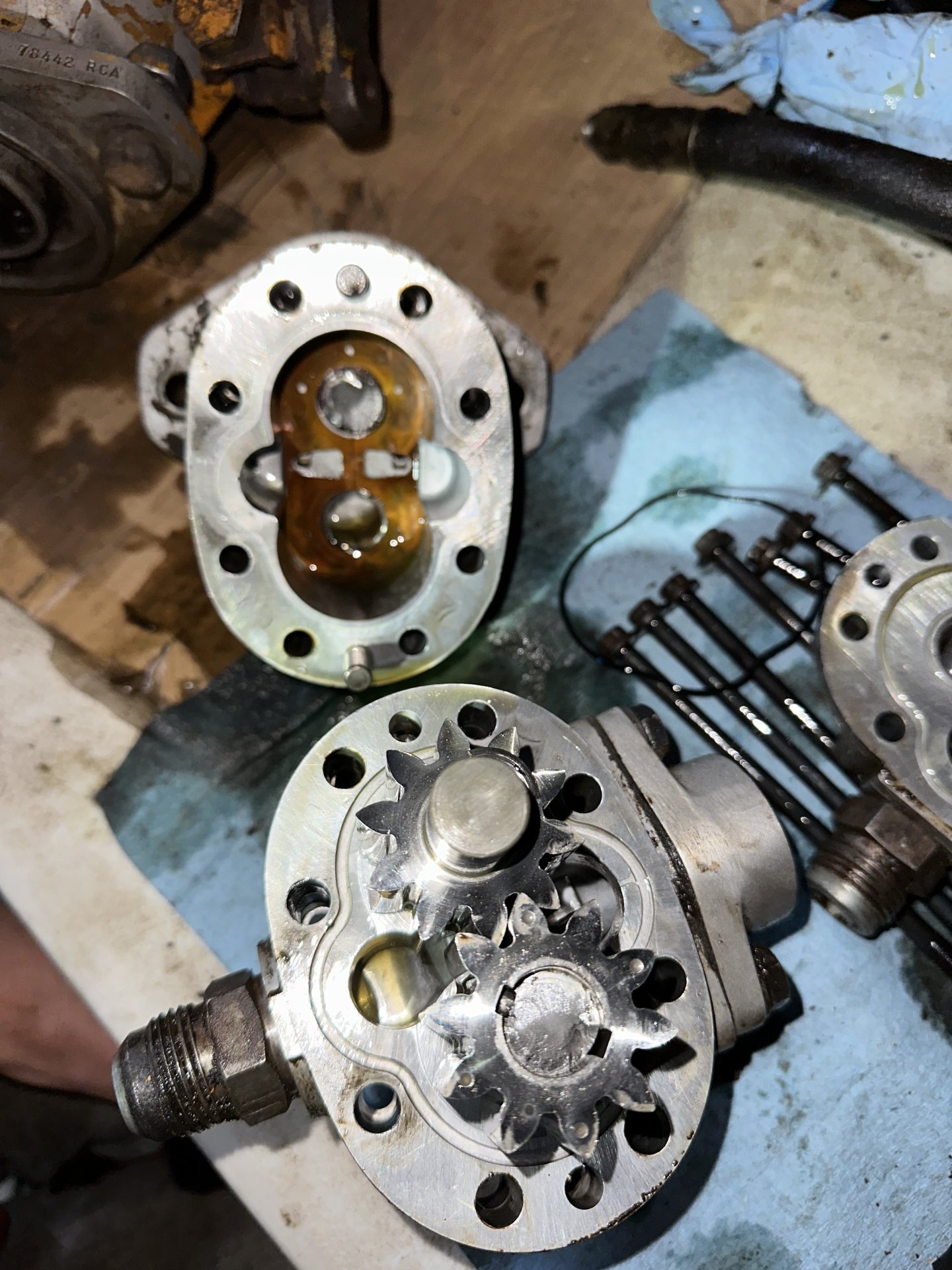

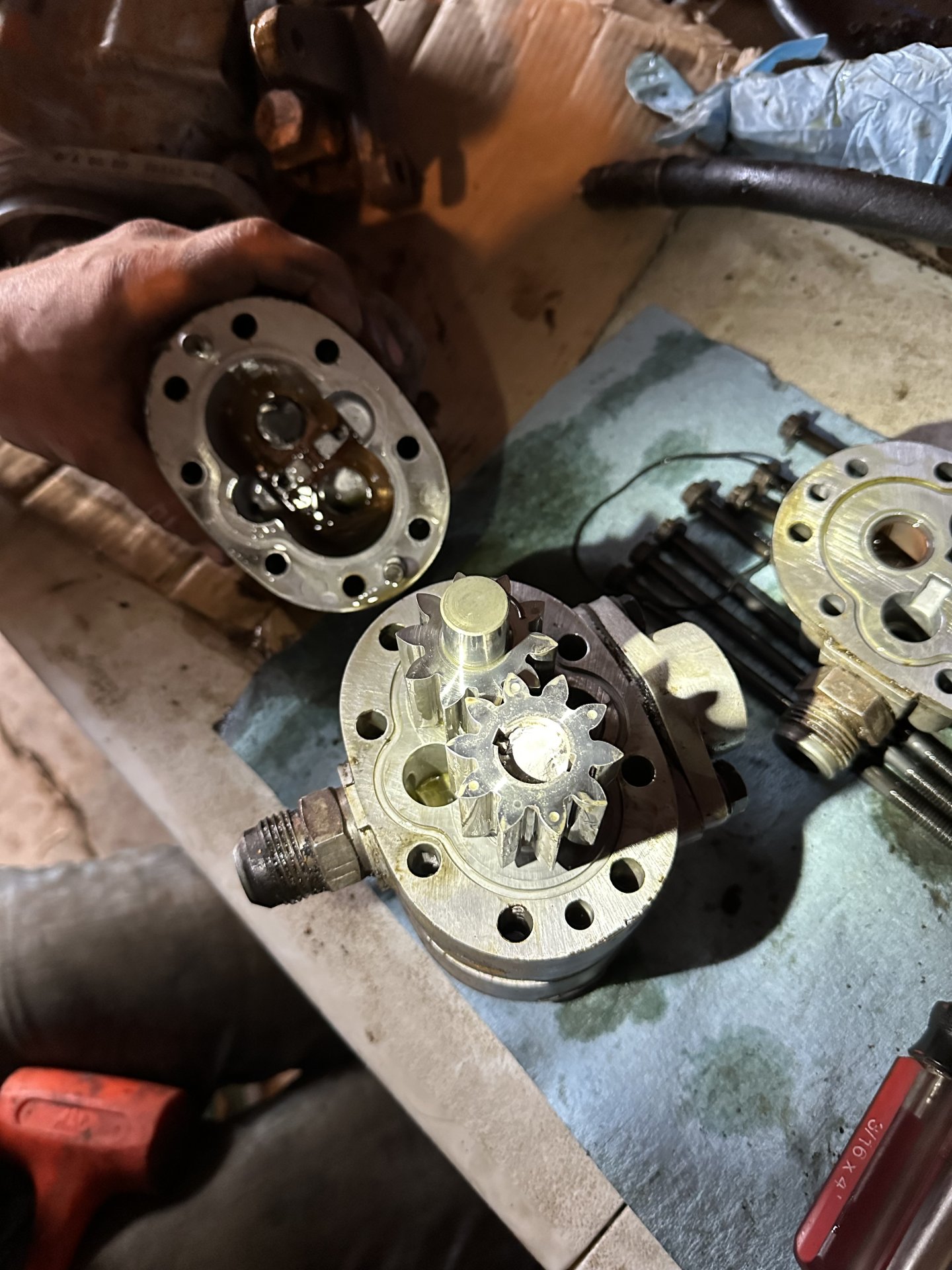

We have found the problem after we had dug through the whole machine and could not find the slightest imperfections on exterior of pumps/drive. Today we decided to split all 3 pumps. The shaft interior completely snapped. Keep in mind when we moved the pump from the outside it was not slipping or catching. New pump is ordered through all state ag. Thanks for the help.
