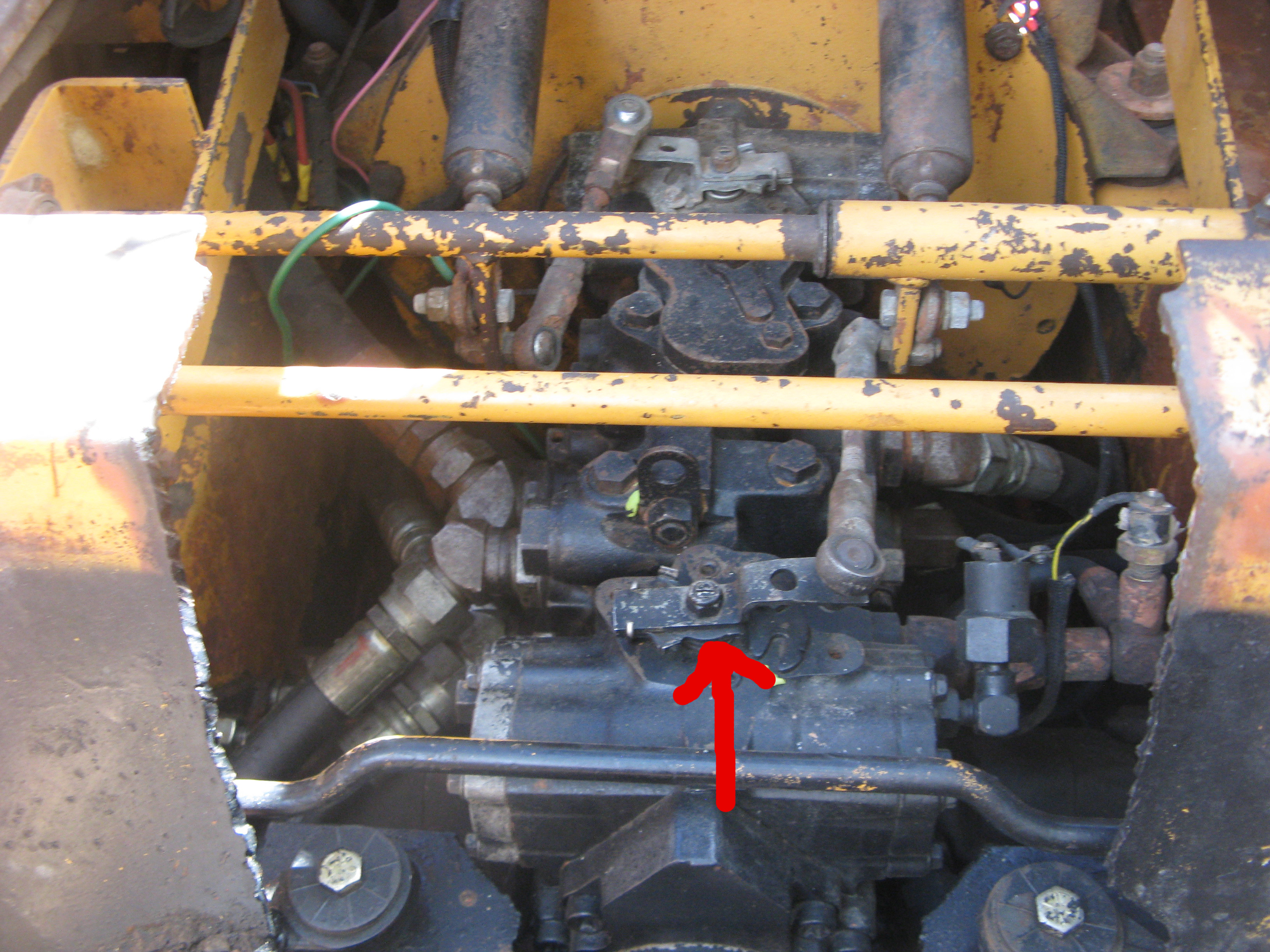

Case 1840 I have a leak on the actuator lever on the rear of my Hydraulic Tandem Drive Pump

Case 1840 I have a leak on the actuator lever on the rear tandem drive pump. Can someone help me with this repair. Thanks, Joe.

Found this video: Replace 1845c Drive Spool Seals
Also found the repair O rings and washers at: Messicks.com
Parts Hotline
877-260-3528 Very good price and the salesman was very helpful. Posting this because I've been on 3 different forums for about a week and found no help. Maybe this will help someone else.
lol, that's my video.
Not sure if you've fixed yours yet or not. But one thing to know, there are inner and outer spool seals.
I first replace the inner seals, which didn't stop the leak. This vid is replacing the outer seals, which finally fixed my leak.
