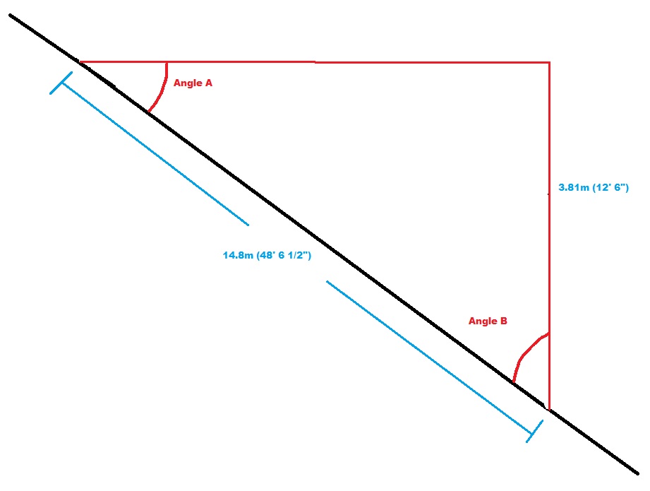

Got outside and measured my driveway using the laser level. The attached pic shows the situation. The black is the driveway and I measured along 14.8m (48' 6 1/2") of it. The elevation change over than distance was 3.81m (12' 6"). Now referring to some rather distance schooling, I make Angle A = 15 degrees and Angle B 75 degrees.
When referring to a slope, which figure is the right one - 15 or 75??

OK engage brain....neither?
3810/14800 = 0.257 or a 25.7% grade?
