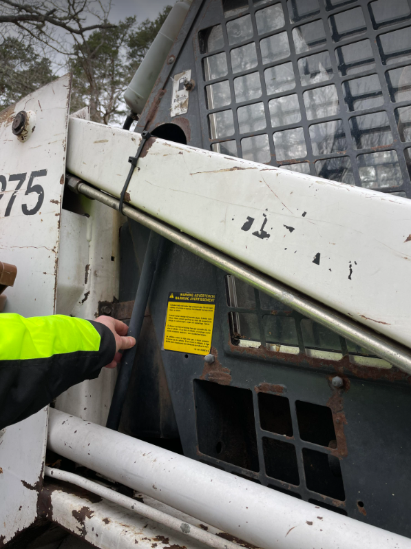

Hi friends,
The cab on my 643 is super heavy. It's extremely hard to tilt it even by two full grown men (jokes welcome 😁).
There are two gas springs/dampers, one on each side of the cab. Se picture below. I've also notised that some models have a horizontal "spring" between the chassie and cab back window. I guess it's for assisiting when tilting the cab upwards? I can't find such a spring on my 643 though.
So, I wonder if the gas springs/dampers might be bad (out of gas?) and don't assist in tilting the cab anymore? Anyone had this problem before? This machine is quite old and prob. from early ~1980 something.
Cheers to ya' all!
BRs /Stefan @ Sweden

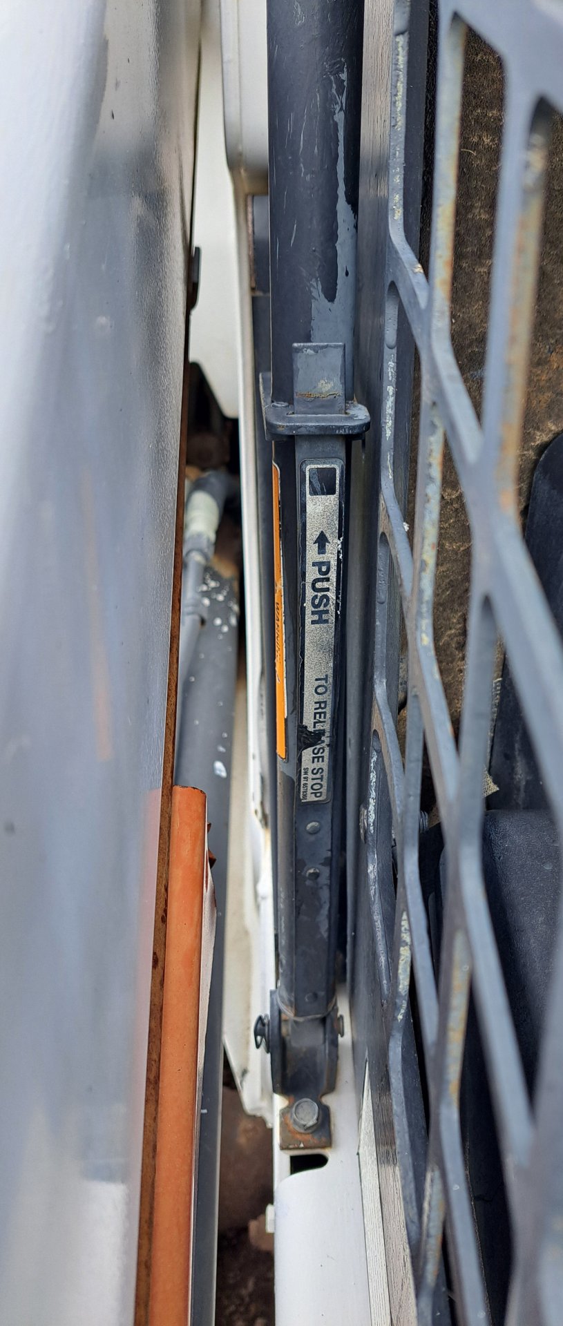

But it should not take a lot of force to safely lift the cab. There should be some type of Lock Out / Release to safely keep up and lower. Here is what mine looks like...

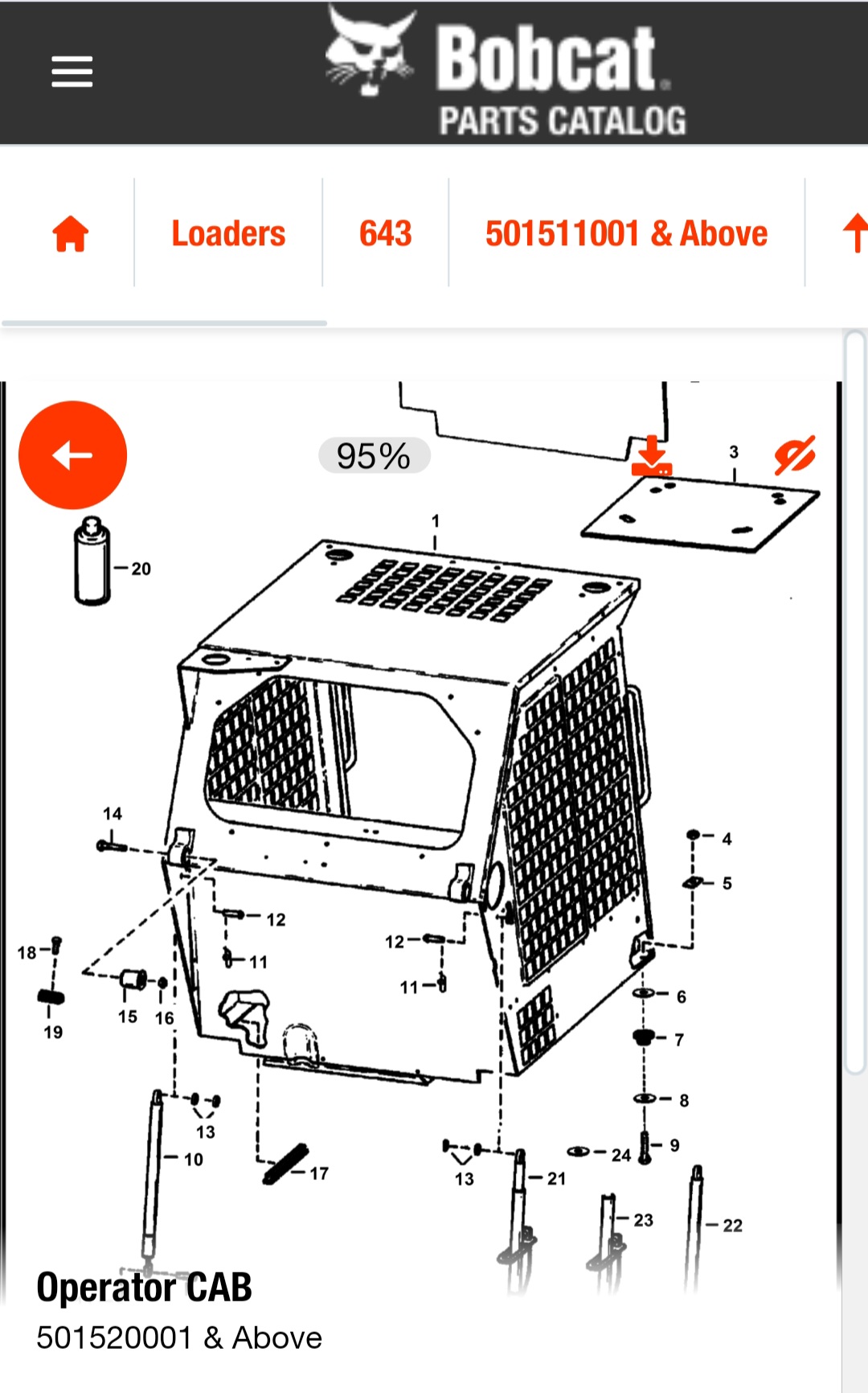

Alright thank's for the heads up. Do you know if left/right cylinders are the same? I recon that there are different part numbers for left vs. right?!?
They are different. Did you look up your model & number on the Bobcat link I posted above? Once you do, look at the Cab. You will see the struts. Left and right.

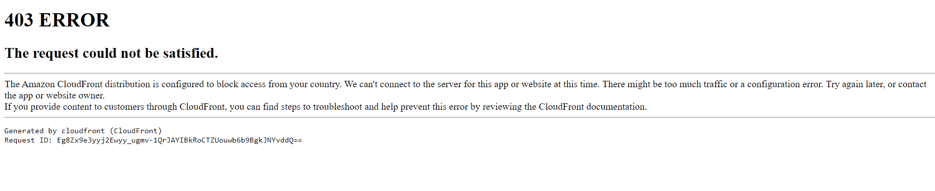

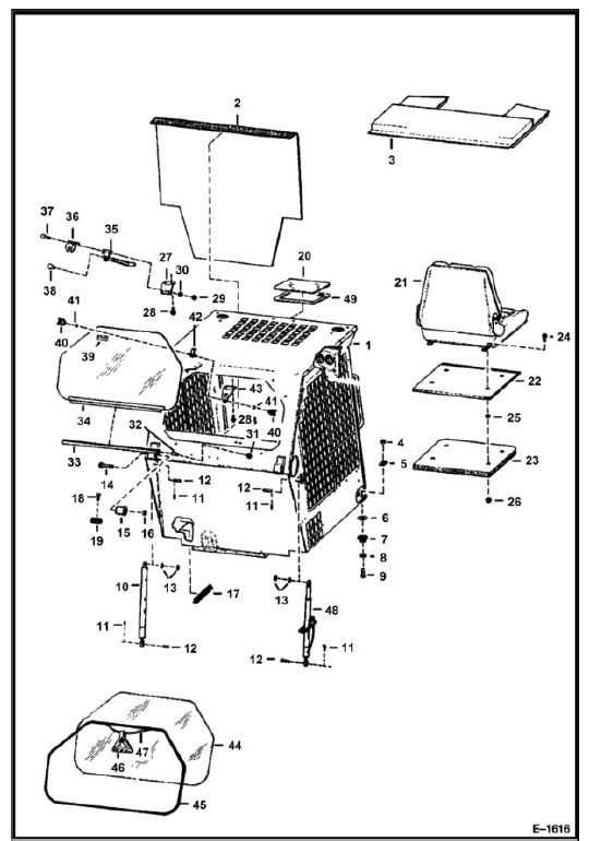

Hi, The link to the parts catalogue unfortunately gave me this 403 error message but I had a look in a PDF that someone posted (see attatched picture) for the 642 model and found the following part numbers:
6700171:
#10
, CYLINDER GAS, W/O lock - Also Order 6675257 clevis - Was
6700000
or...
6670730:
#10
, SPRING, GAS, W/O lock - heavy duty - 6670730 Gas spring to be
used when loader is equipped W/Cab Enclosure. Because 6670730
Gas Spring in heavy duty w/larger diameter, (2) 91G-410 Screws,
with low profile heads, must be used in place of 35C-410 Bolt
located behind gas spring on left side of ROPS - includes clevis on
both ends.
...and
#48, GAS SPRING, GAS SPRING, NLA - W/Lock - Order 6664205 gas
spring, 6708189 tube & 6701174 washer - MUST ALSO ORDER
7169877 decal - Was 6701176, A
It seems like the left side gas spring referrs to part number 6670730 and on the right hand side there are a few components that builds up the complete gas spring w. lock mechanism 6664205+6708189+6701174 (referred to as #48 in the manual)?
