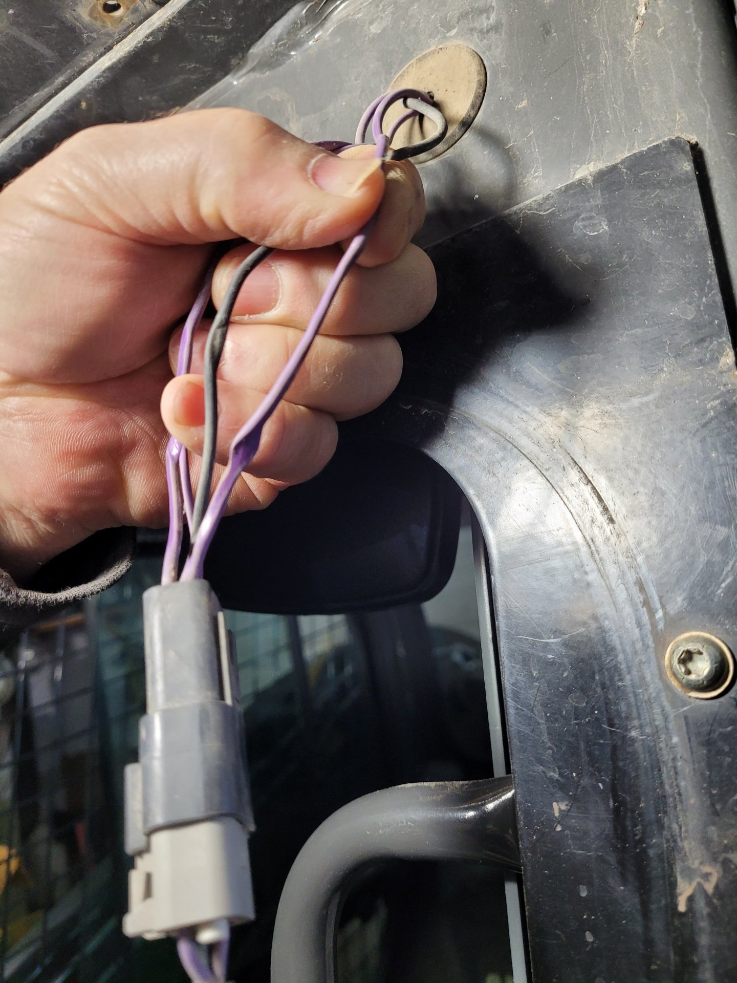

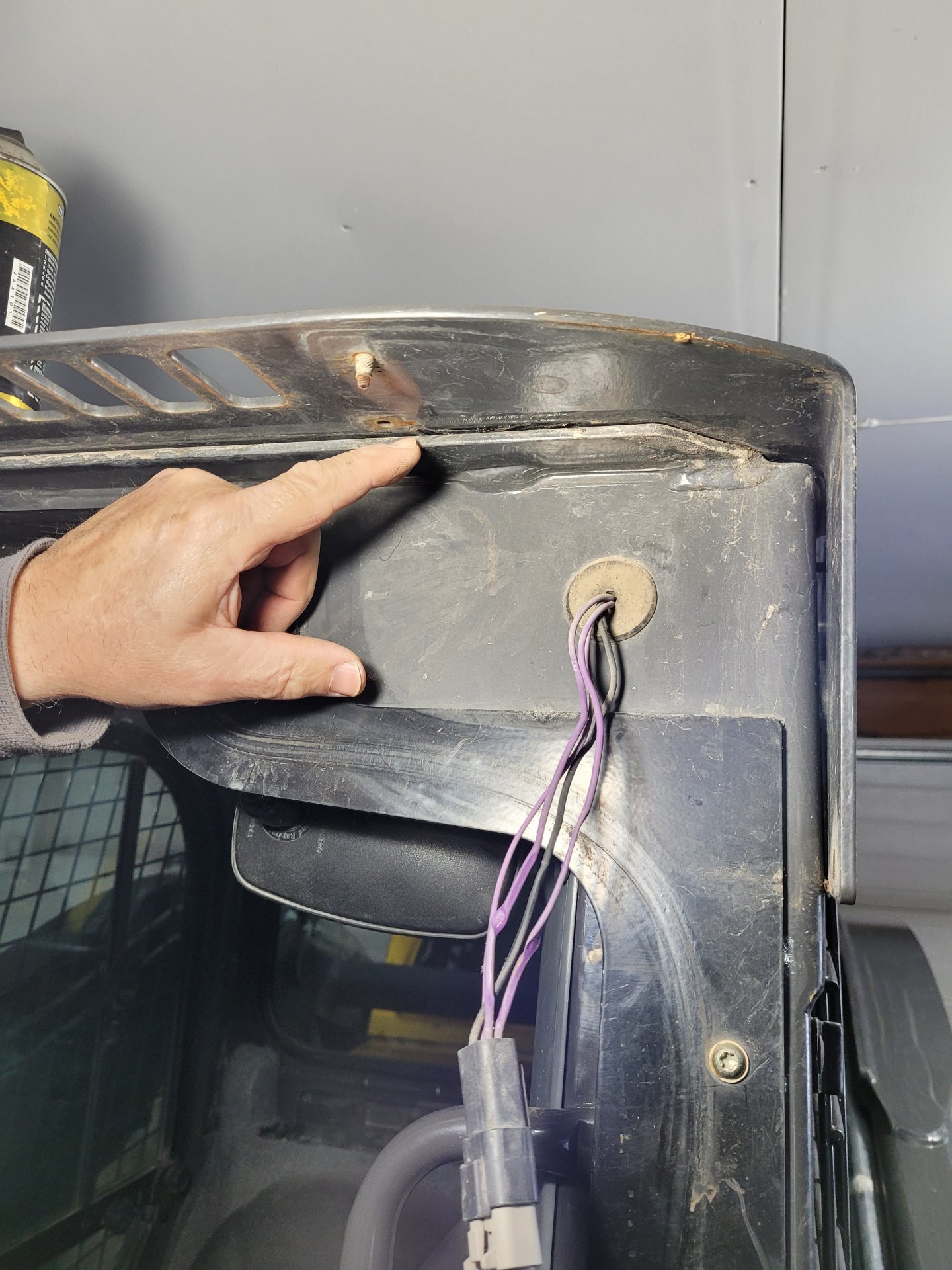

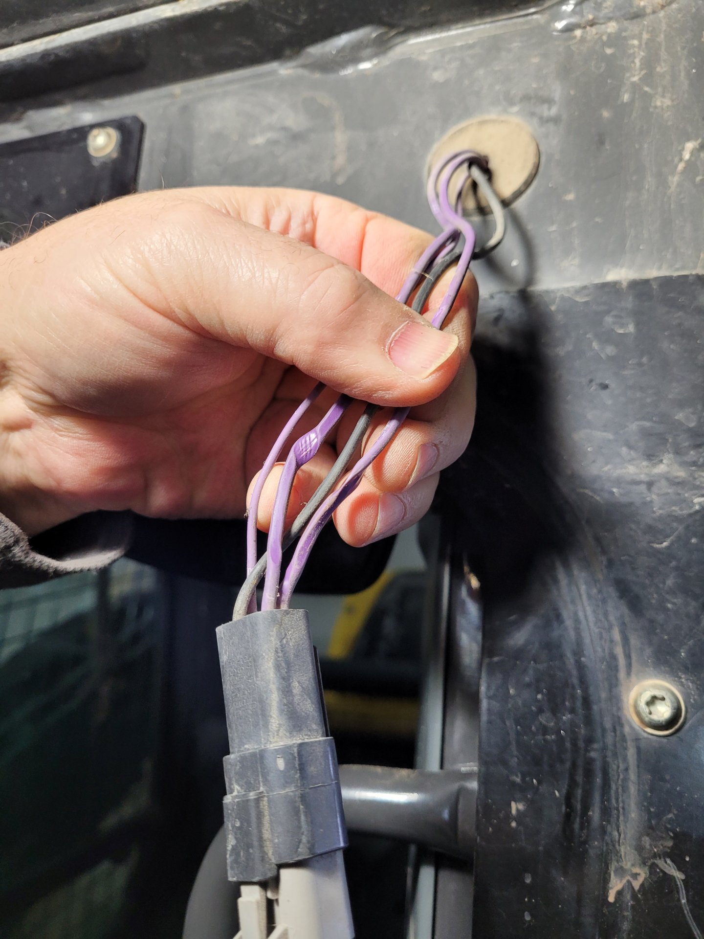

Well thanks for all your input guys turns out the the drivers side headlight wires were pinched from factory causing the switch issue and the blower/accessorie fuse is issue is being repaired by running a new wire with an inline fuse.
Glad to see you found it. A lot of the time the bad wires are wrapped and impossible to see. You’d think that with as many electrical problems as all machines have they would look into a better way to wire them.
