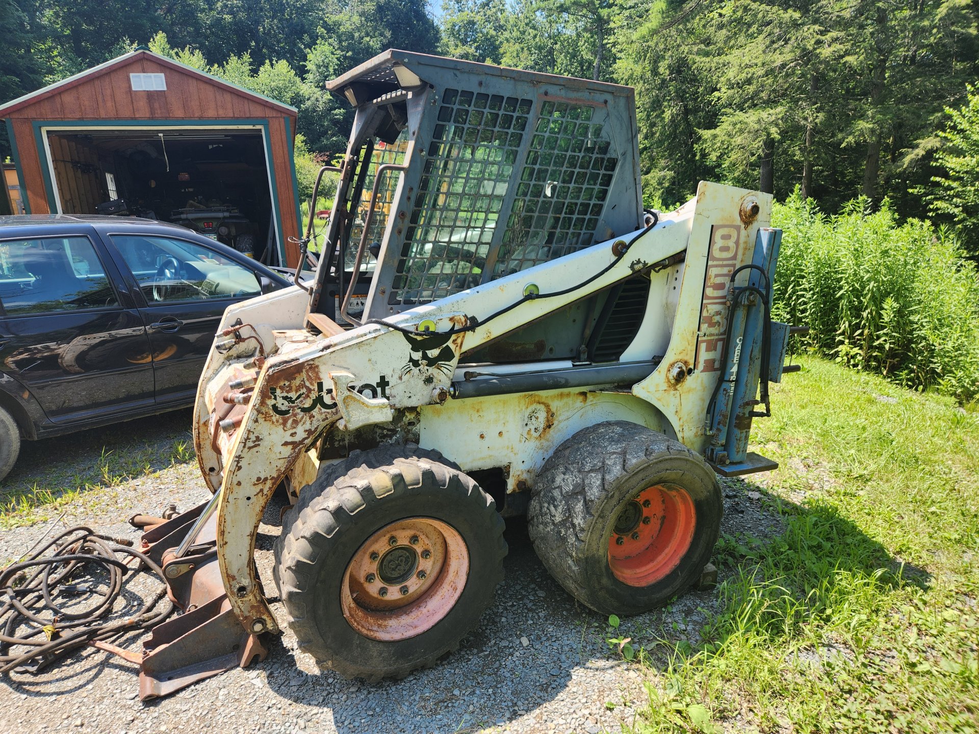

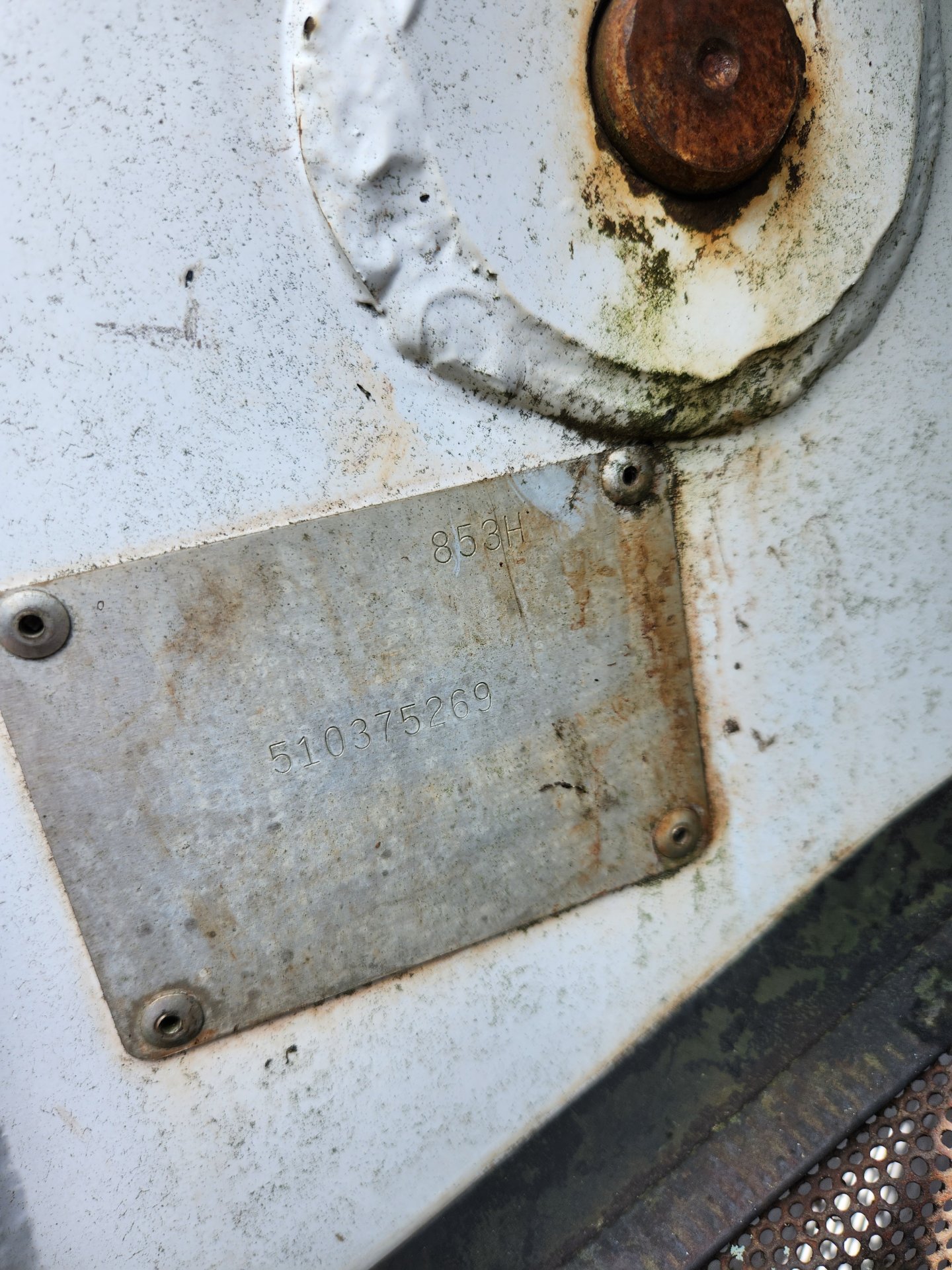

The 853H has 3600hrs and a running Isuzu engine. It is missing the main hydraulic valve and auxiliary double gear pump for the loader as well as the hydraulic tank and many lines/hoses. This is what I have figured out so far at least.... Supposedly this machine ran and moved fine but it had hydraulic problems on the loader side and was taken apart 5 years ago. The machine came from a tree farm and was running a tree spade and seems to have been well kept previous to the failure. This machine also is equipped with rear stabilizers, backhoe mounts, and heat.

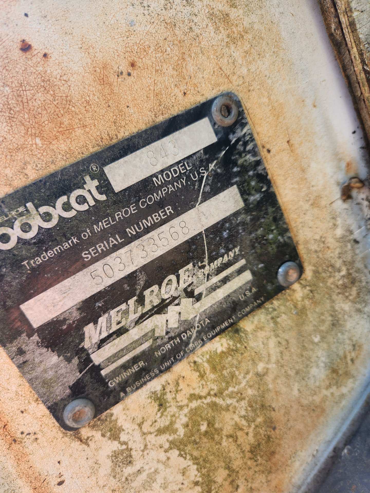

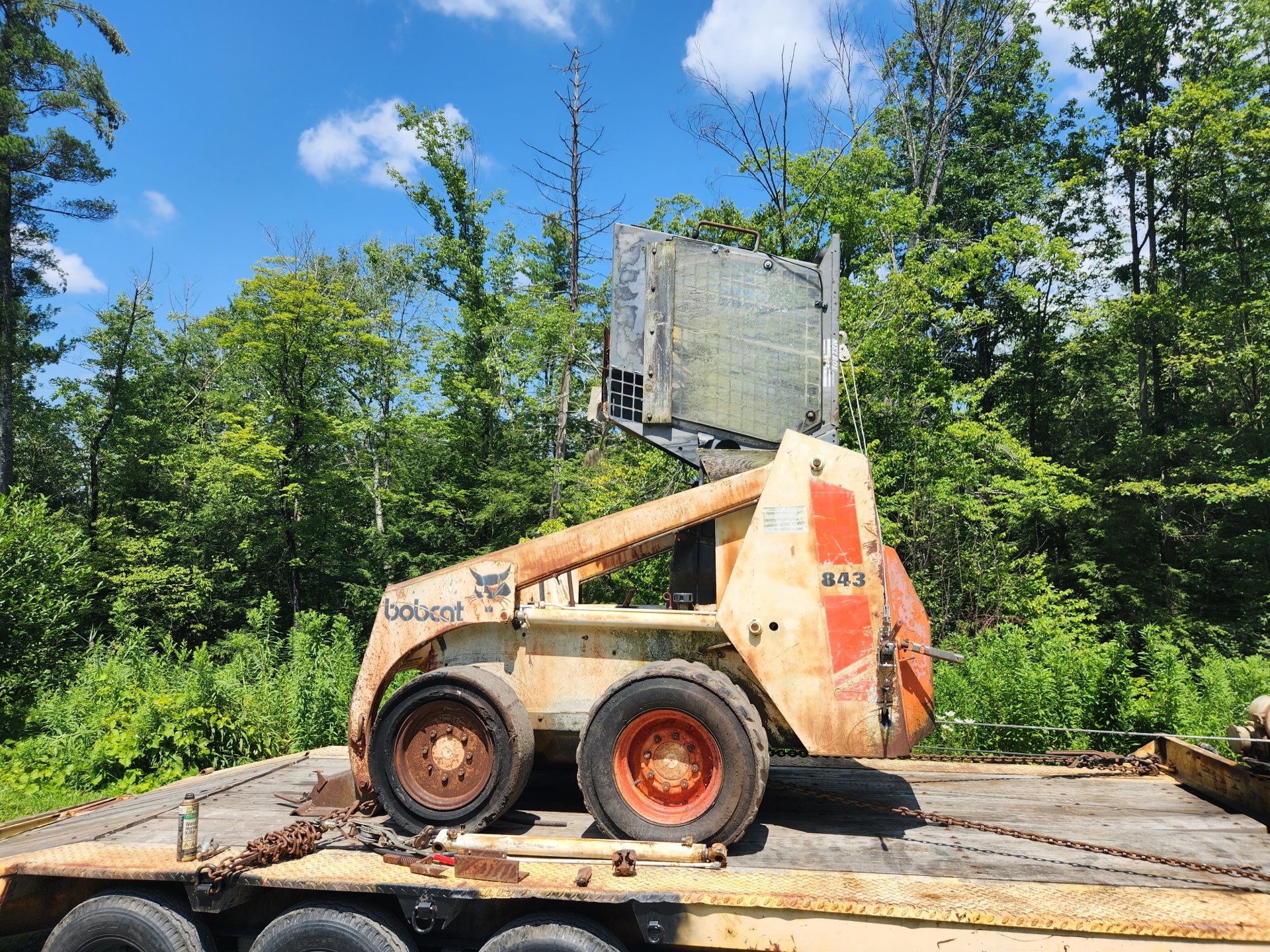

The 843 (3700hrs) is complete minus the engine, engine mounts, and flywheel. Previous owner stated they stole the engine for a reefer unit. This is a late model with the Isuzu engine, I believe the same engine from my 853H actually. PO stated that this machine did not move but hydraulics worked otherwise. I noticed it rolls extremely easy when compared to the 853, possibly a chaincase problem? This machine appears much harder worked with more worn out pins. One loader lift cylinder is removed however I do have it.

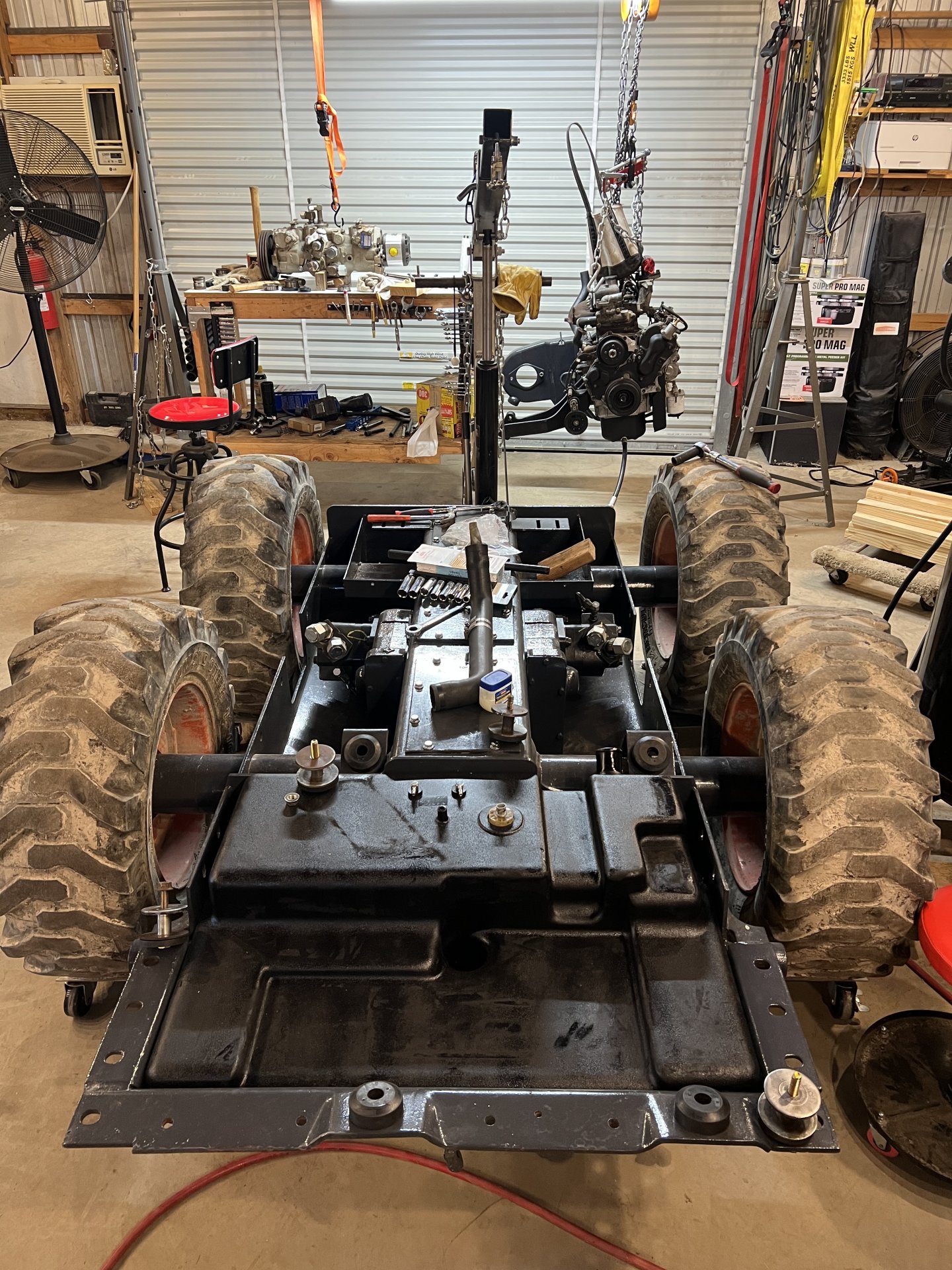

I am in the process (now 14 months in) of reassembling my 853 and I rebuilt/replaced everything on it but the fuel pump. If you keep the 853 I’ve got a boatload of pictures and manuals that may help you put the jigsaw back together. I paid the federal government $2,300 for my non-operating 853 and the hydraulic hoses alone cost me the same amount to replace. To help you decide about the engine swap, I’ll take a picture tomorrow showing the engine mounts on an 853. If you part out the 853, I am in need of the parking brake system - mine came with no brakes.

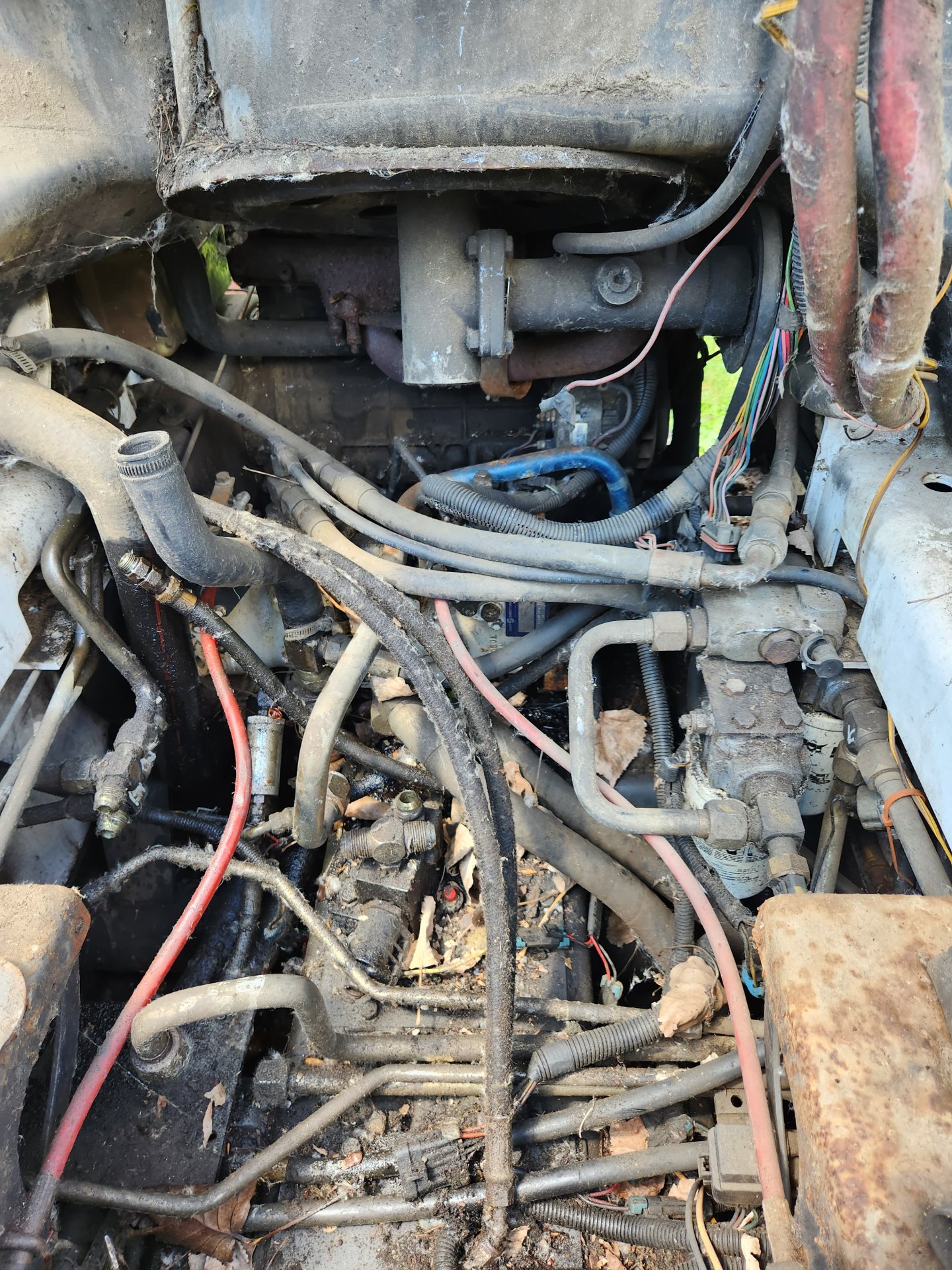

Wateka, I would appreciate some pictures of under the cab on the 853 specifically hydraulic hose routing and valves. Having a hard time finding any pictures of it!

From your pics, I see both units have tires of different sizes on one side. If that was just to get them moved, no problem, but if used that way to work it would put a constant strain on the chain case components. Maybe you will be lucky and only the chain(s) broke on one of them.

I am in the process (now 14 months in) of reassembling my 853 and I rebuilt/replaced everything on it but the fuel pump. If you keep the 853 I've got a boatload of pictures and manuals that may help you put the jigsaw back together. I paid the federal government $2,300 for my non-operating 853 and the hydraulic hoses alone cost me the same amount to replace. To help you decide about the engine swap, I'll take a picture tomorrow showing the engine mounts on an 853. If you part out the 853, I am in need of the parking brake system - mine came with no brakes.
