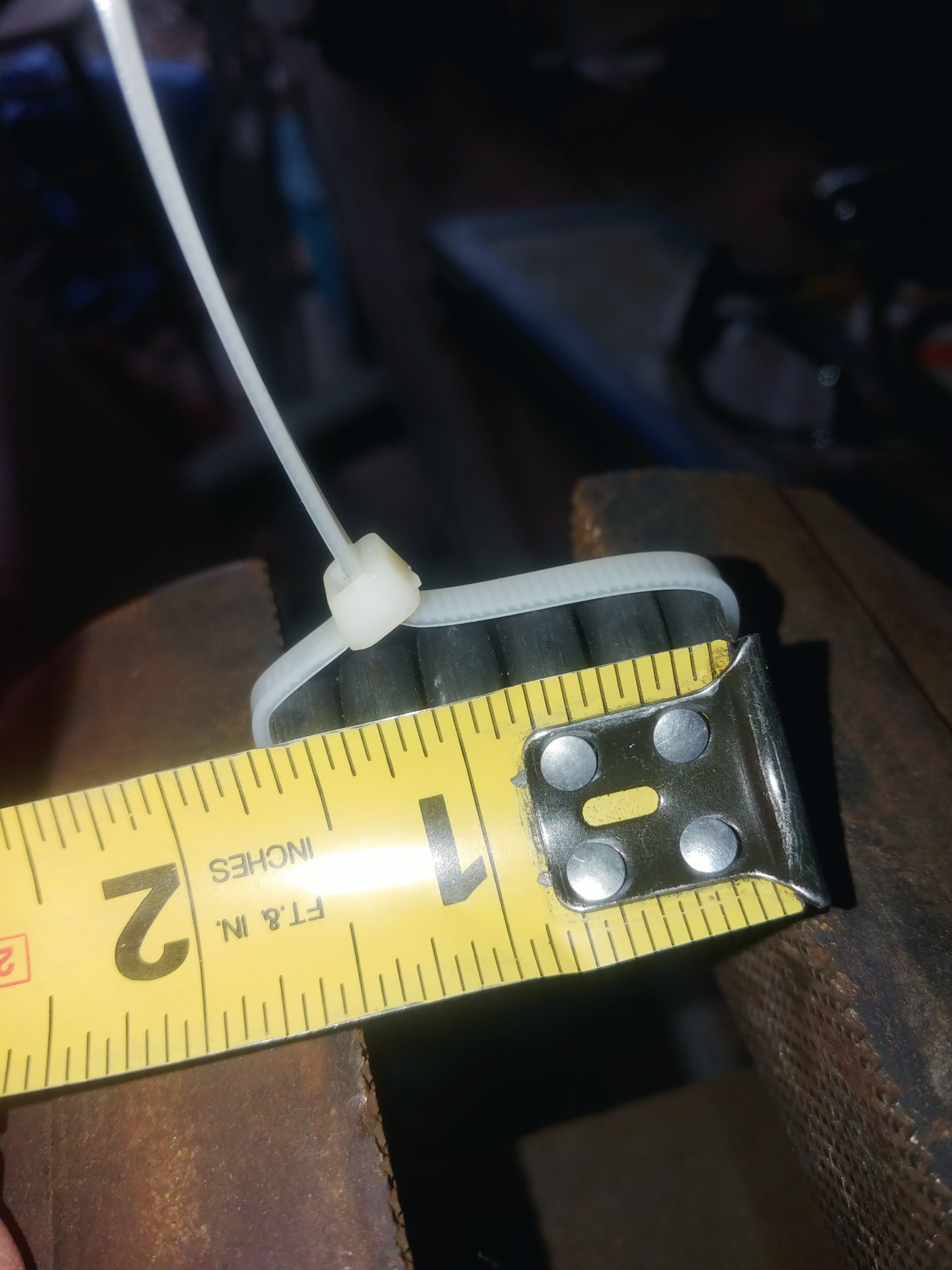

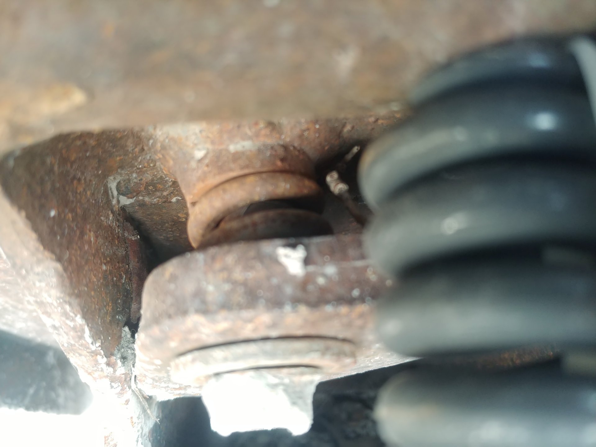

one of my handle springs on the Bobcat on my 743 was missing so I bought a pair from eBay that supposedly fit but it's too long without being compressed and extremely stiff. the bolt isn't long enough to start and I'm not sure how to compress that spring. I'm thinking to put it in a vise and try to hold it with a zip tie see if that will get it on but maybe the springs just too long?
obviously I got the wrong spring
first pic shows new vs existing, 3x thicker plus longer
spring compressed is 1 -5/8 - 1-3/4

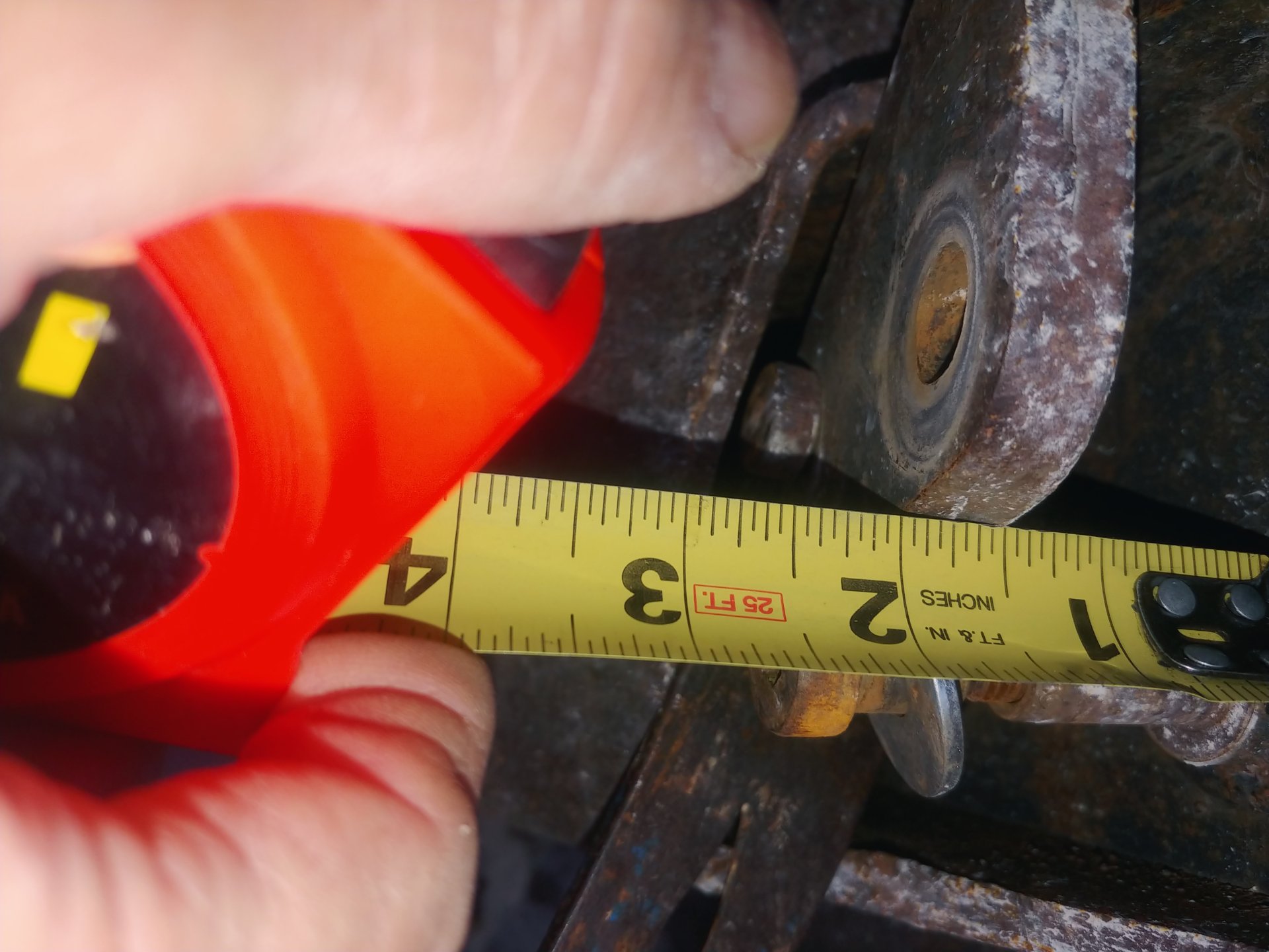

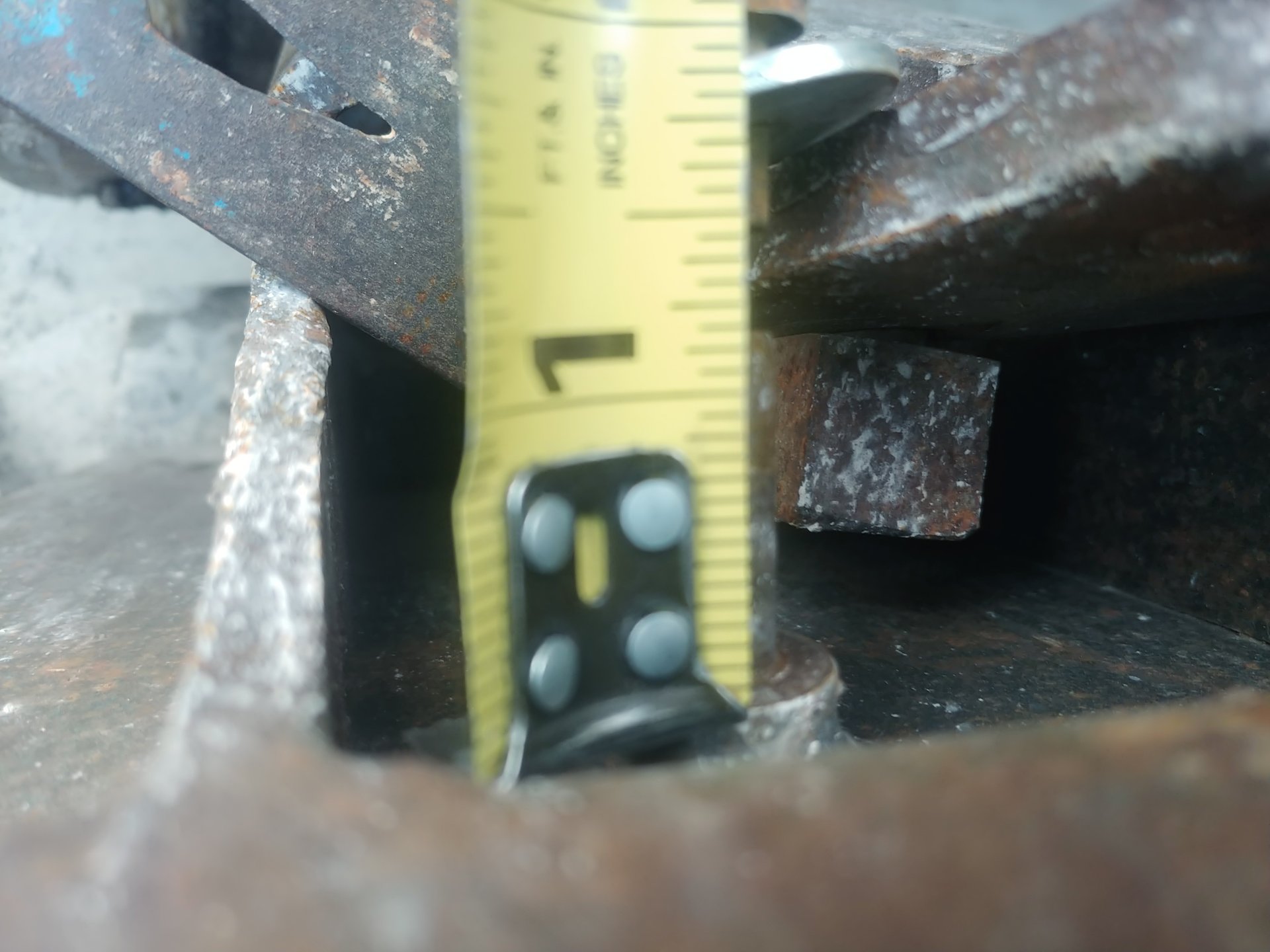

max space to start screw is 1-1/4
bummer
