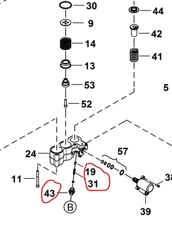

There is also a poppet valve in the control valve, if that popped valve is damaged you will have break issues as well.
Remove 43, it is connected to a tube line, you should find pieces of a spring (if not use a pick and look inside the tube line, and a worn poppet.
Disregard the poppet valve and the spring, look into your piece #43. Does it have a Screen? If yes punch it out, if it is already destroyed make sure to take the rest off. And then install it back.
OR by an updated fitting by bobcat which replaces #43.
Thank you very much. I will check that ASAP.
