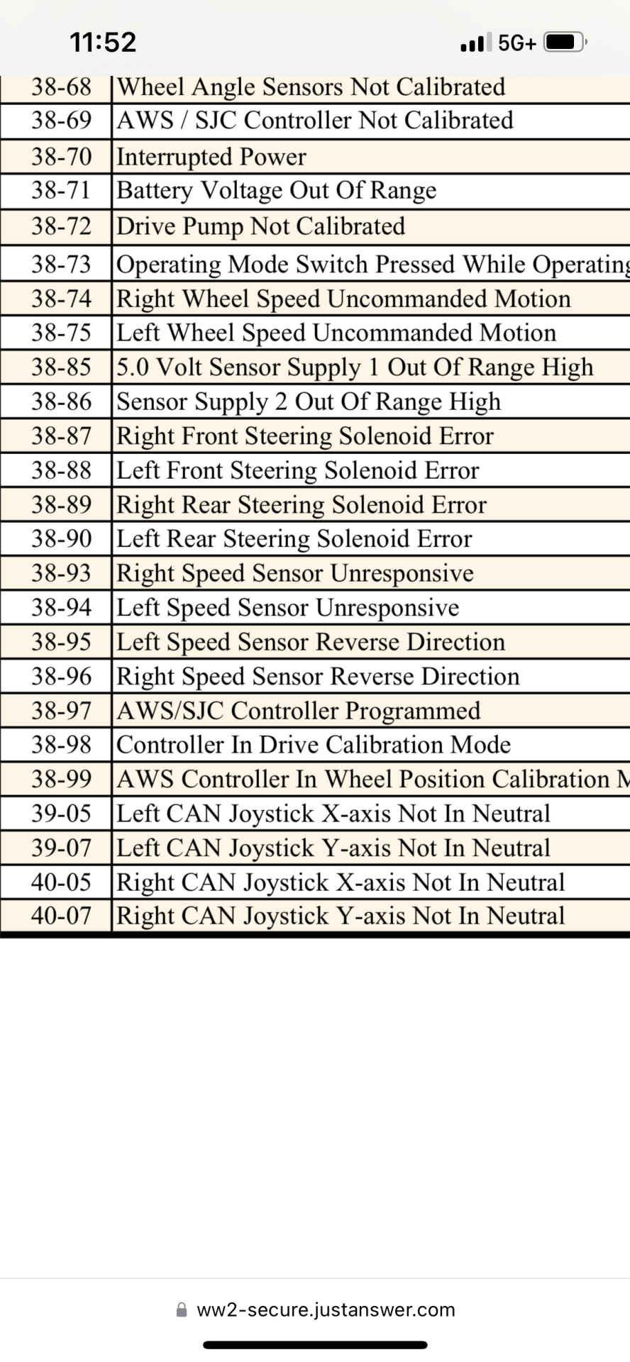

I tried searching the Forum for anything related to my particular issue but I can't seem to find anything that follows the same problems I'm having. I have a 2001 Bobcat T300 with 2029 hours on it. This unit has joystick controls. I was using it earlier today and everything worked as it should. I shut the machine down and paid the delivery driver and went in the house and got a drink and came back out and restarted the machine and at that time notice the Tilt will not work. If I keep the right joystick moved to the left or to the right for more than a couple seconds which would normally enable tilt the ACS light will come on. If I only momentarily move the joystick to the left or the right but don't hold it for very long nothing happens at all. The boom operates just fine with plenty of power. The bobtatch works fine with no issues. I can drive the unit around with no issues. It's just the Tilt that won't work. Any ideas on what's wrong and how to fix this? When I get the ACS light to activate I get the following error codes: 39-07, 39-05, 40-05. Again I only get these error codes if I hold the left or right position of the right joystick for more than a couple of seconds. I did try calibrating the machine but when I go through the calibration procedure the ACS light comes on as soon as I turn the key to the on position. Thanks in advance! Andy
So the computer thinks the joystick isn’t in neutral and it thinks it should be there is a procedure to calibrate this I’ll try to see if I can find it other wise it might be a joystick issue
    665.8 KB
Thanks for posting. The thing that's confusing to me is that when I press the green button to activate the Hydraulics I get no errors. It knows the joysticks are in neutral. I only get the ACS light when I hold tilt up or tilt out for more than a second. It would make sense that it's not in neutral because I'm the one moving it out of neutral?
