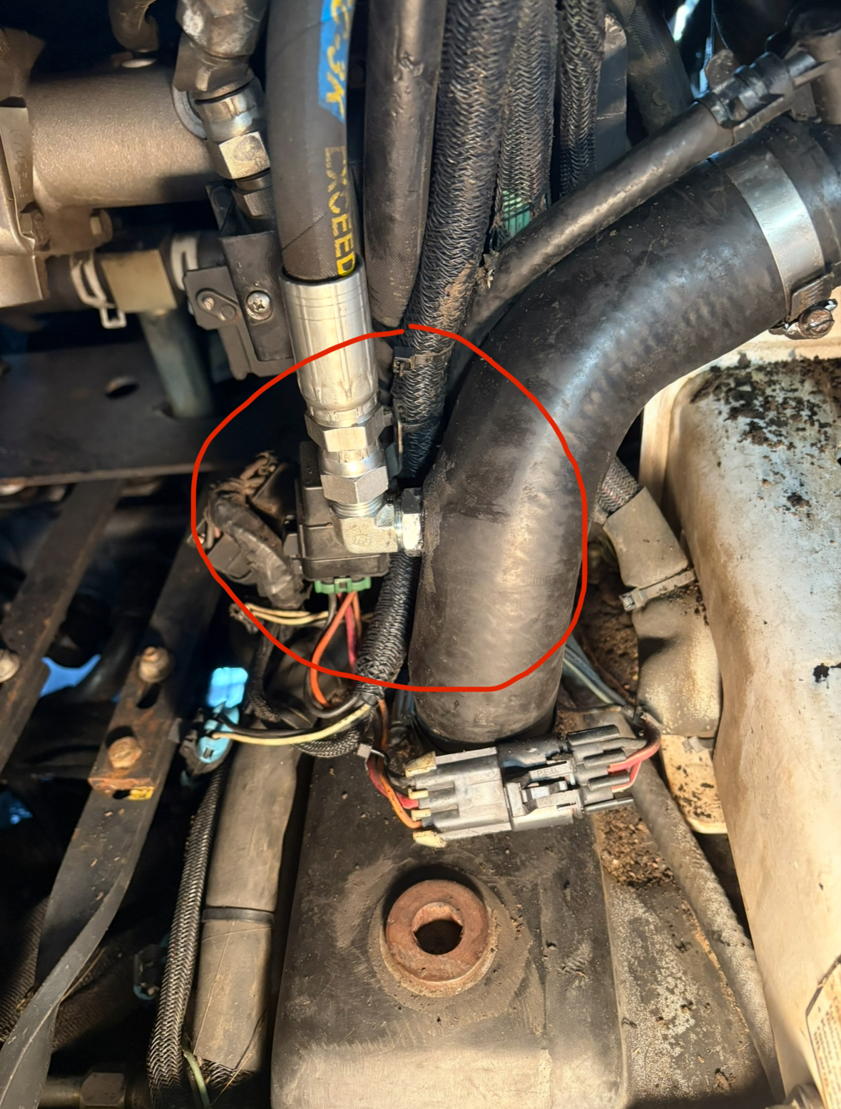

Well that is one way, but will properly leak soon.View attachment 8943There is a cap on top of the hydraulic tank that I thought about modding to get the case drain connected to the tank. Unfortunately the back of the cab covers it. I ended up using an elbow with a tapered side for the hydraulic hose and the other side of the fitting is 3/4" pipe thread with O rings and a nut inside the fill tube to secure it. I drilled a 3/4" hole in the fill tube to attach.

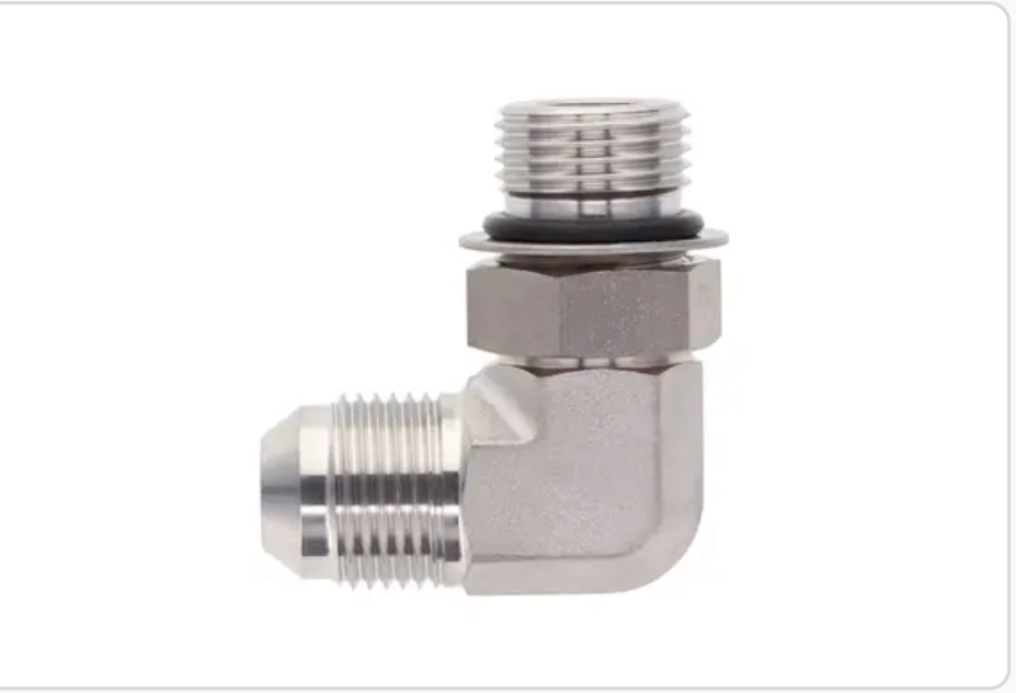

I didn’t want to drill into the tank and create a future leak so thought going into the hose would be better. By going into the hose if it did leak I could always replace the hose. I think the fitting I used (attached) with a o ring on both the outside and inside of the hose with a nut to secure would be my best choice. Any drainage from the case line would be low pressure.Well that is one way, but will properly leak soon.
That isn't a pipe thread. That is SAE O-ring. They will thread into pipe fittings, but they usually end up leaking, particularly if you thread a male pipe into a female SAE O-ring.
SAE fitting thread portions are straight, while NPT fittings are tapered.
The existing port on top of the hydraulic tank is covered by the cab which extends a couple inches behind and only 1” above the port. There wasn’t a way to get fittings into it with that close clearance. The hydraulic tank on the T200 is plastic and I didn’t want to drill into it and cause a leak. My best solution was to cut. 3/4’ hole in the fill tube. If that leaked it could be replaced. The fitting in the pictures above has been running now for hours and there is no sign of leaks.So, there wasn't any clearance to get an elbow into that existing port on the tank? I just did this on an excavator and they also had a port like yours, which was where the case drain was meant to go.
If you do end up drilling the tank, weld it or have it welded. That's what I did on the previous excavator which didn't come with the port like the new ones.
There should be a port also on the front side of the Tank and on the side, where the control valve is. There are usually straight fittings or 90 Elbows. I would have taken one of these off and replace it or put a T-Fitting in.The existing port on top of the hydraulic tank is covered by the cab which extends a couple inches behind and only 1" above the port. There wasn't a way to get fittings into it with that close clearance. The hydraulic tank on the T200 is plastic and I didn't want to drill into it and cause a leak. My best solution was to cut. 3/4' hole in the fill tube. If that leaked it could be replaced. The fitting in the pictures above has been running now for hours and there is no sign of leaks.
