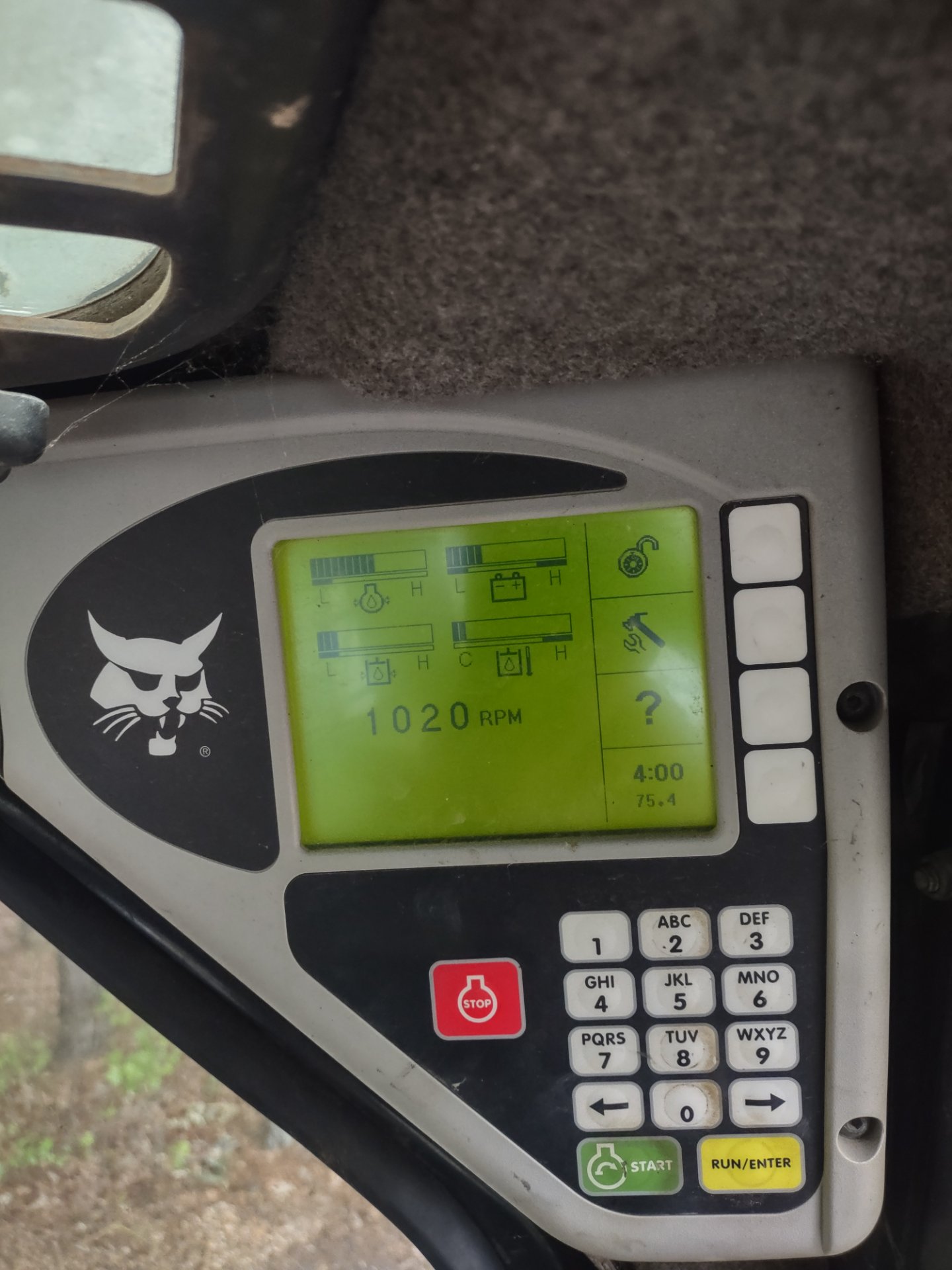

What is the gauge on the lower left of the display? I think the upper left is engine oil pressure, upper right battery voltage, lower right engine temp. I've looked for this online and the manuals I see don't mention it or if they do it's with a low res picture and you cannot read anything in it. Is the lower left gauge hydrostatic pressure? When It's cold out I have more bars and it drops to 3 bars when at operating temp. Is that too low and what exactly is that? I have 3000psi available at the AUX ports and everything works without any beeps or error messages.
