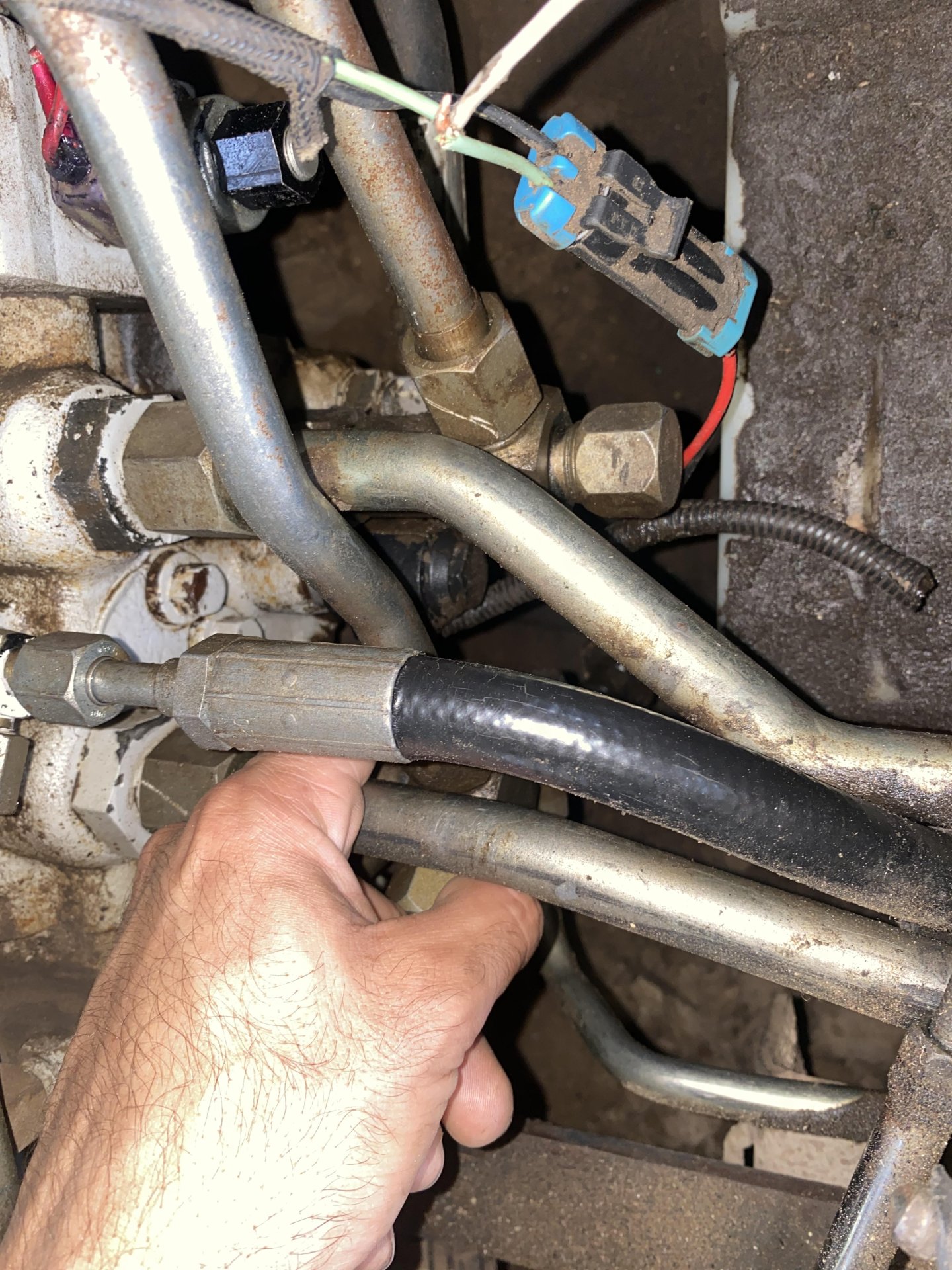

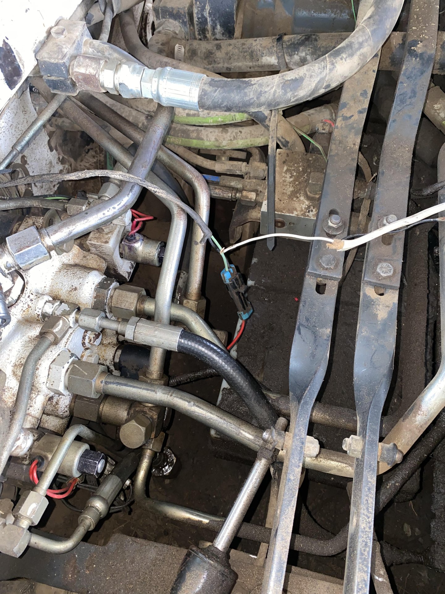

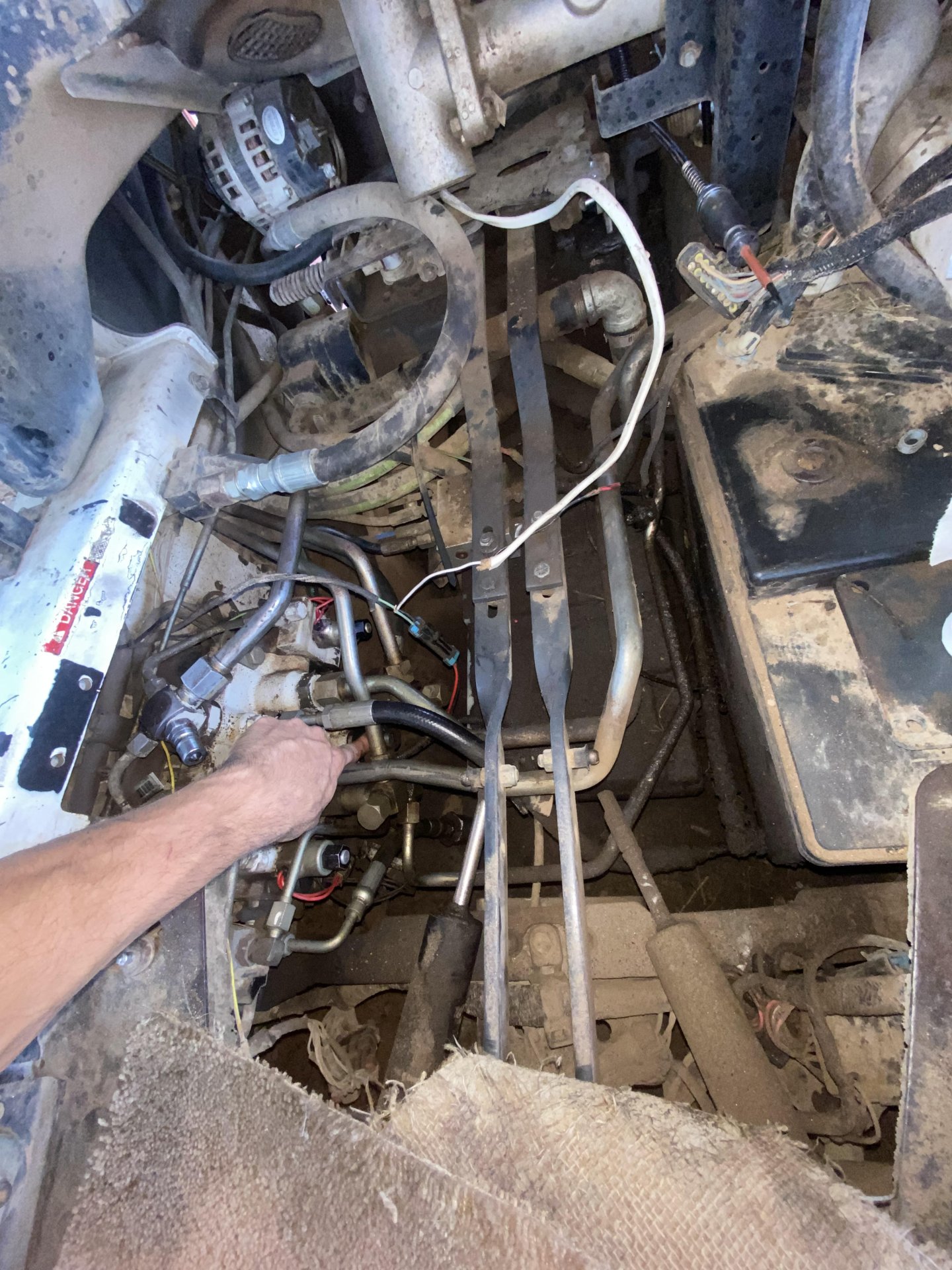

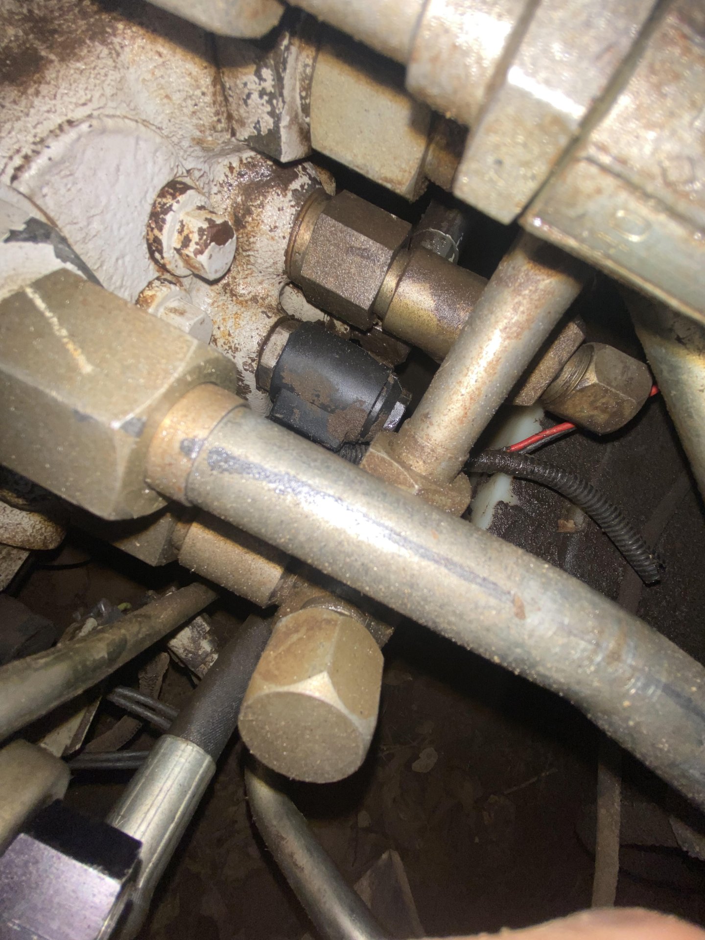

I'm under the cab trying to give power to the BICS solenoid
There are 2 flashes on the lift tilt bics display
I have a 5 amp fused line going into the circuit of the bottom solenoid
I believe: top two solenoids are for auxiliary, bottom is for lift tilt
In this video, individual powers the bottom solenoid with a switch to unlock the lift/tilt
Please help, possible cash reward if you help me figure it out
machine is stuck and needs to be picked up asap

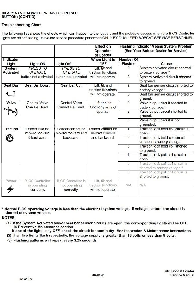

In the chart attached: 2 flashes on lift tilt means "VALVE OUTPUT CIRCUIT SHORTED TO BATTERY VOLTAGE"

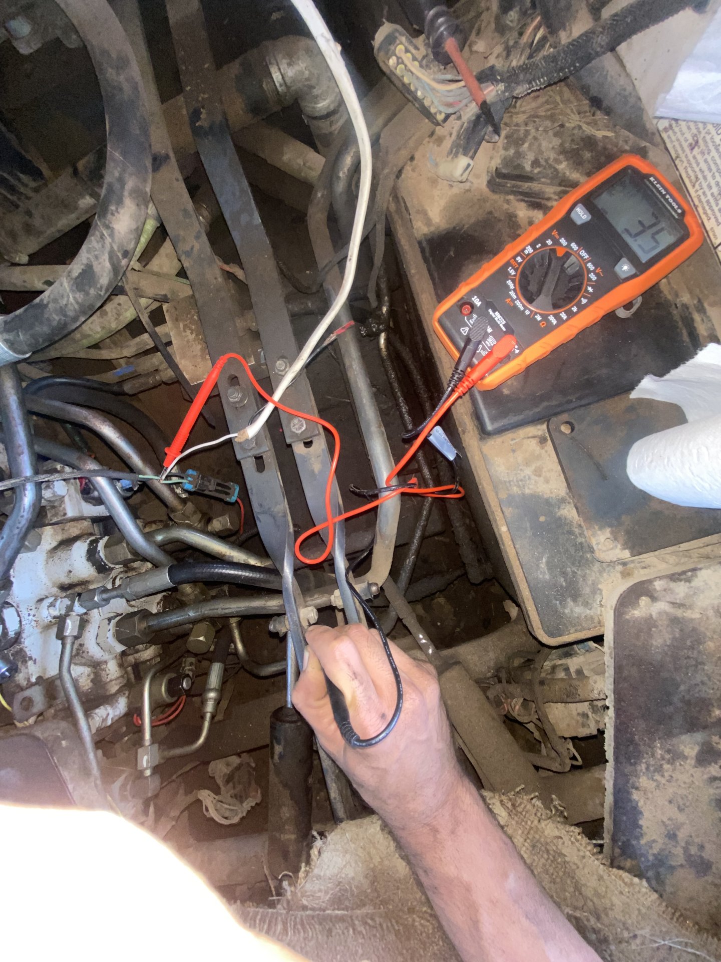

I checked for power going to any of the 3 solenoids, NONE of them have any power
Update: I just read that BICS voltage is less than 12 volts, I will go now and check voltage using volt meter and see if there is any voltage and what the number is
And giving it 12 volt is not going to fix it
Voltage is 3.5 at the bottom solenoid
After taking off 12 volt power to it, now there is ONE FLASH on the lift tilt dash light
