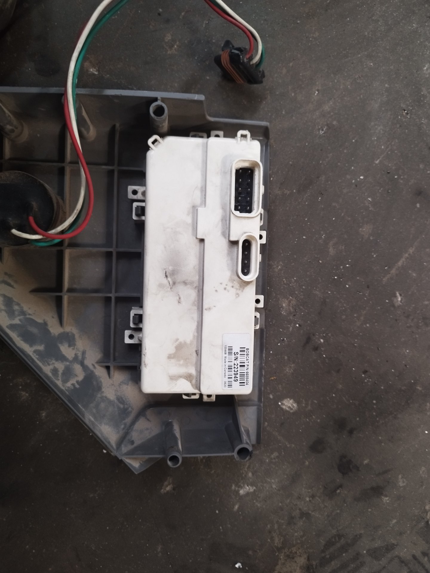

I have a problem with the bobcat s220, when you move it to the object it doesn't start, when you bring it back it starts every time.
if I turn it on directly from the starter, it starts. The ignition lock works without problems. Here is the question: could there be a fault in the hazard lights panel where the head connector and the ignition lock connector are connected, and would it be possible to test it somehow? this is a very chaotic and frustrating bug.maybe someone has experienced a similar problem and can advise

I wonder if there is an issue inside the unit you have photographed
Has anyone found how to test that unit

I had an issue with my S250 too, some times you turn the key on, and the panel may light up, or may not. Some days it would run fine then all of a sudden, shut off and try to throw me out of the cab when the brake kicks on.
The issue was found to be low power at the ignition switch, my mate was helping me look at the schematic and we injected 12v to it and presto, the dash lit up. I ended up jumping a wire to feed it +12v and now it hasn't missed a beat.
