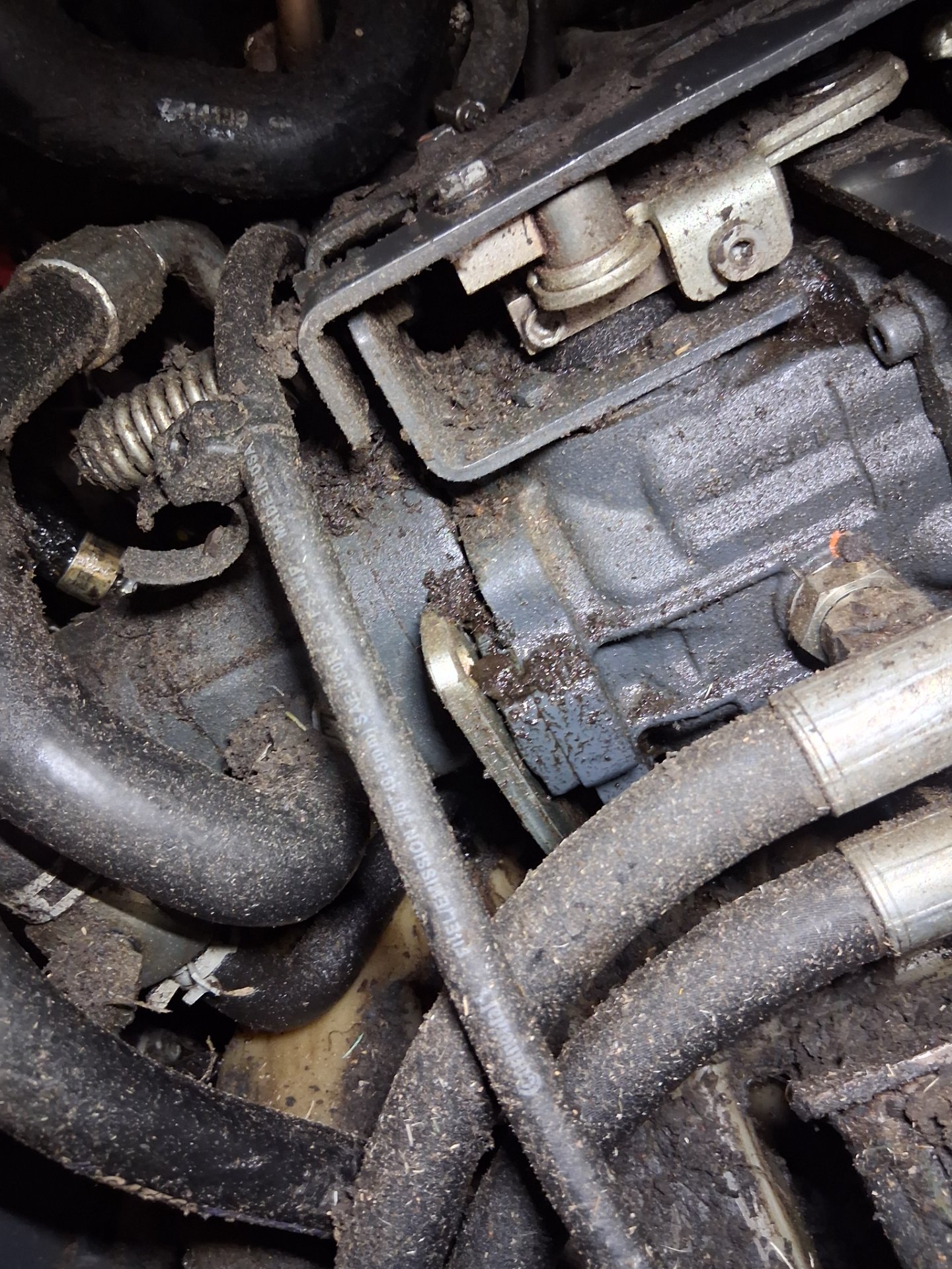

Howdy there! Bobcat support absolutely sucks for this, but ive got a S595 that is peeing hyd. Oil from the mating surface between the belt drive pump and the auxiliary pump. Ive got parts manuals showing me the look of the parts, but the hold down for the aux pump has to have a second bolt that cant be seen between that and the motor. Otherwise i feel it would have come off already. Heres a picture of what im dealing with. Unit has hand foot controls, no EH, and the typical D24 motor. Just looking for some advice before i think about pulling the entire drive motor. Thanks! (And yes the picture i attached is the cleanest part of this machine. In order to properly diagnose the leak i had to remove the 5 5gal buckets full of oil packed excelsior wood strands that this thing was buried in. Originally i couldnt even see the drive pump at all. Lol

I got the bolt that would be holding down the side that can be seen on the chrome plate in the photo, but im wondering on the backside because parts manuals only talk about one bolt.
