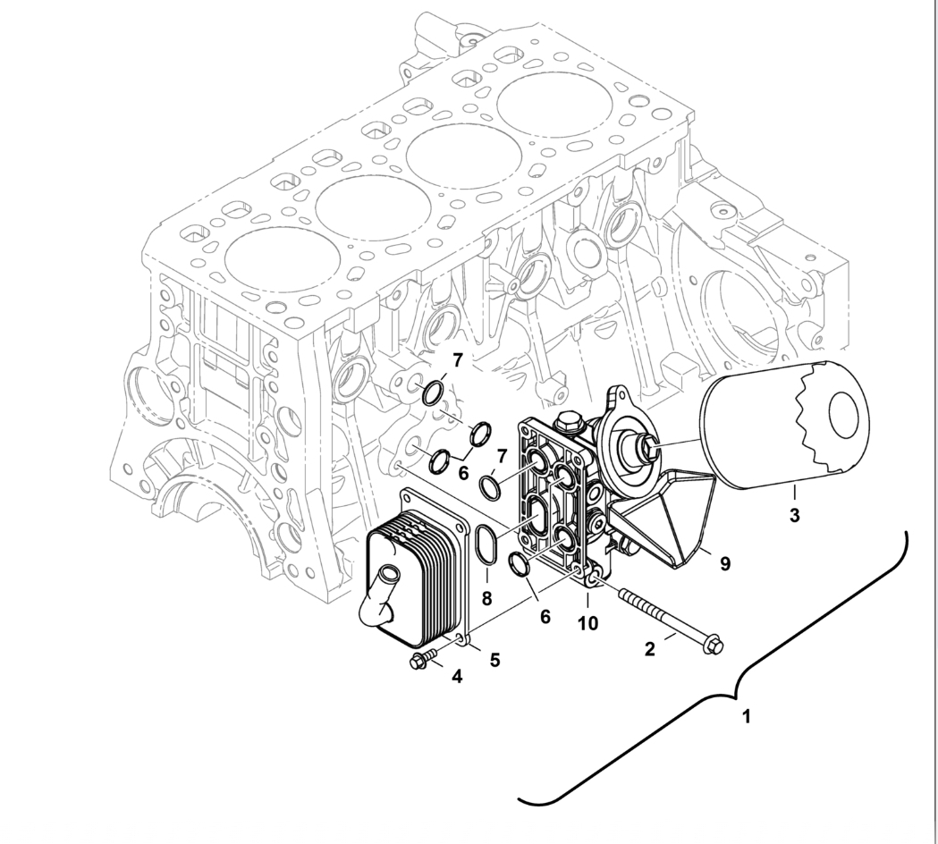

I replaced the head and gasket on a bobcat s510 but engine oil getting into coolant and coolant in the engine oil. I need help to fix this. Also all the head gasket service was done at bobcat dealer and they couldn’t solve the problem.
You've got coolant in the engine oil? Getting foamy or milky, almost looking like runny mayo?
Or you have oil in your coolant, looking like black oil blobs floating on top?
Yes there coolant in the engine and it looks milky also there is oil the coolant reservoir too
If everything was assembled properly, then you have a leaking oil cooler... Or bad o-rings in the cooler mounts, etc. The oil filter is attached to the cooler.
    262.8 KB

The diagnosis I gave you is based on the same oil cooler on the Chrysler Pentastar 3.6 v6 engine used in everything they make now. That oil leak is fairly common, and besides a cracked engine block, faulty (cracked) new (?) Engine head, or improperly installed head gasket, it is the only place you can mix oil and water.
If the cooler doesn't fix it, they installed a bad head or bad gasket, by process of elimination.
