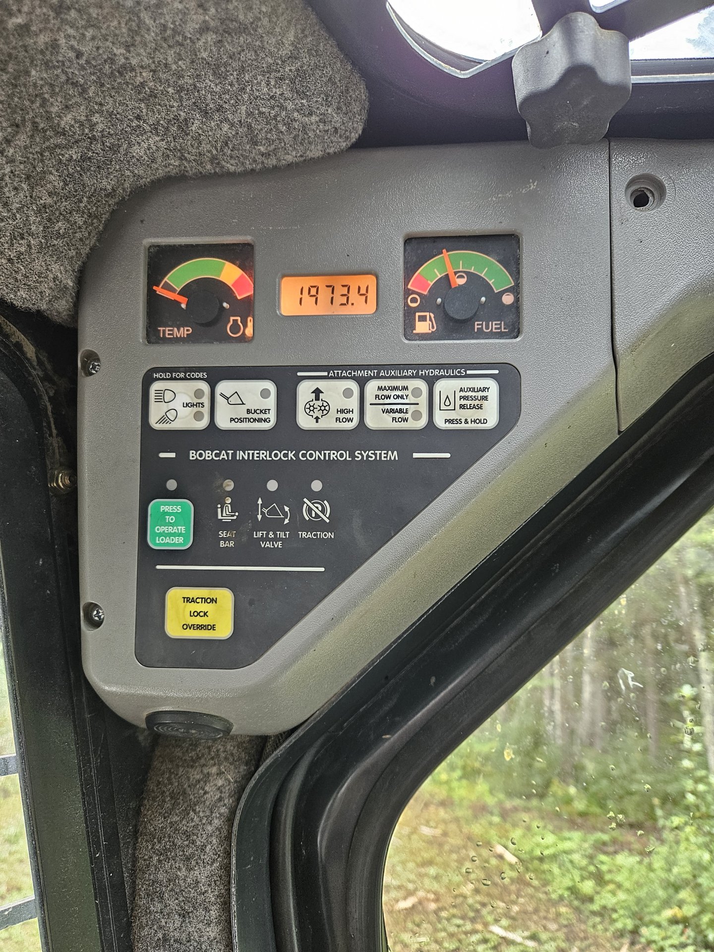

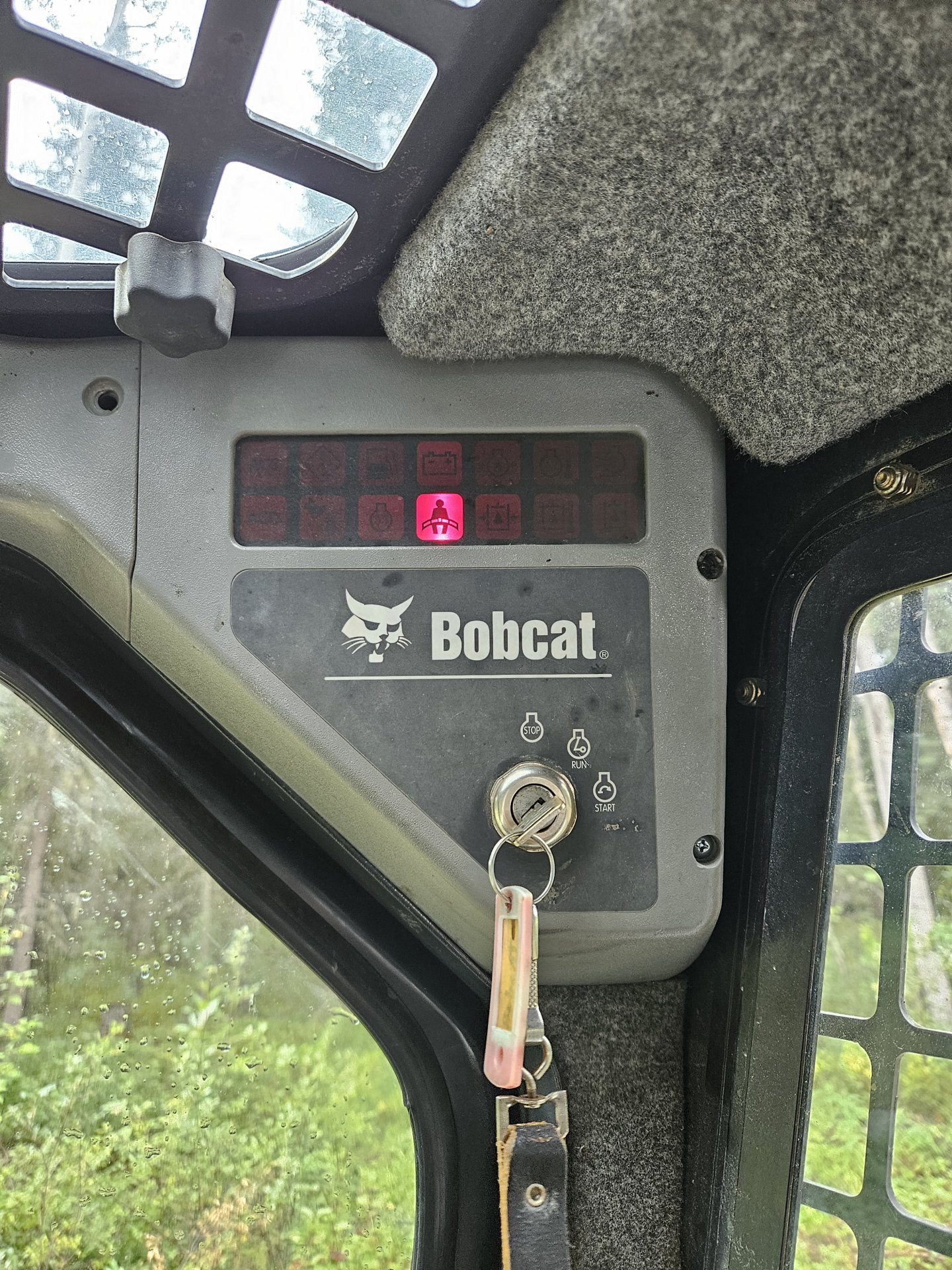

I bought this a few years ago, its always started and ran pretty good. Never had any issues other than self inflicted. A few weeks ago, I moved a trailer with a hitch attachment, put it where it needed to be then ran the bobcat down to where all my attachments are stored to swap it out with a bucket. I started turning to place it, when it gracefully died. It had all the symptoms of running out of fuel. Gauge read about 1/4 th tank, and since I had it nearby, I dropped another 5 gallons in. Same thing, acting fuel starved. opened the fuel drain, there was a little water in it - drained it out, opened the bleeder valve, pumped the siphon till fuel came out and tightened it. Opened the upper ?bleeder? valve at the injector pump, squeezed the buld a few times - didnt see anything, bulb hardened up a bit. Closed the bleeder valve and tried it. nothing. Opened the fuze box, the solenoid relay was 1/2 out of the fitting, pushed it back in - still nothing. Engine turns over fine, a little white smoke, but nothing firing up. Solenoid retracts like it should.
Any ideas of where i should look next?
