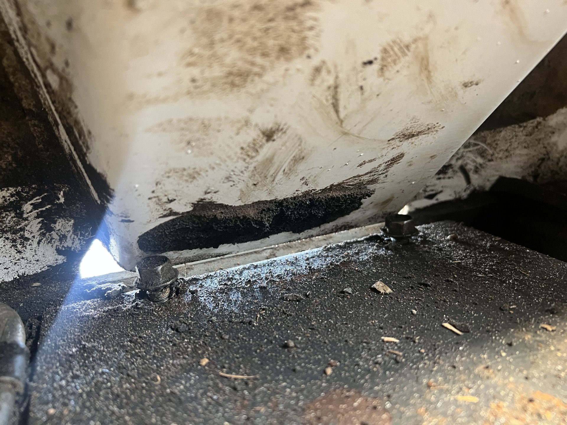

Hey guys,
Got a 2004 S130 with 2700 hours and have just noticed some oil leaking from the front chaincase cover. Have cleaned it and went to remove the cover only to find the gasket is in multiple pieces. My first thought is to remove and replace the gasket but there is no way I can remove the 2 front bolts as they clash with the main frame. Am I missing something? It has obviously been leaking water as the oil is very milky also.
I only see 2 options - Strip the thing down and repair this and a couple other small issues, do some rust repair and repaint (was hoping to do this later in the year anyway), or gasket goo and RTV the cover up, replace the oil and just monitor it...
Any help or advice would be appreciated.

Main problem is removing the two front bolts on the cover plate, Only way i can see to get them out is lift the main frame off the base/chain case frame.
I’m not positive, but if you unscrew the bolts as far as possible, can you slide them out while still in the cover plate? If they are the original bolts they should be tapered at the end. This should allow you to slide the plat a little bit and that should give you a little bit more room to screw them out further and so on.
Just a thought. Otherwise you can always get the hacksaw out.
I’m thinking cutting them too. By the looks of it can you get at them to cut the heads off? If so you could replace them with shorter bolts and cut a slot in the cover from the bolt holes to the end so you could slide the cover into place after laying down a bead of good sealant and tighten it down
