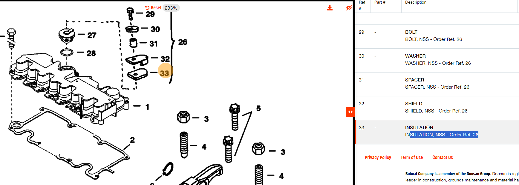

I found the parts diagram. Shows some type of insulation. I have the cover, but no spacer either.
So you are talking about the heat shield. I took a quick look online and I don’t think that part is available anymore. The breather cap itself is still available though.
You should be able fabricate something to replace the heat shield. I’m not sure what type of insulation was used but I’m sure you could find something at an automotive store that would work.
So you are talking about the heat shield. I took a quick look online and I don't think that part is available anymore. The breather cap itself is still available though.
You should be able fabricate something to replace the heat shield. I'm not sure what type of insulation was used but I'm sure you could find something at an automotive store that would work.
