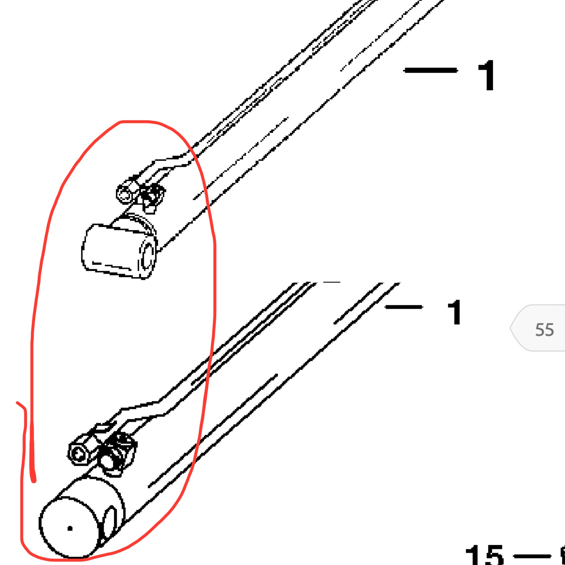

My right lift cylinder is leaking on my 853 where you unscrew the silver part to remove the piston. Went to the online Bobcat Parts Catalog and they show two lift cylinder diagrams and each diagram lists a different part number for the Lift Cylinder Seal Kit. Any idea how I tell which seal kit I need? Thank you

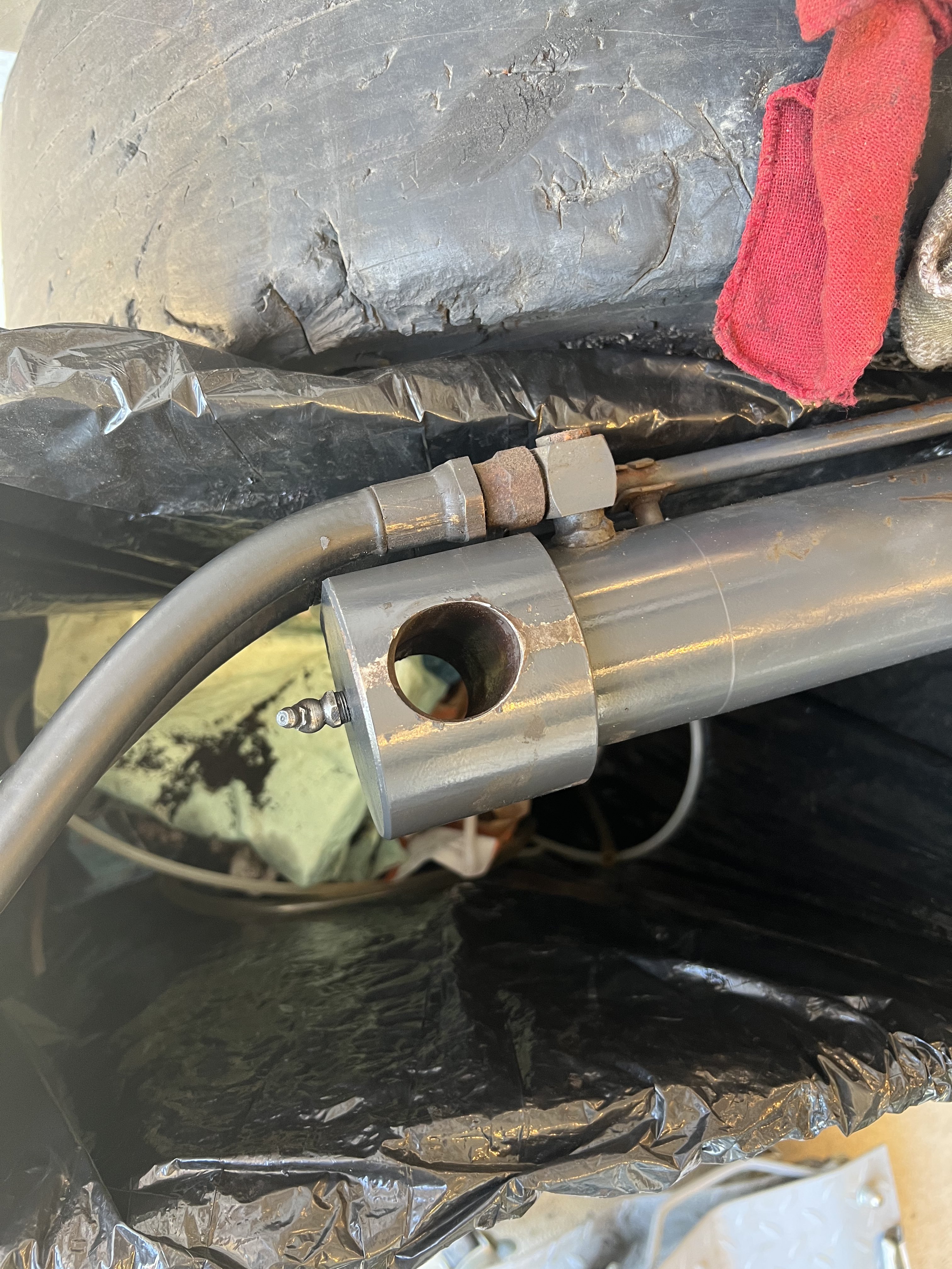

Not sure if you got your answer, but I’m at that same point in my 853 disassembly and was wondering the same question. In looking at the parts catalog, the back end of the two cylinders are different. See pics.
