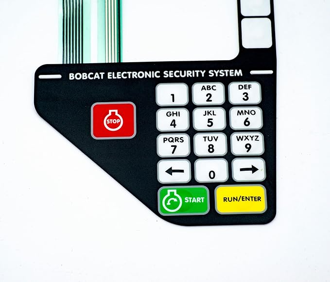

My bobcat 773 is having a "keypad problem". Sometimes the numbers punch through, and sometimes, only some do. The module 6678682, and the pad in it is marked, 03876055, PN: 68695.
I may have ordered the wrong pad, or the pad may not be the problem. The pad I got is 668843 or 6686510 compatible. I put it in, and have virtually the same problem. I have been looking at pads and find one that looks the same, but goes by numbers: 6672348-A, 6678682-A, 6683171-A.
Both keypads are supposed to fit the 773.
Does anyone have some insight into this?
Thanks

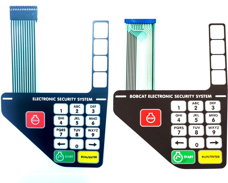

Live and learn:) I do have the wrong key pad:(
When in need of a bobcat key pad it would be wise to pull it apart before ordering. Look at the feed harness' of these two keypads and you will notice one has all wires going straight to the connector and one has them crossed.
