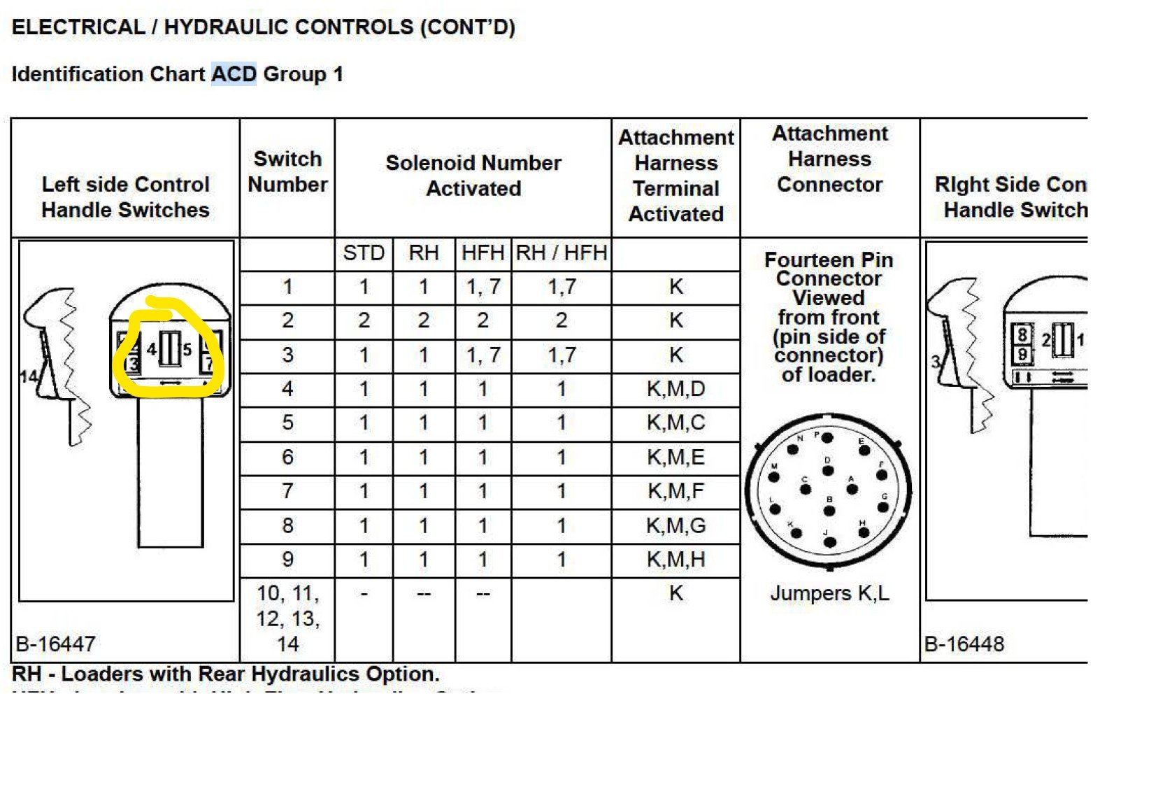

We have a S630 with foot pedals. The joy sticks are only for steering and aux hydraulic. Can this auxiliary hydraulic controller be reprogrammed???
The issue is the Left Joy center R button is activating pin D on the 14pin connector, but the L button activates both C & D. The switches are working fine (one for one) but the aux controller is driving both output when selecting left. I've used a spare controller and it acts the same. None of this coincides with the service manual.
