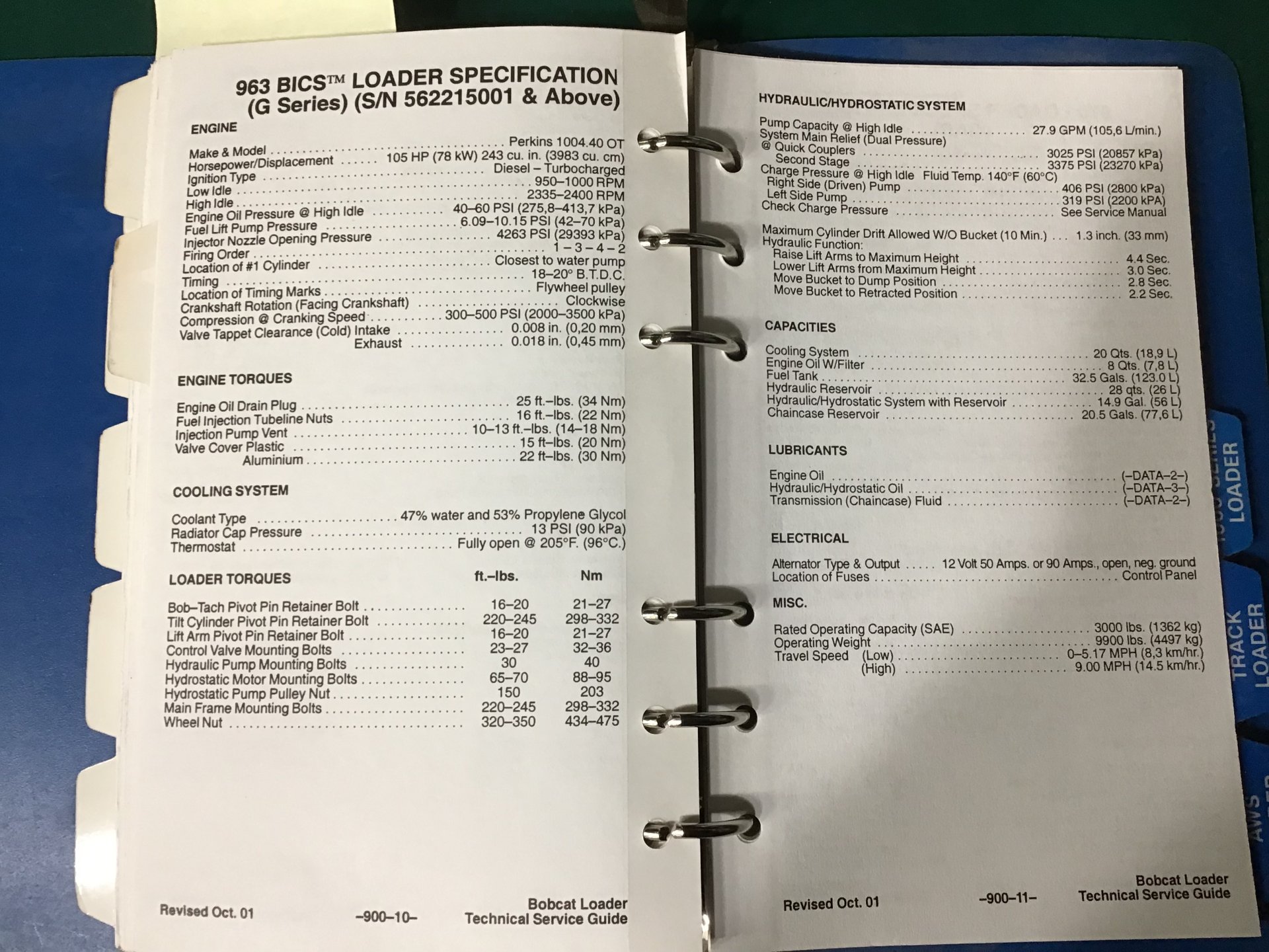

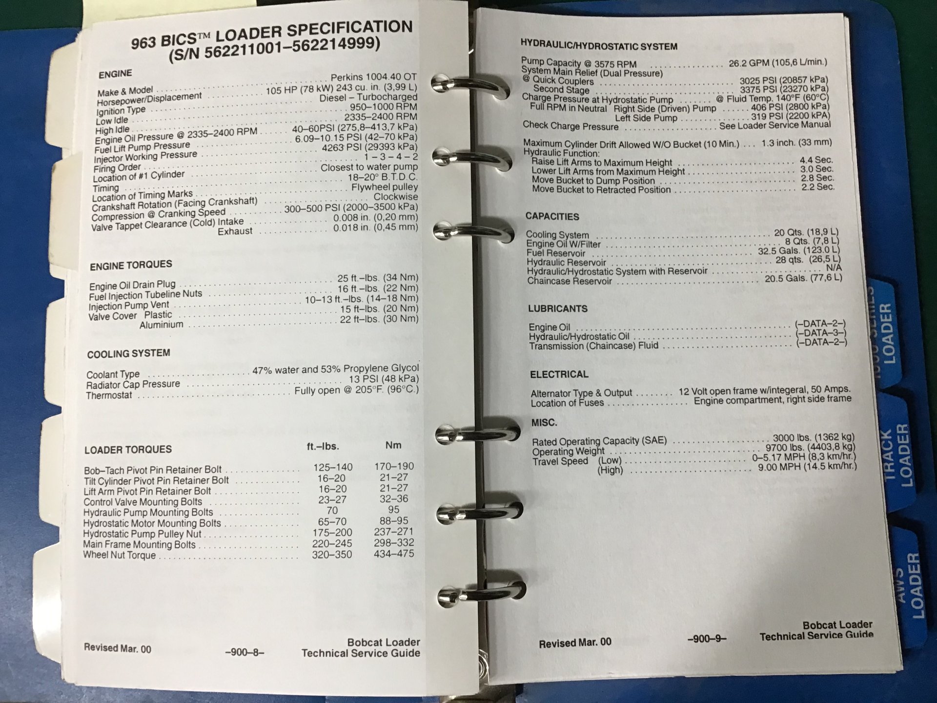

The specs show a high idle of 2335-2400 RPM.
I have included photos of the Technical Service Guide. Make sure to use the one for your SN.
Also, just because the engine is turning at a certain RPM does not mean that the pump is turning at the same RPM. I believe that machine is belt driven and different sized pulleys or drive wheels will cause the pump to turn faster than the engine.
The rating of the 963 is either 26.2 or 27.9 GPM depending on your serial number. So if your engine idle speed is correct then you should get these flows unless your pump is worn out.
