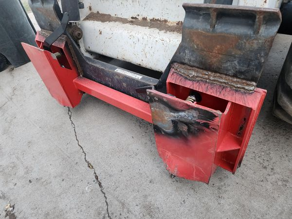

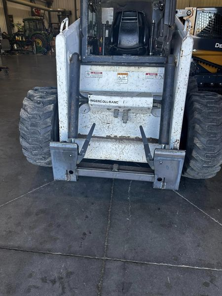

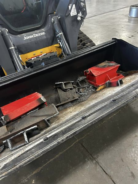

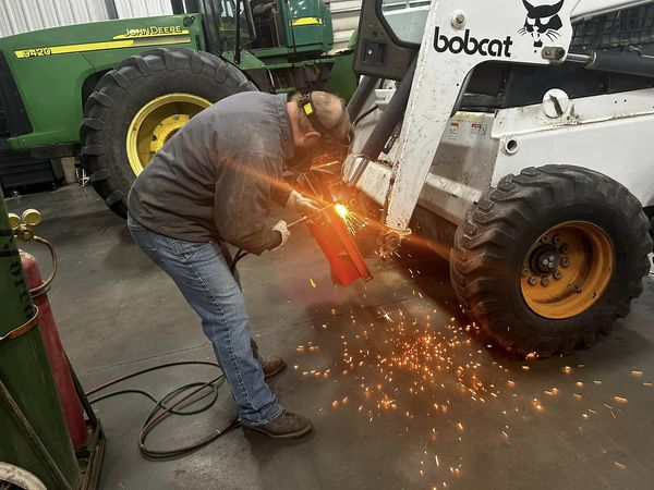

For any of you that are looking for a universal SSQA adapter......those "universal" adapters on Ebay that are 200-300 bucks are absolute garbage. We found out the hard way. We finally had the time to do ours correctly so we cut off the original bobtach, and that cheap SSQA, and replaced it with the universal unit from River Valley Machine. They build a VERY nice QA, and it took a lot of work to fab it onto our 953, but it's solid and works well.
