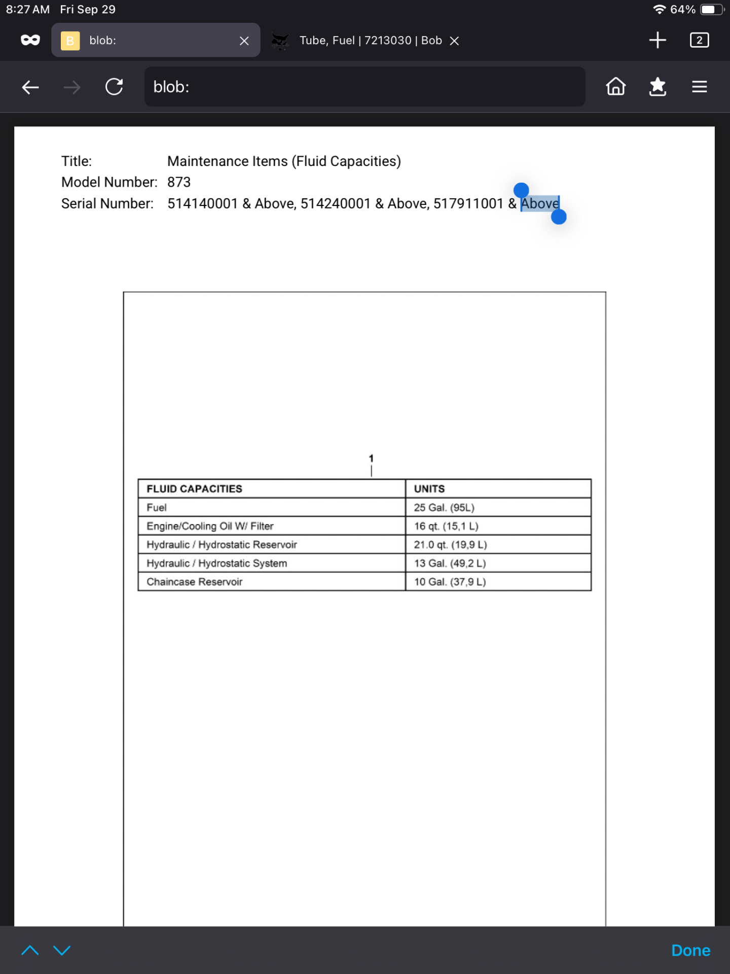

You should be able to look up the total oil capacity in the specs of your specific machine. Then just measure what comes out and compare.
You can look these up in the parts catalog.
https://partscatalog.bobcat.com/
I have attached a photo of some of the specs but you should check with your serial number.
    255.2 KB
