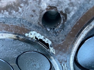

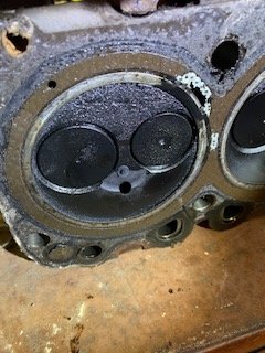

I attempted to do a compression test and broke off two glow plugs when trying to remove. In the process of removing them we lost one of the electrodes down into the cylinder and had to pull the head. Pulled the head and found a blown head gasket. See pictures. I though Duetz used 3 layer metal head gaskets. This one isn't. As I have said before I know the original owner all my life. He swears the head was never touched. He couldn't confirm if Bobcat touched it without him knowing. When we purchased it they ran it through their shop and said that an oring on the dipstick caused the oil loss (1 gallon/hour). Some shenanigans somewhere. We damaged the sealing point for the glow plugs in two holes. For now I'm going to plug them with bolts and crush washers. I just want to verify that this solves the problem. I'll buy or repair the head later if this solves the original problem.

I believe all the Deutz engines we build run composite head gaskets, so i wouldn't be surprised that a composite one came off, glad you found the issue though.
If you seal off the glow plug holes, please remember you really want to seal the entire hole and even have some sticking out the end, every bit of space you take up with the plug or bolt, takes up compression room, even altering this slightly will effect combustion. I suggest you get new glow plugs and seal them the best you can. You may be able to re-cut eh sealing face with a long end mill that will cut the shoulder for you.
