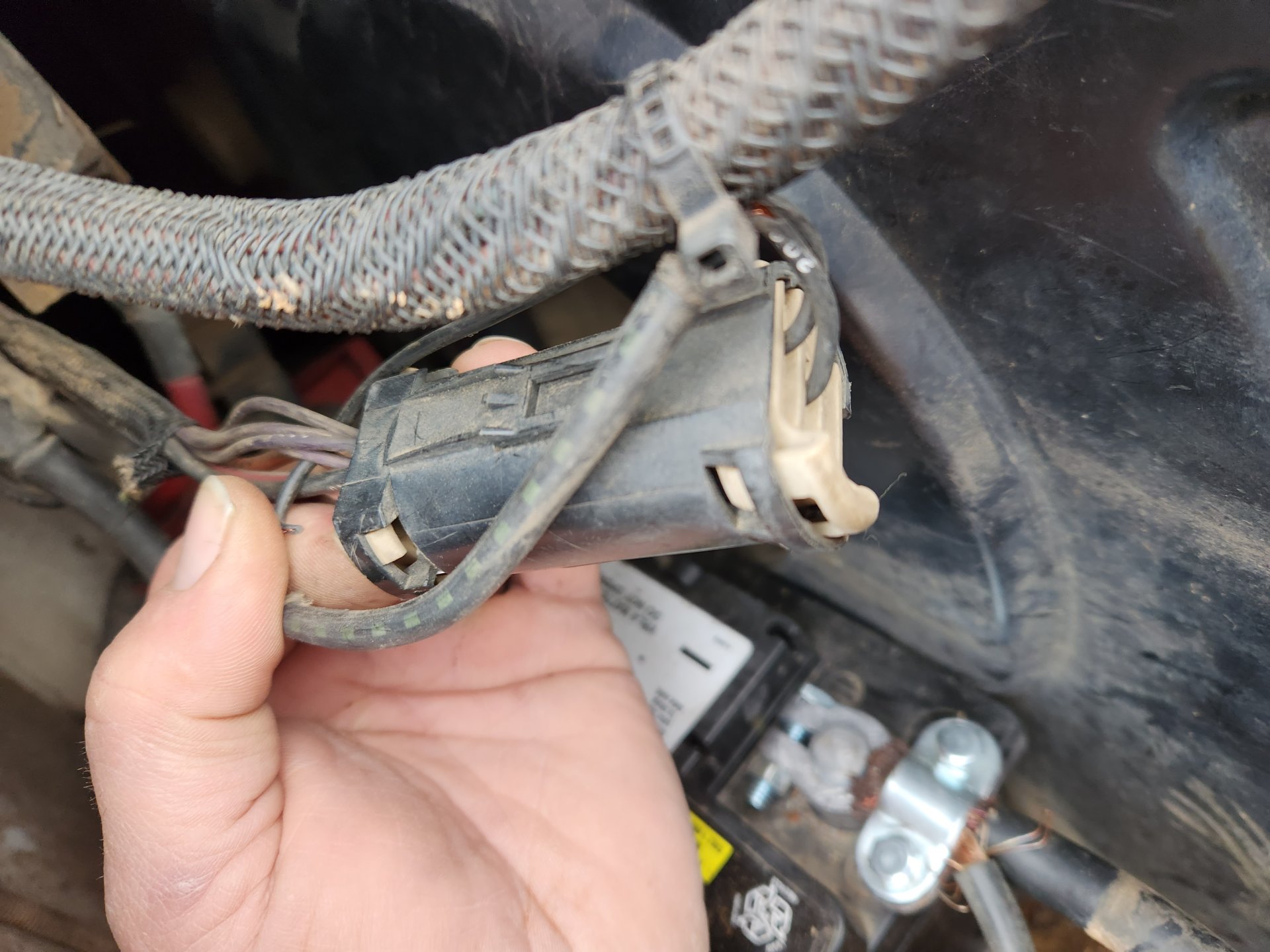

I found this plug that looks like it has a fuseable link in it an the wire just loops back into the plug I tested it for continuity an it doesn't have any from the fuse link I jumped a wire to it but still nothing
