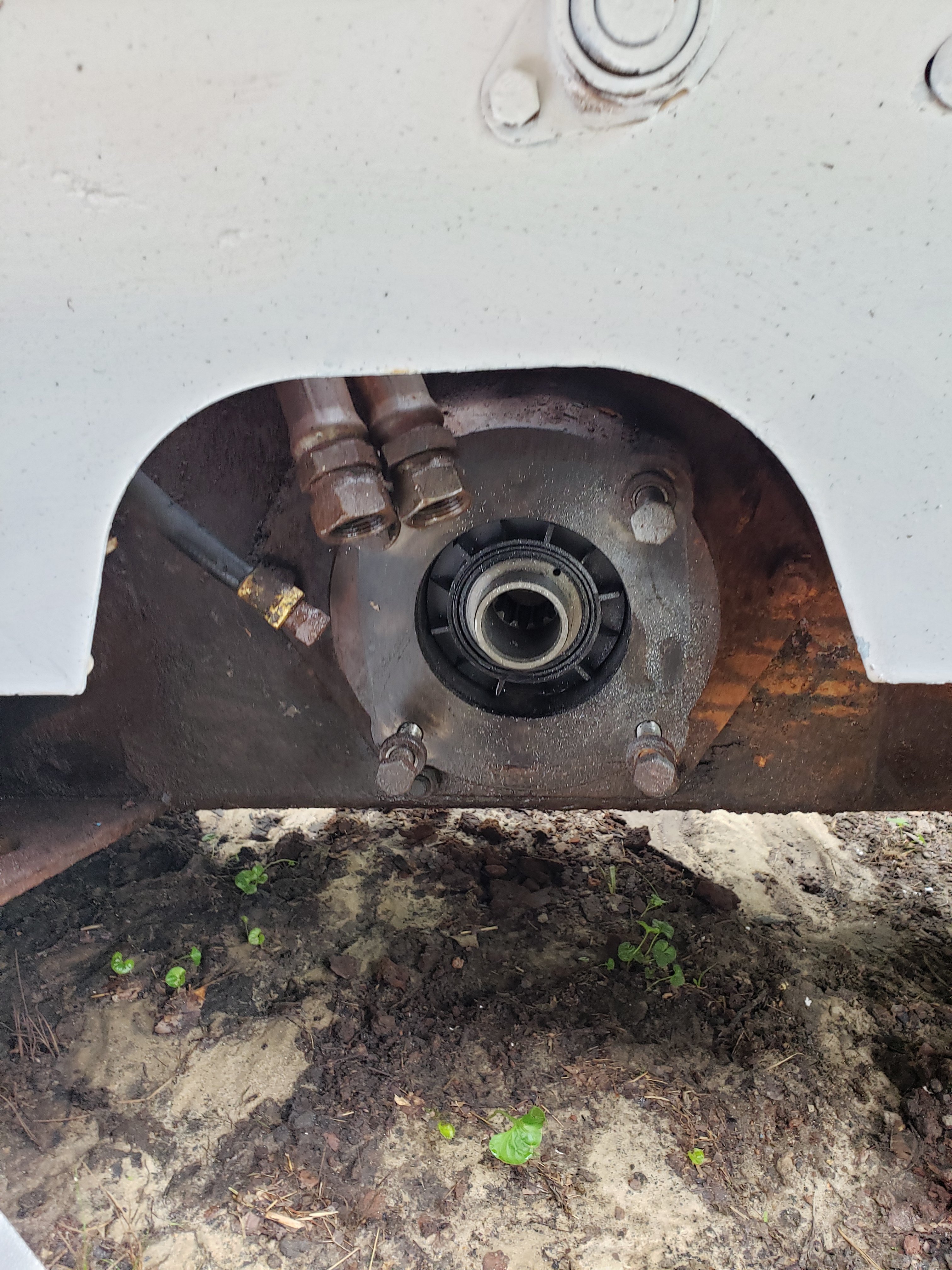

We just replaced the seals on our 743b. Easy to do , hard to get. Put all new lines on too
    1.8 MB
