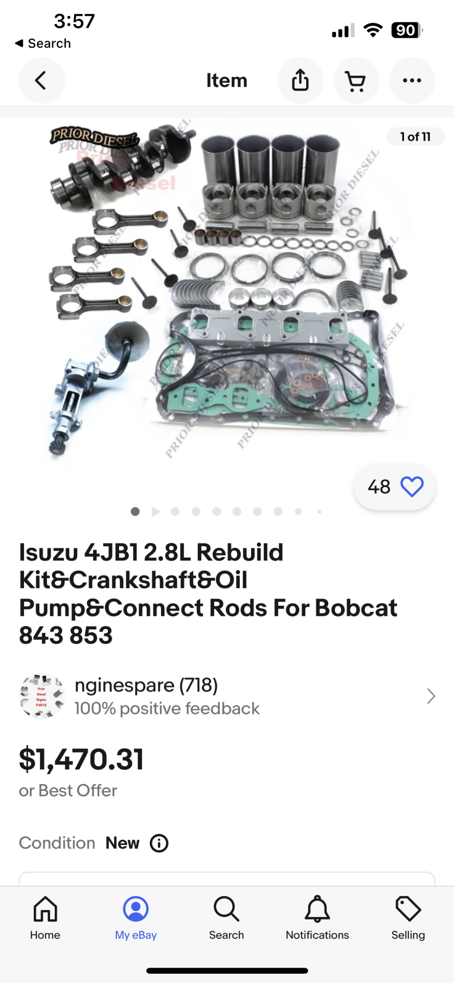

I ordered the below rebuild kit and added crankshaft, camshaft, tappets, push rods,
Rocker Arm Assy', and the camshaft thrust plate. Everything but the head and the block essentially.
The parts looked to be good quality, but I have yet to fire it up given the rest of the reassembly I’m working on. That, plus it’s 107° in Texas right now.

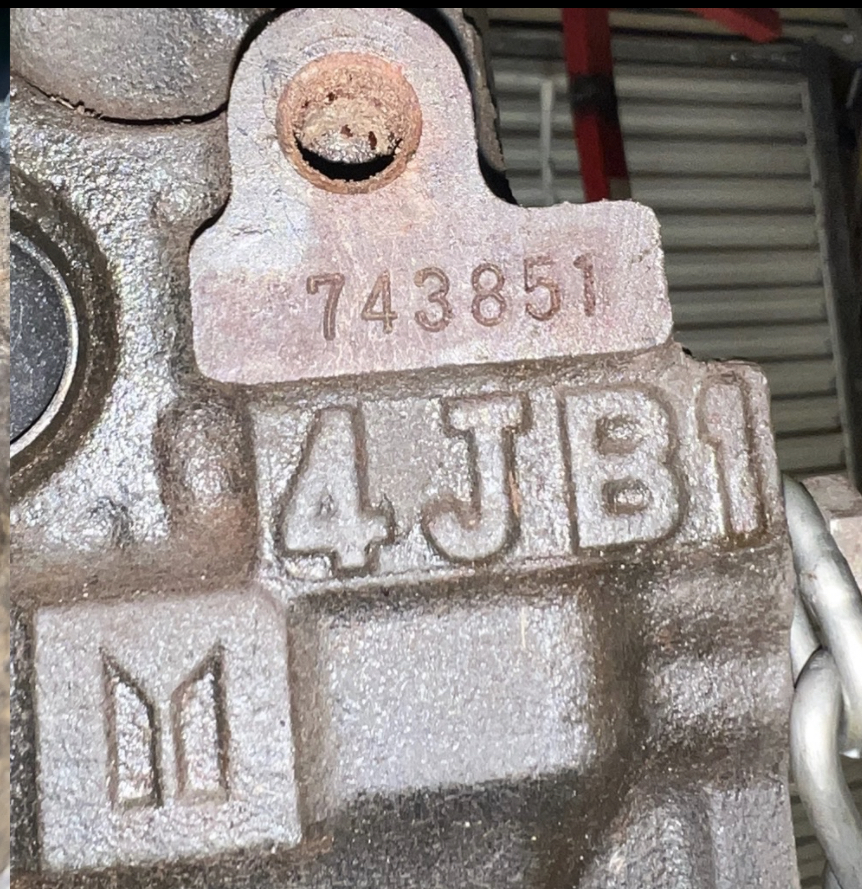

I guess my problem has been that my engine serial number is 690522 which according the experts is not a 4JB1 engine

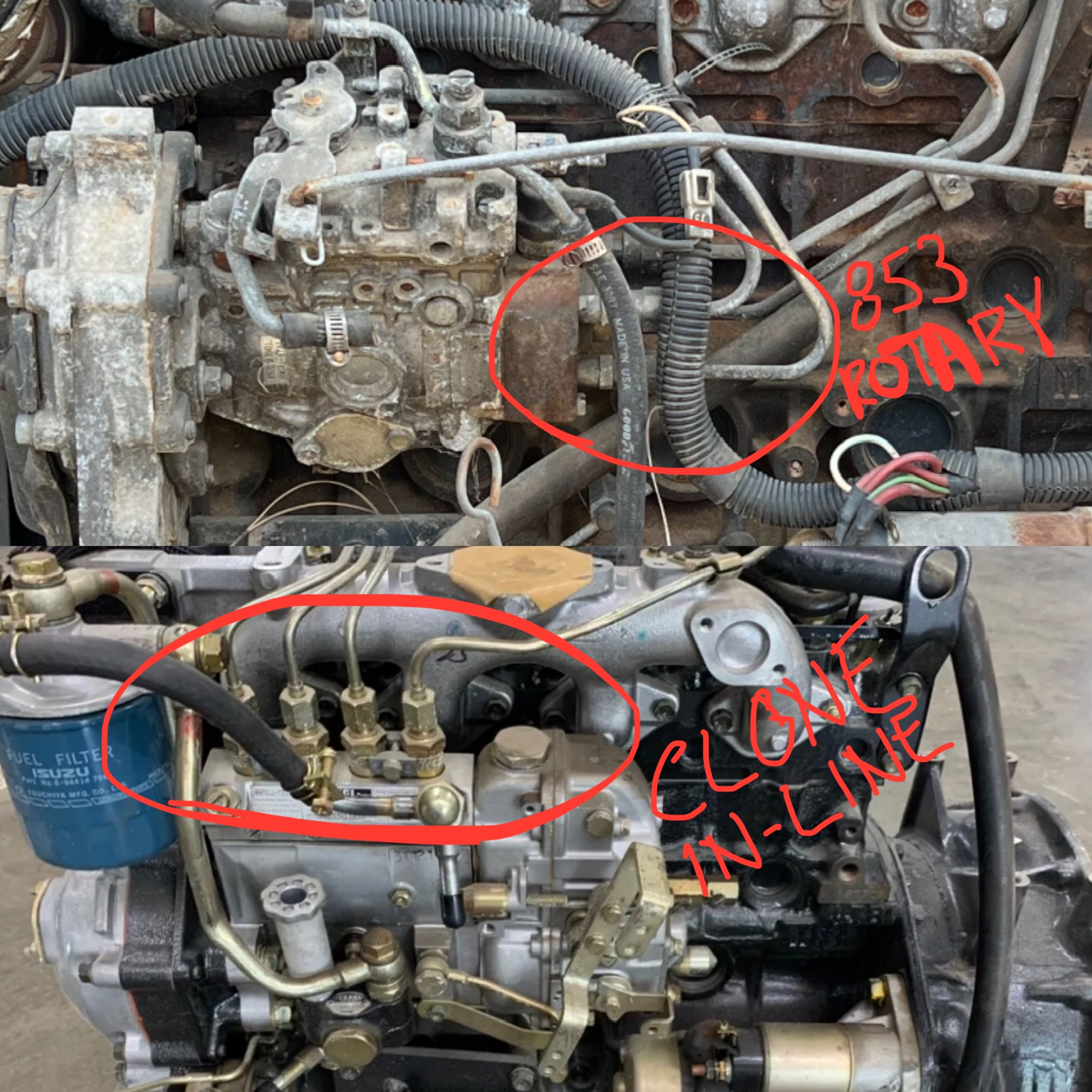

Does your engine have the Isuzu logo and 4JB1 as part of the casting of the engine block? See pic for my engine. If it does, then, duh, tell the experts that it’s a 4JB1. If it doesn’t, then a prior owner rebuilt it at some point with a new block, or put in a replacement clone. That would explain why the experts are telling you it’s not original. Also, a lot of the clones have in-line fuel injectors. The 853 4JB1 came with a rotary injector. I’m wondering if that why your injector lines didn’t fit?
Yes, my engine model number and serial number placement is the same as yours. Right in the casting. It appears I have the rotary injector system. I purchased the machine brand new so there have been no engine replacements.

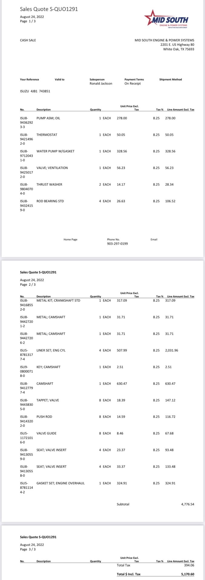

I did find one Isuzu dealer that sent me a parts quote, below. That’s the belt and suspenders way, to be sure, but at $5,100 for parts alone, it did not make economic sense.
