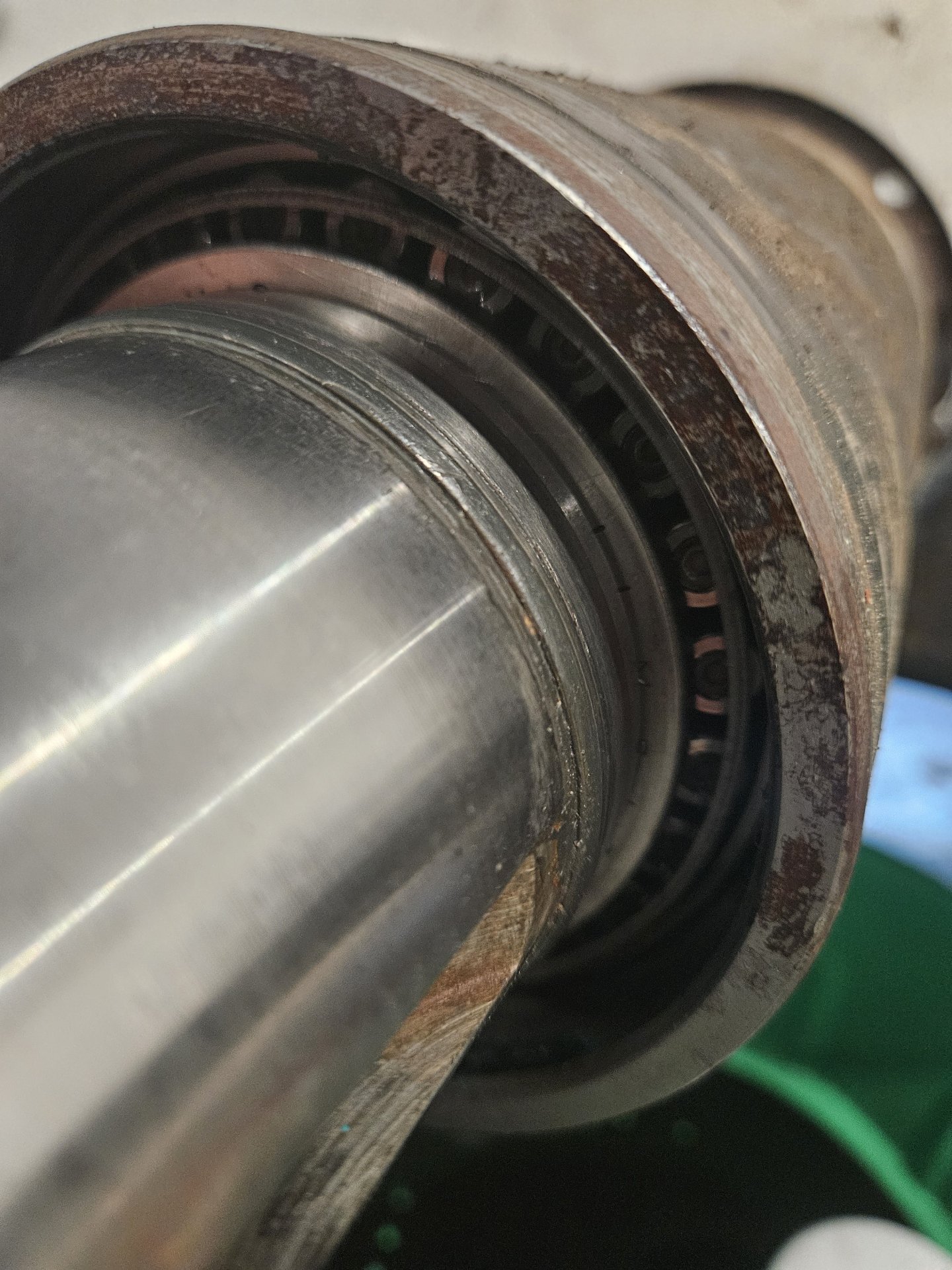

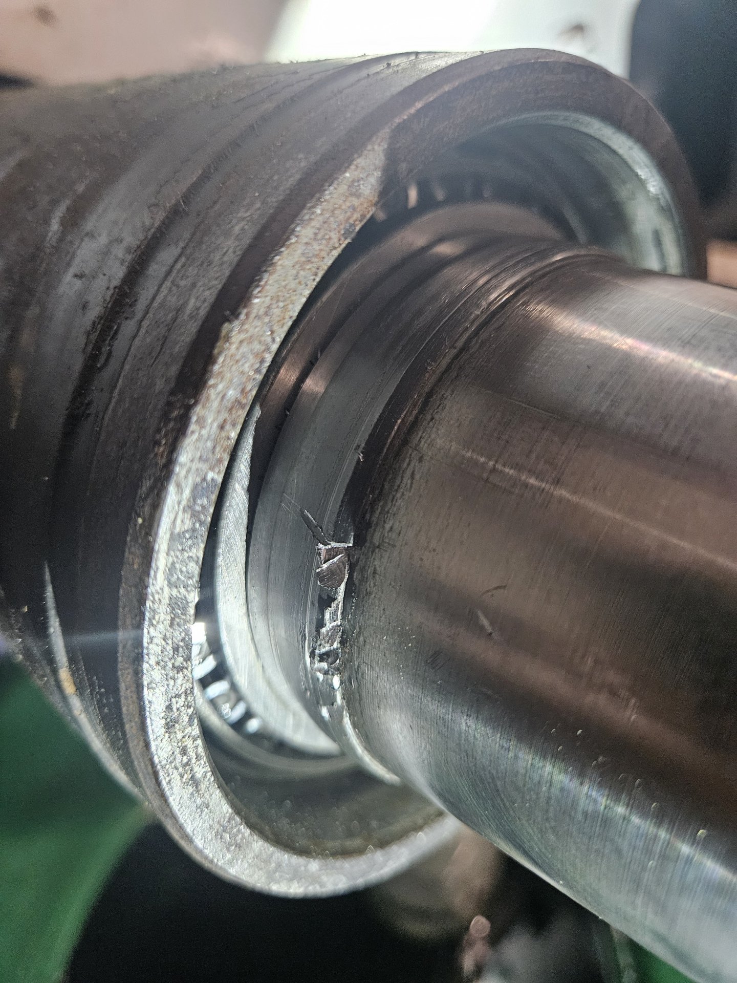

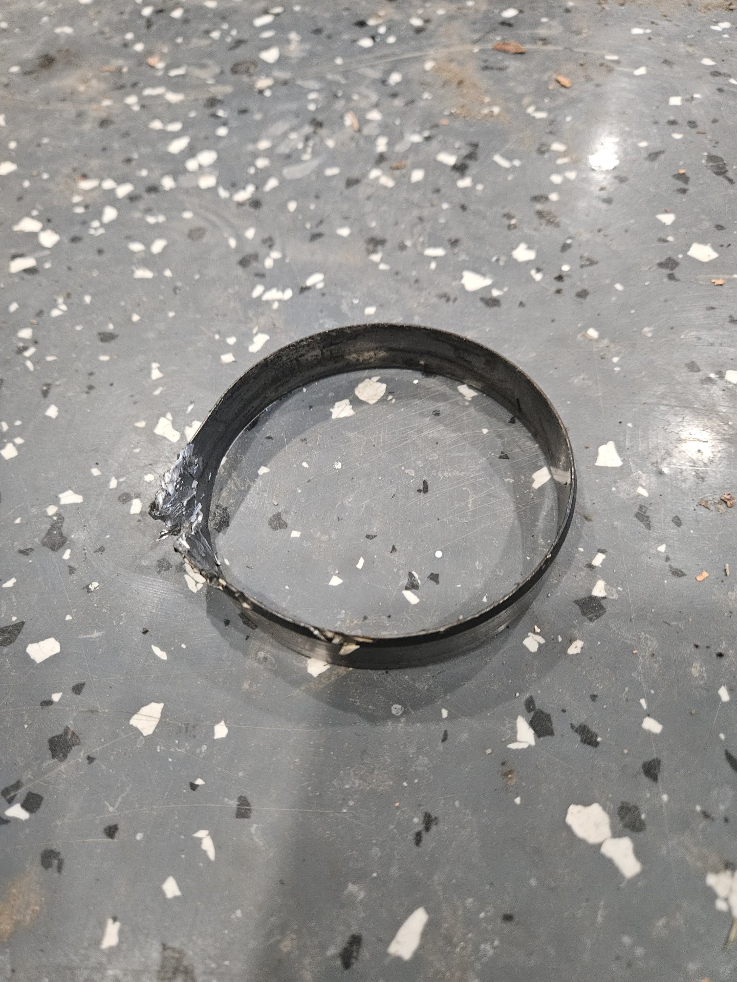

Hello,
So my axle seal is leaking badly. I removed the hub and pulled the old seal. The service manual talks of a wear ring and the parts manual shows one as removable.
I got a new seal and ring from bobcat dealer with my serial number. However I tried to chisel it a bit and wondering if this ring does in fact remove before I do some serious damage. Thought I'd ask before I proceed any further .pics below.
