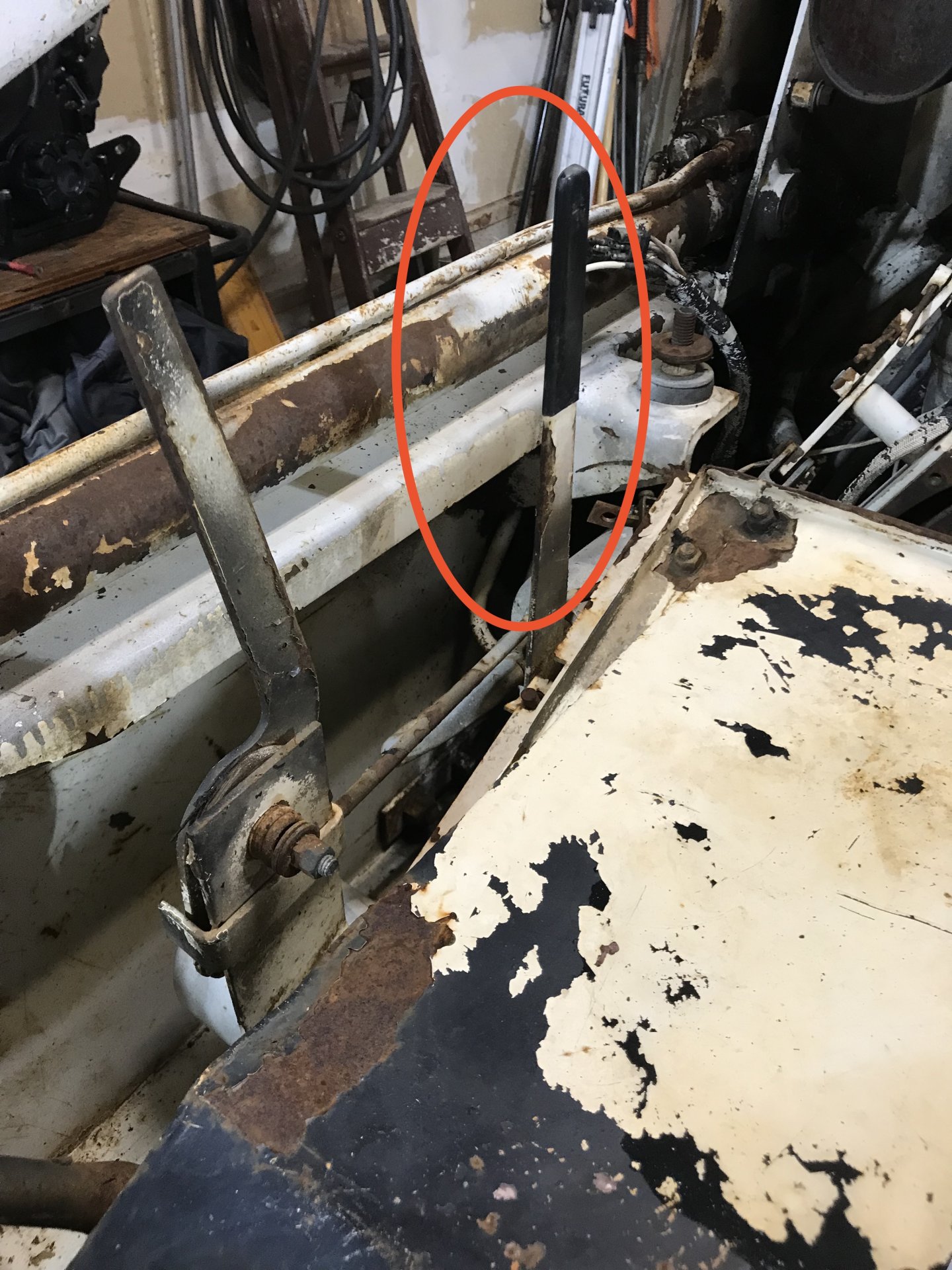

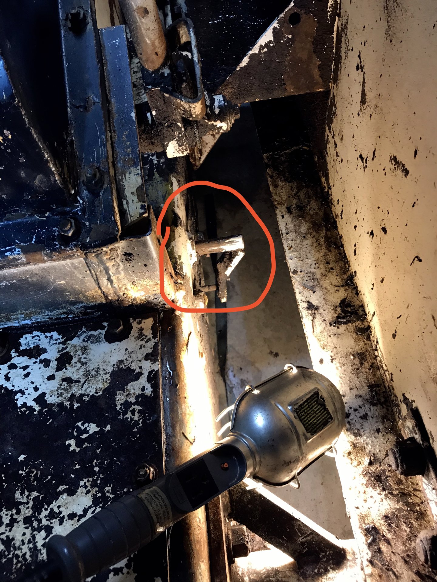

i am new to this machine and would like to know what these two controls are circled in red. The first one has the same "piston" that can can be locked out with a nut on both sides of the machine. It goes directly into the side of the hydraulic case. Second photo looks to be maybe a two speed control? or parking brake? it is located right behind the throttle control shown in the photo. Thanks for any help with this.

there is the same type of lever on both sides of the machine.
The first photo is definitely one of the shafts that will disengage the drive gear. Undo the retaining nut and pull the shaft out about 4 inches. Right side is near the rear axle and left side is near the forward axle.
