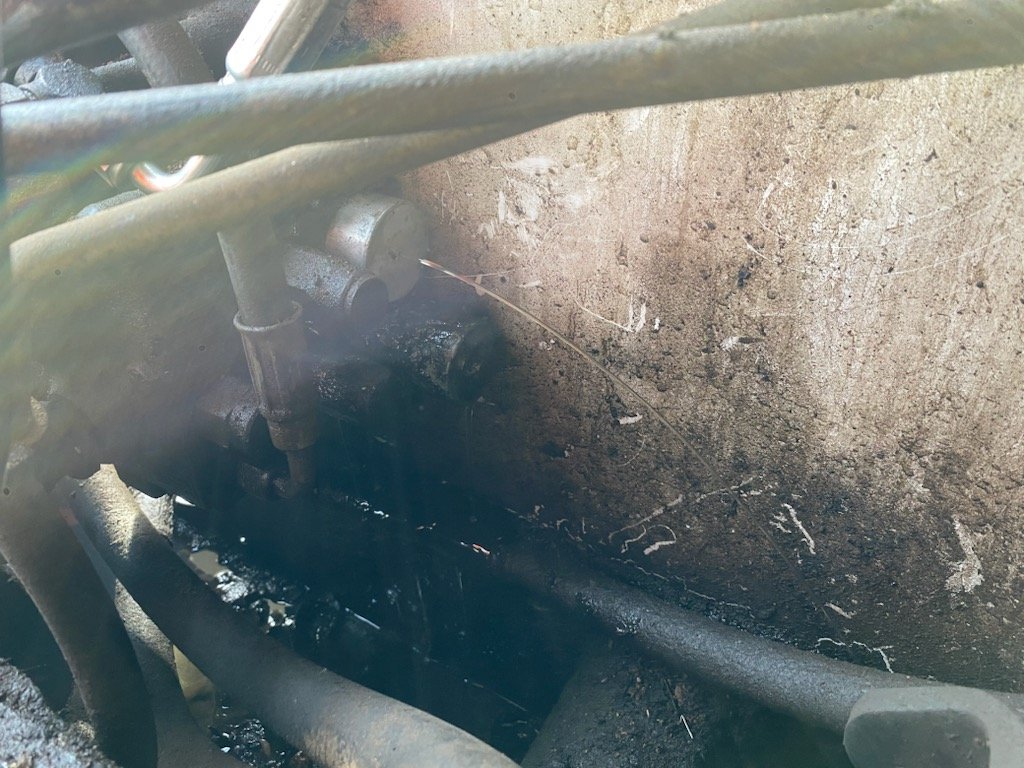

hydraulic fluid squirting from the cylinder on the control valve as shown in pucture?
I have not worked on the control valve before. What should I do?

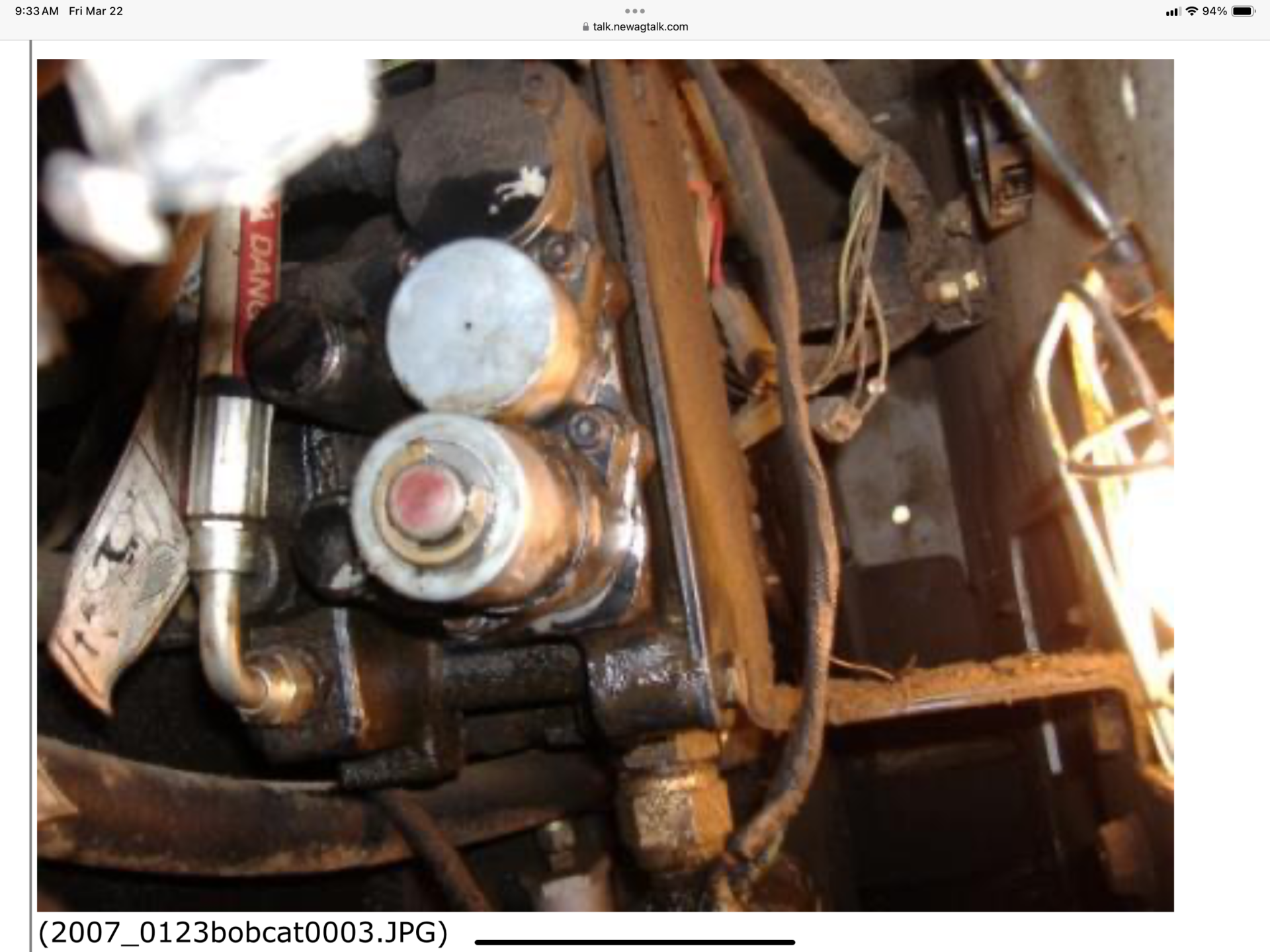

I found thus close up picture online . This shows a close up of the silver cylinder with the pin hole in it. Fluid is squirting out of this pin hole. What is this part?
    1.8 MB
Upon further research it looks like the seal on the spool needs replacing. Fluid is leaking out of the weep hole.
Timing is everything. I just repaired my tilt and lift spools on my 863 and made a youtube video on the repair. Your leak appears to be from the tilt spool. Repair both of them. As said above, the Bobcat parts catalog is an excellent source. Attached below is my video...
