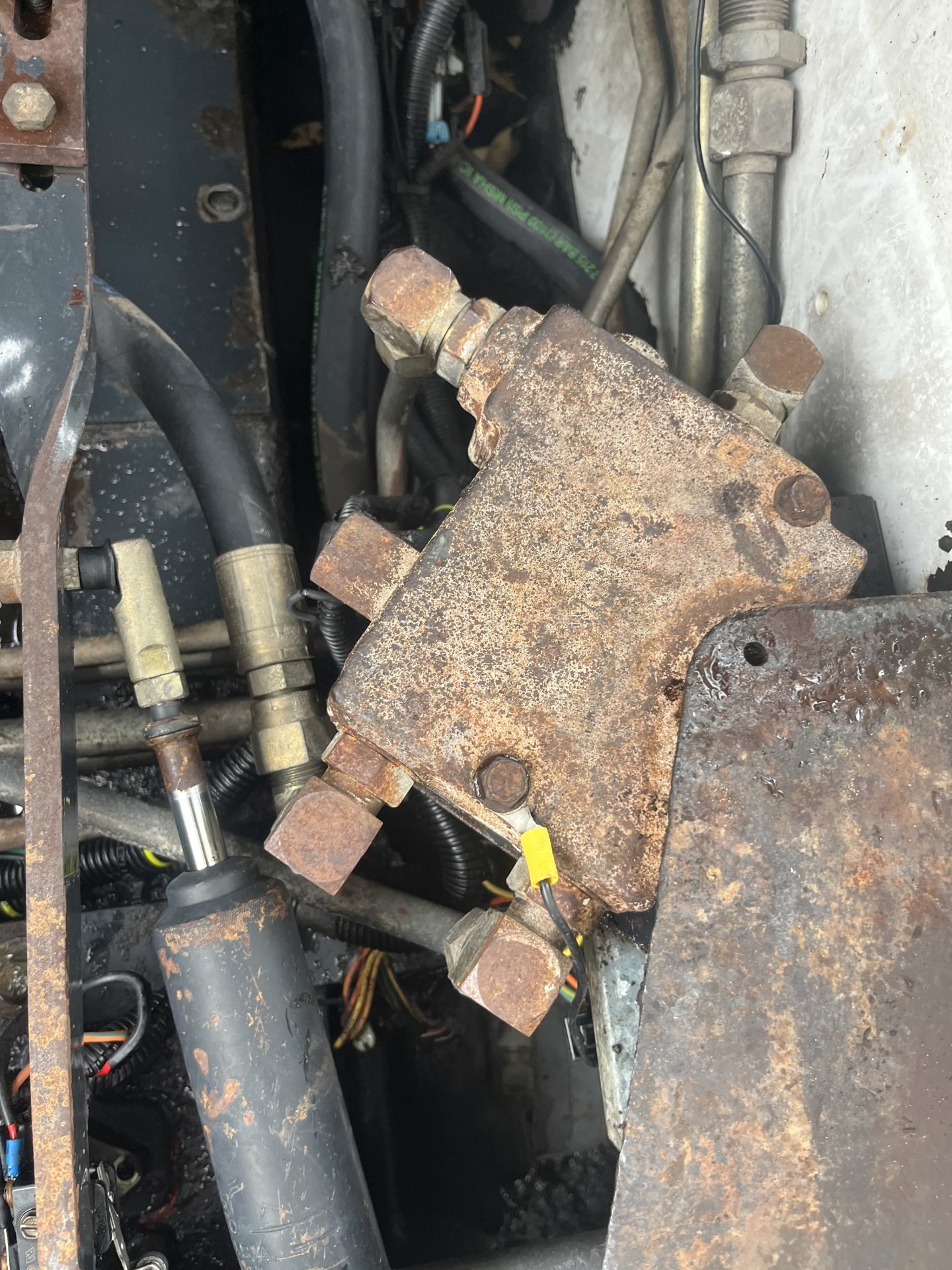

Gday guys have a bobcat 763 that has a puddle of oil in the bottom and is loosing hydraulic oil it is coming from the left hand side as you are sitting in the machine hard to see it leaking from any where are there any common leaks with these. Checked all lines and they are all tight can’t see any cracks or anything obvious could it be coming from the bank in the photo as it is wet under that

Did you ever find that leak? I have a leak in that same area. could be one of the many connections to the distribution box thats in the picture. Does anyone know the exact name of that part? and if its o ring boss or JIC fittings?
